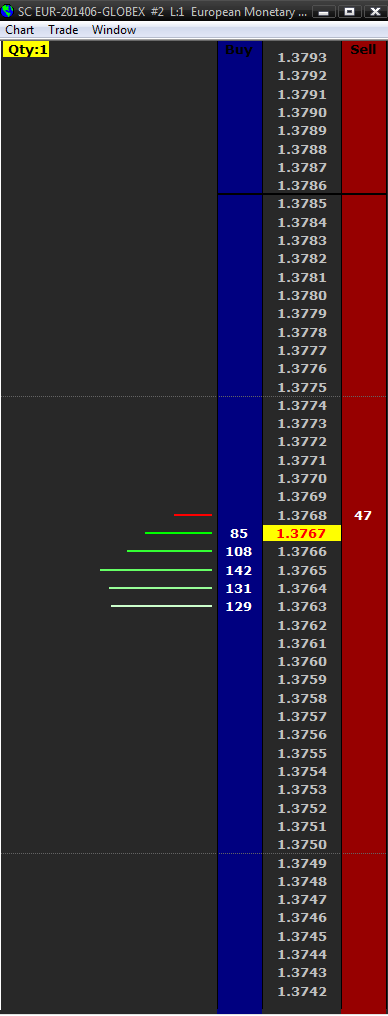

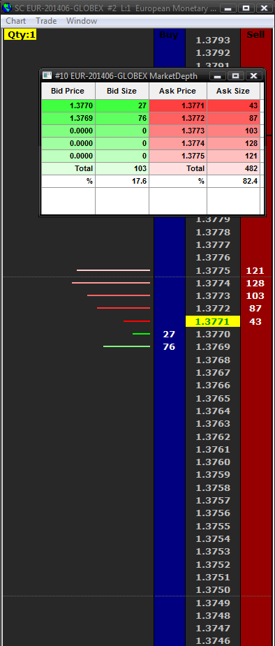

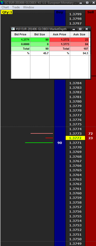

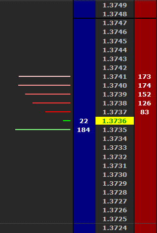

User30668 - Posts: 108
SC Engineering,
I have been experiencing a problem with market depth, when using IB data feed and live trading account.
The problem is that SC is very frequently and momentarily missing some of the levels of the market depth. They then come back and disappear again, flashing back and forth. It happens in both Trade Dom and Market Depth window.
At first I obviously thought that the problem was coming from IB's data feed but after some tests that doesn't seem to be the origin of the problem.
Thus, I am going to try and explain here as thoroughly as possible the conclusion of my testing:
- The instrument I notice the problem more is Euro Futures;
- The problem is more noticeable when there are some trade flow (not need much);
- It just happens with IB's live account and doesn't happen with IB’s paper account – this is strange for me as the data feed is supposedly the same;
- And, as a final test, with all connected at the same time to IB's data feed, I tested SC Trade Dom and SC Market Depth window, side by side with TWS Dom (Book Trader) and Ninja Trader Dom – Both Tws Book Trader and NT Dom are showing the market depth normally while SC is showing the described problem.
This is an important issue for me because I need to use IB’s T&S data in my charts and need as well to have the Trade Dom in the same instance to be able to see the orders in those charts.
Would you please take a look at this issue?
Thanks.

[2014-04-03 17:16:01]
We see your Sierra Chart account has activated the Sierra Chart Real-time and Historical Exchange Data Feed. Are you using this data feed?
[2014-04-03 19:14:44]

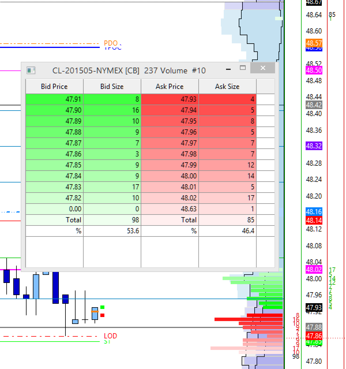

1117 Release Date: 2014-04-07
Solved an IB market depth problem which occurs when prices have a large number of decimal places.
I am very sorry to bring bad news but this market depth problem is still occurring.
I have installed version 1117 today and despite today's very slow price action the issue showed frequently. It is however much easier to see the problem when the market flow is faster.
Please try to fix it when possible, ok?
Thanks.

[2014-04-07 17:40:46]
We are not able to test this because we do not get any market depth data on the test account we use.
The problem most likely is occurring because of the clearing of Market Depth prices which are out of order to solve a problem we have seen with that in the past with Interactive Brokers. We have removed this automatic clearing of out of order depth levels.
So this should resolve the problem, but if there is any problem with out of order market depth prices, it is not our issue and we will spend no further time on this.
This will be out in the next release.

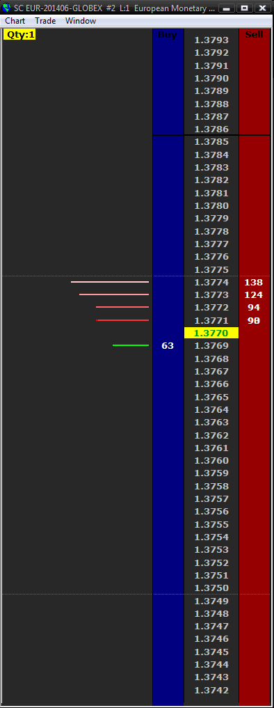

Here's another example DOM that's busted due to these ordering issues with how the code is handling it....
Date Time Of Last Edit: 2015-03-31 03:08:14
imagesc_busted_dom_cl.png / V - Attached On 2015-03-31 02:13:36 UTC - Size: 90.39 KB - 482 views
