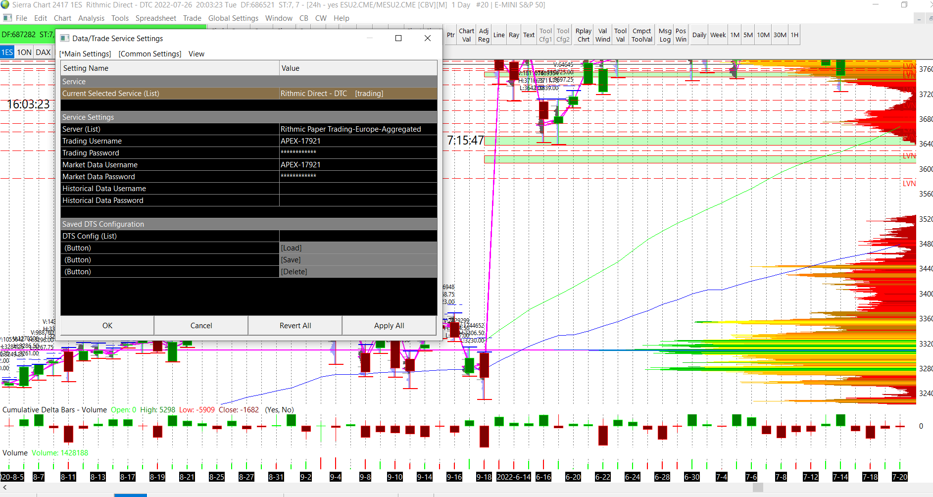

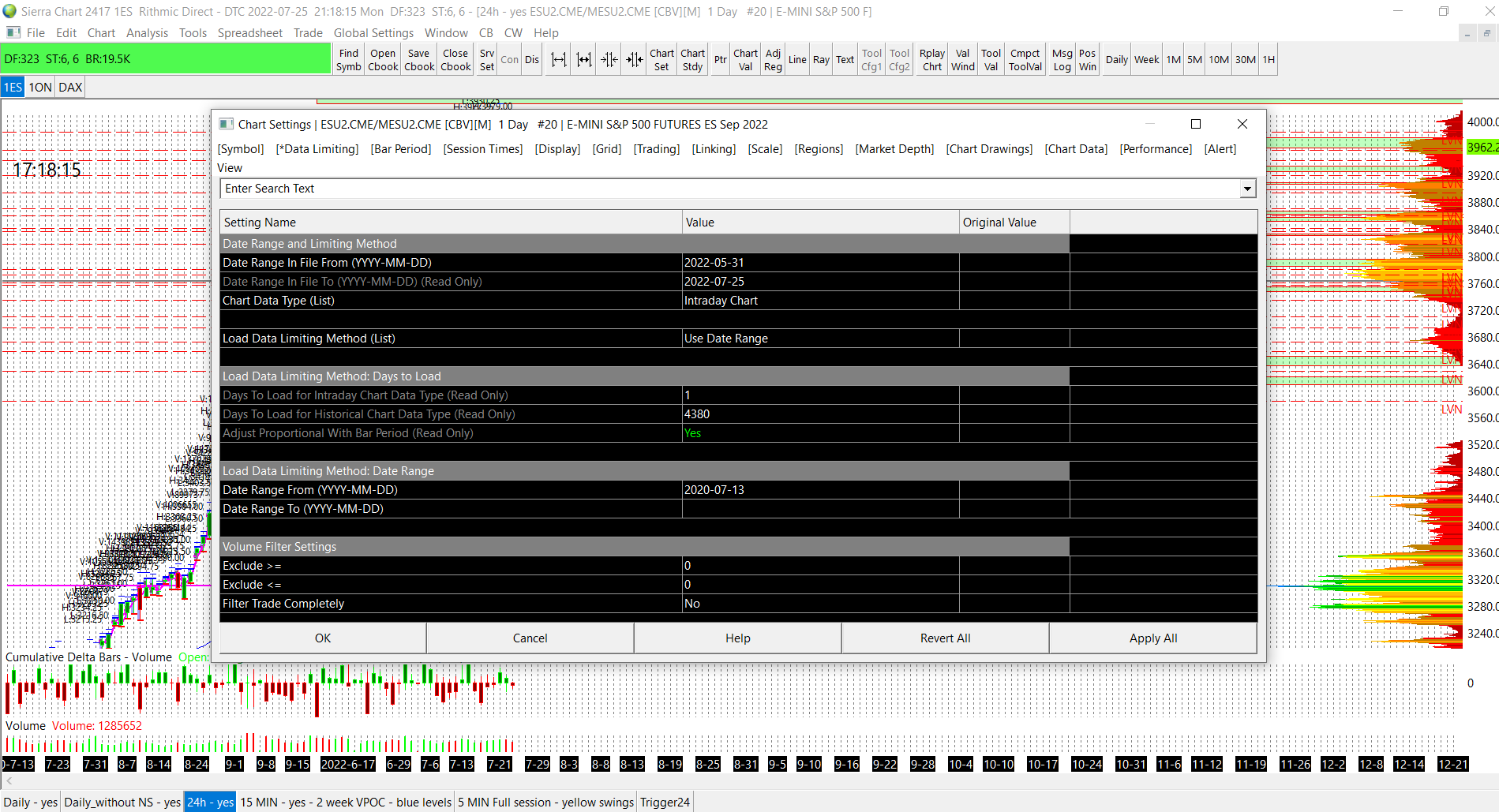

Last but not least, when my charts reloaded connecting to rithmic data one chart should display the data from 2020-07-13 (starting value for date range). However, and here I attached a screenshot, there is a gap between 2020-9-17 and 2022-6-13. Is this due to faulty rithmic data? I could I correct that?

Rithmic data only has a limited amount of historical data (about 5 days). Therefore, if you need data from more than 5 days prior, then you will not get that data from Rithmic. Refer to the information here:

Before switching to Apex and Rithmic I had IB as a trading service. My understanding is that here I had Denali for Data. All data was perfect. Now as seen in the screenshot I needed to select rithmic and my username and PW for trading AND DATA. As you can see in the screenshot as well I am missing a lot of data points. Hence, my assumption is that data is not provided my Denali but by Rithmic.
I still dont understand how i can use Denali data again. I trade the ES and the MES exclusively. When I disconnect and then reconnect to data services it´s just giving me the data that has the missing data points as shown in the screenshot.

John - SC Support - Posts: 48095
Keep in mind that Sierra Chart is setup to look to get the data from us first, and then, if you are not setup to get it from us, to look to your trading service for the data.
In your case, you are setup properly to get the data from our Denali feed. And the data in the chart that you show is from our Denali feed, as we see the notation [M] after the symbol in the program header.
If you are missing any data, then follow the instructions at the following link to redownload any missing data:
Or, you can delete and download specific contracts by following the instructions at the following link:
Again, you are setup to get the Denali data because the last time you connected to your IB account, it validated you through August 18, 2022. You can view the verification date at the following link:
https://www.sierrachart.com/UserControlPanel.php?page=DenaliDataFeed#Exchanges
As mentioned above, if you are going to continue to trade with IB separately, then you will need a second installation, and that verification date will automatically shift each time you connect.
But, if you are not going to trade the IB account very much right now (but you still have the account), then as August 18, 2022 approaches, you will need to connect your Sierra Chart software to your IB account in order to verify your status as a non-professional in order to continue to get the CME Group data at the non-professional rate. This is something you will need to do at least once a month to continue to verify your account. Refer to the instructions here:

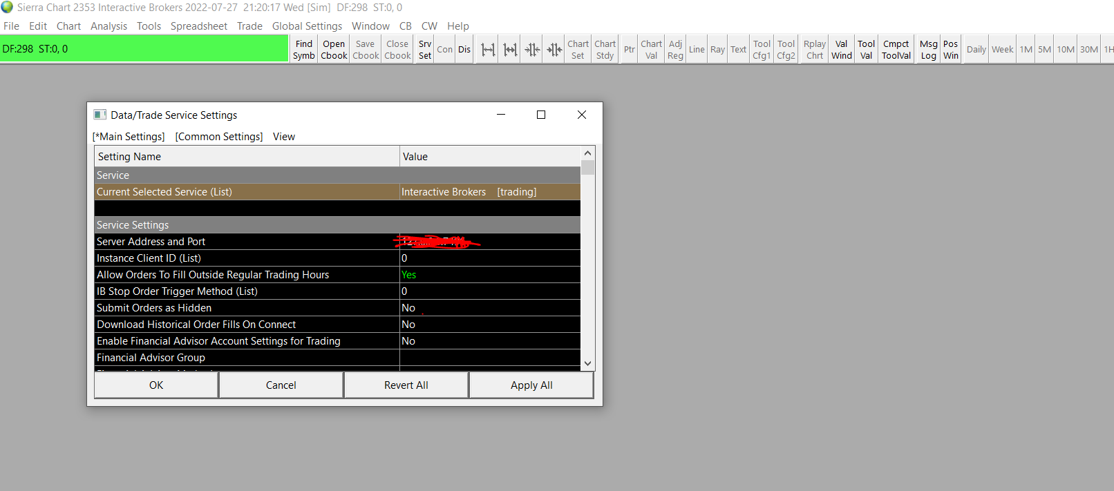

so I think I managed to install the second instance and connect to IB (see screenshot). can you check on your side if i did it correctly and that you have me now registered with a second account so the issue is solved? do I still need to log in with this second SC instance once a month or is it redundant?

The information you show in the attached image looks correct, but we are not showing a connection to IB yet. Is the IB software running on that computer to connect to it? Make sure you go through all the instructions for that installation to connect to IB. You will find the instructions here:
Interactive Brokers Trading Service: Setup Instructions
If you are not starting the installation of Sierra Chart that connects to IB every day, then you will need to start it and make the connection at least once a month. You can view the verification date for your account at the following link, which, if it is set to 30 days forward, then you made a proper connection:
