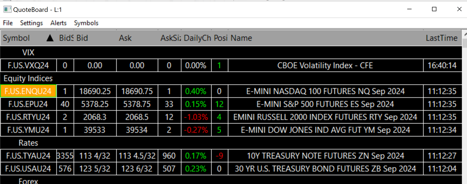

|   [2024-08-12 16:15:49]     |
| joefennessey - Posts: 40 |
                Hi, Please find a screenshot attached where the other data feeds are running properly but the VIX has not updated since yesterday evening at 4:40pm CT. This has been occurring daily for several weeks now. Best, Michael  |

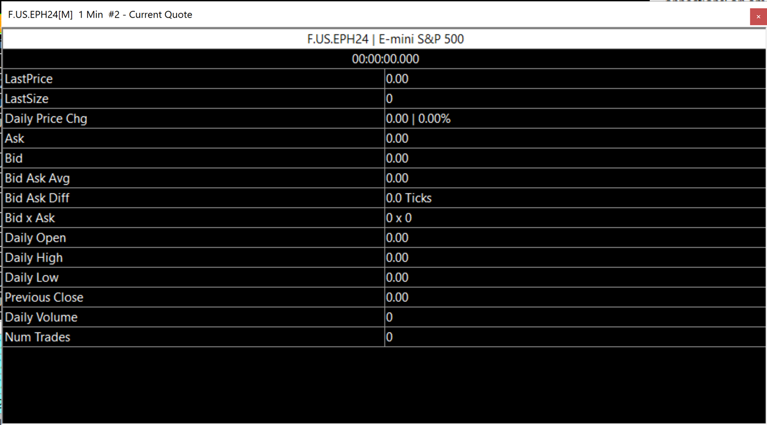

|   [2024-08-23 17:39:40]     |
                Hi, the problem has occurred again. Here is a screenshot of the Current Quote Window. Please help troubleshoot. Best, Michael  |

|   [2024-08-23 18:31:49]     |
| n8trading - Posts: 46 |
                Just my 2 cents:  1. Didn't VXQ expire this week or last week? I think the current front month symbol is VXU. 2. In your first screenshot you're showing EPU as your S&P Mini Futures symbol and it shows data, but in your second screenshot you are showing EPH with no data. I believe EPH would be the old expired contract.  |
|   [2024-08-26 00:20:30]     |
| Sierra_Chart Engineering - Posts: 21299 |
                Yes that  is a good point, the Current Quote Window is for an expired contract.

|   [2024-08-26 03:49:22]     |
                The screenshot is what I was asked to provide by Sierra_Chart Engineering the post on 2024-08-21 20:06:56 for troubleshooting. I don't know what that window does, and EPH is not the contract I'm inquiring about.

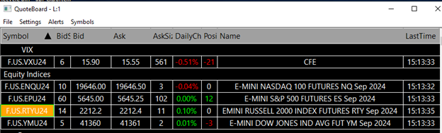

|   [2024-08-27 20:19:57]     |
                Hi, After the update, the problem has persisted and is arguably worse now. In the past I could refresh the data feed and it would fix itself. Now, when I refresh the data feed, I get incorrect data and am not able to place trades in the affected market for some reason? See attached screenshot, the bid is greater than the offer. The DOM is also glitching out for VIX so that I can't even modify orders. The latest update is also buggy. The [Modify] popup of the Trade Orders window no longer shows. I have to manually click-and-drag orders, and sometimes the DOM doesn't go as far as a particular order's price, so I have to cancel that order and re-send it manually. I need to downgrade to previous versions because I cannot trade with these bugs. Please fix the latest release and provide another way to troubleshoot. Best, Michael Date Time Of Last Edit: 2024-08-27 20:20:23
|   [2024-08-28 01:55:23]     |
                The issue with the CFE feed is now resolved and was completely unrelated, to the reason for the problem you had before which was running an older version. You still need to update to resolve the problem with the CFE feed. Regarding this we are looking into this and will have the issue resolved, on Wednesday: The [Modify] popup of the Trade Orders window no longer shows.
