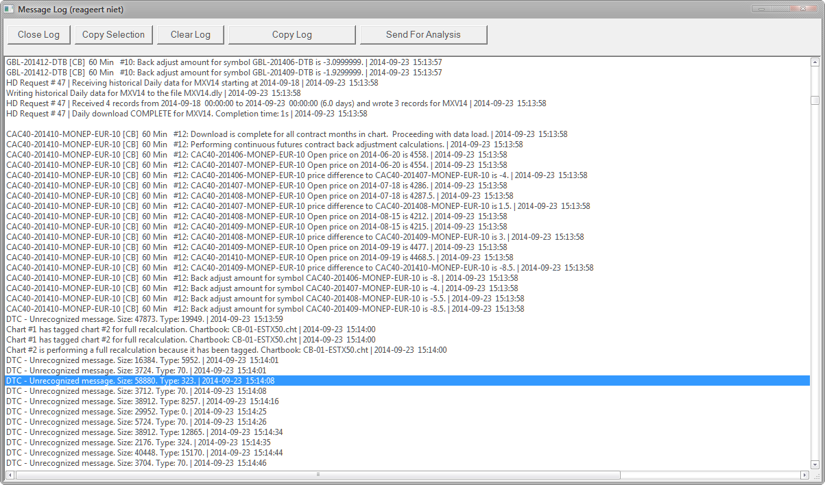

Lately I've been seeing the message "DTC - Unrecognized message" in my message log.
Today, it happened again after I opened a chartbook.
I'm seeing several messages like this:
"DTC - Unrecognized message. Size: XXXXX. Type: XXX | Time"
The sizes and types vary (see attachment).
After that, Sierra Chart became unresponsive, like it usually does.
Normally I'm seeing loads of "Unrecognized messages" per second with a size of 0. That causes SC to become unreponsive. I've waited 30 minutes in the past for the program to become responsive again, but it doesn't. I think this occured again today, because of the position of the scrollbar.
The problem occured when I was on version 1137 and it still occurs today (version 1192). Could you please solve this issue, or tell me how to solve it (if the issue is on my end)?
Thank you.

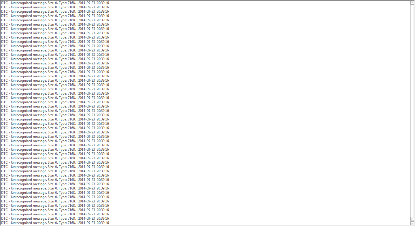

I did some testing and it took me a while before I got the unrecognized messages. I first started with a 5 chart chartbook (365 days loaded), then increased it to 20 charts, then I made the charts continuous, but I still didn't see the message. It was only after I increased the number of days to load to 999 that the "unrecognized message" started to appear.
In the attached log, the first Unrecognized message appears at 20:37:57 (after the loading of SI-201412-NYMEX-USD-5000 charts). Then after loading the CL-chart, the program receives several unrecognized messages (end of file, starting at 20:38:00).
This was my last chance to grab the message log, because after that, the program received loads of Size 0 unrecognized messages and then became unresponsive.
I have attached several files:
1 - The chartbook I created
2 - The message log from opening the CB
3 - A screenshot of the message log after the program became unresponsive

We are fairly certain, there is nothing wrong with the data feed itself and being we have no other reports of this, the only logical conclusion is that a memory corruption is occurring.
In the next release, coming out today, a DTC message size of 0 will be filtered out and a disconnection will be made to prevent all of the messages from being added to the log.

Update Sierra Chart to the latest prerelease with Help >> Download Prerelease. A message size of 0 is properly handled and will not freeze Sierra Chart.
This will at least not cause a problem with the stability of Sierra Chart in this particular regard.
Whatever is causing the memory corruption, is not totally clear at this time.
