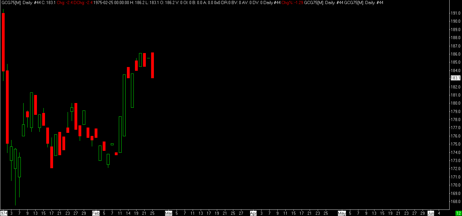

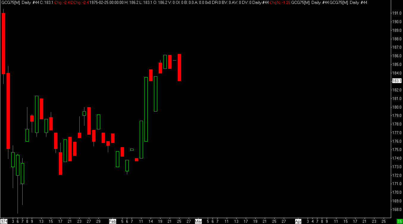

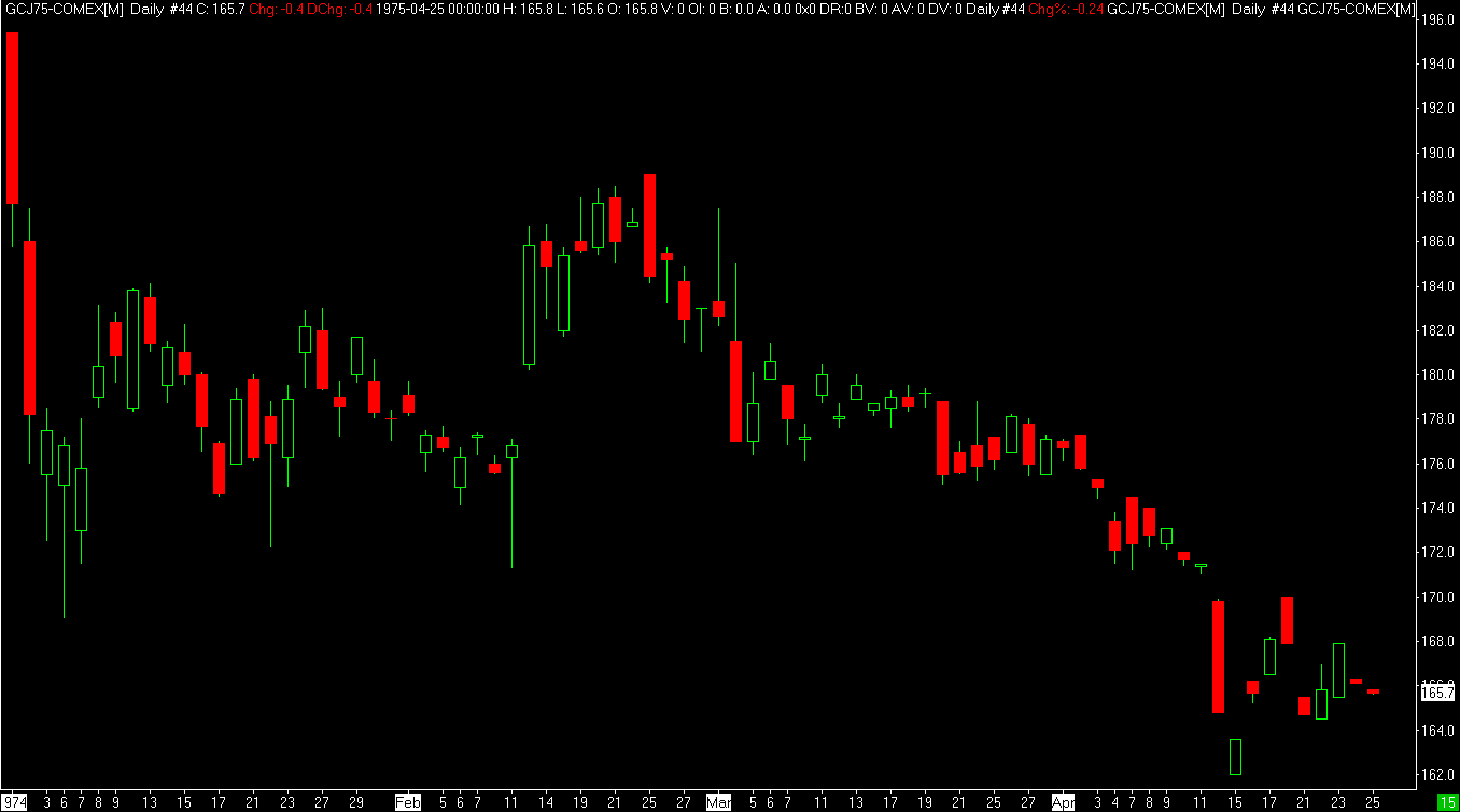

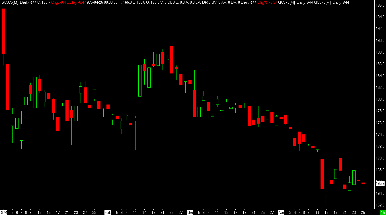

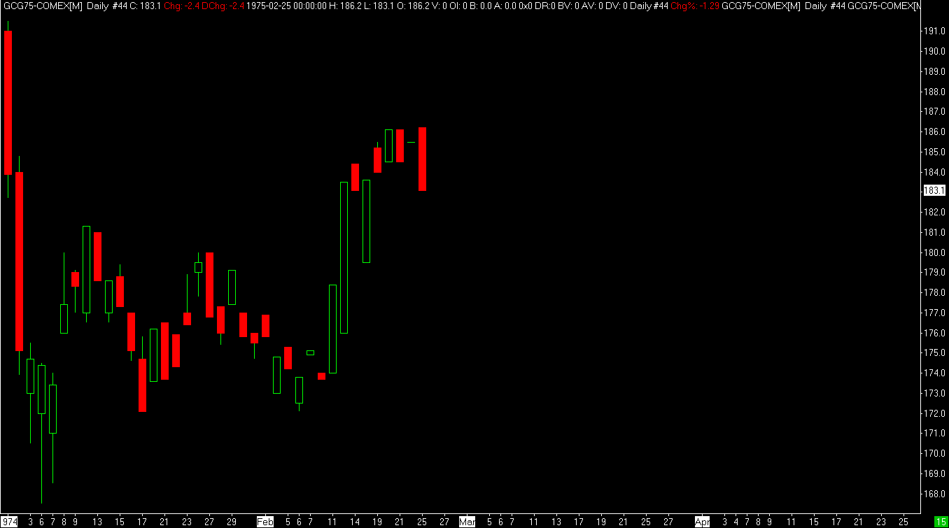

Hi John,
I apologize for asking you to check GCZ74-COMEX.dly, because there is no data for that particular file. There is data however for every contract after that. I have attached links below for the following symbols:
GCG75-COMEX.dly
GCJ75-COMEX.dly
I also managed to download the same data for the old symbol format without the "-COMEX". Since that is the case, why is this older data not included in the Continuous Futures Contract. I have attached links below for the following symbols:
GCG75.dly
GCJ75.dly
I stopped there, but I would imagine there are files after the last date I downloaded.

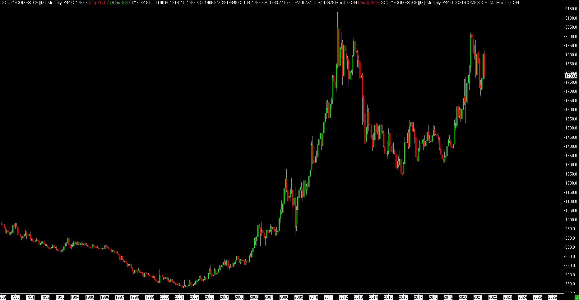

I have included a link below of sample Continuous Historical Chart of GCQ21-COMEX showing that the oldest data only goes back to 1990 instead of 1975. This was working fine just a few days ago.
Thank you.
http://www.sierrachart.com/image.php?Image=1623980060208.png

[2021-06-18 02:47:31]
Sierra_Chart Engineering - Posts: 21306
We are checking on this. We do not see a change, but we made sure that the number of months is at 600 and we released that again.
Also make sure you are running the latest Sierra Chart version. It is possible, and we would have to double check this, that older versions may be putting a limit on the number of years downloaded.
To try re-downloading the data again, follow these instructions:
Date Time Of Last Edit: 2021-06-18 02:52:38
[2021-06-18 03:18:31]
like2trade - Posts: 117
I was on version 2268. I upgraded to version 2270 and everything is working perfectly now.
Would you please increase the number of months to 700? Comex Silver has data all the way back to 1971, and soon as a result of the 600 month parameter, 1971 will be dropped and each year ongoing another year will be dropped.
Thank you very much.
