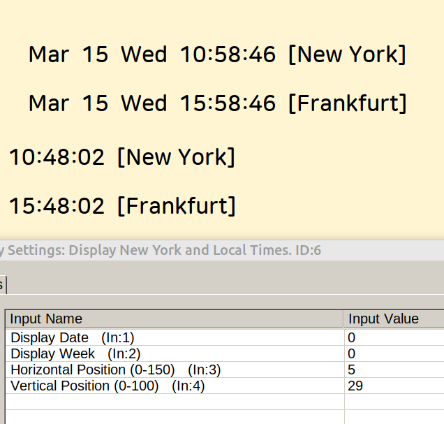

                @Chris You are welcome, just a quick and dirty solution, sorry, I was in a rush, if you are into coding, you could definitely make it fancier, see the final result in the attach image. I wrote on Sierra Chart's template, you will have to change the text color/size in Subgraphs tab, and after change horizontal or vertical positions, you might have to hide and unhide the study to make the change effective. Not sure why, could be my OS issue. To display date or week, change those values from 0(No) to 1(Yes) // The top of every source code file must include this line #include "sierrachart.h" // This line is required. Change the text within the quote // marks to what you want to name your group of custom studies. SCDLLName("Display New York and Local Times") //This is the basic framework of a study function. Change the name 'DisplayTimes' to what you require. SCSFExport scsf_DisplayTimes(SCStudyInterfaceRef sc) { SCInputRef DisplayDate {sc.Input[0]}; SCInputRef DisplayWeek {sc.Input[1]}; SCInputRef Horizontal {sc.Input[2]}; SCInputRef Vertical {sc.Input[3]}; SCSubgraphRef TextSizeColor {sc.Subgraph[0]}; // Section 1 - Set the configuration variables and defaults if (sc.SetDefaults) { sc.GraphName = "Display New York and Local Times"; sc.AutoLoop = 1; //Automatic looping is enabled. sc.GraphRegion = 0; TextSizeColor.Name = "Adjust Text Size and Color"; TextSizeColor.DrawStyle = DRAWSTYLE_CUSTOM_TEXT; TextSizeColor.PrimaryColor = RGB (225, 215, 185); TextSizeColor.LineWidth = 10; DisplayDate.Name = "Display Date"; DisplayDate.SetInt(0); DisplayWeek.Name = "Display Week"; DisplayWeek.SetInt(0); Horizontal.Name = "Horizontal Position (0-150)"; Horizontal.SetInt(5); Vertical.Name = "Vertical Position (0-100)"; Vertical.SetInt(80); return; } // Section 2 - Do data processing here SCString WeekDays {"SunMonTueWedThuFriSat"}; SCString Months {"NulJanFebMarAprMayJunJulAugSepOctNovDec"}; SCDateTime NewYorkLocal { sc.IsReplayRunning() ? sc.ConvertDateTimeFromChartTimeZone(sc.BaseDataEndDateTime[sc.Index], TIMEZONE_NEW_YORK) : sc.ConvertDateTimeFromChartTimeZone(sc.CurrentSystemDateTime, TIMEZONE_NEW_YORK) }; SCDateTime FrankurtLocal { sc.IsReplayRunning() ? sc.ConvertDateTimeFromChartTimeZone(sc.BaseDataEndDateTime[sc.Index], TIMEZONE_BRUSSELS) : sc.ConvertDateTimeFromChartTimeZone(sc.CurrentSystemDateTime, TIMEZONE_BRUSSELS) }; SCString DisplayText {""}; DisplayText.Format(""); if (sc.IsReplayRunning()) DisplayText.AppendFormat("Chart Is Replaying ... \n\n"); if (DisplayDate.GetInt()) DisplayText.AppendFormat("%s %d ", Months.GetSubString(3,3*NewYorkLocal.GetMonth()).GetChars(), NewYorkLocal.GetDay()); if (DisplayWeek.GetInt()) DisplayText.AppendFormat("%s ", WeekDays.GetSubString(3,3*NewYorkLocal.GetDayOfWeek()).GetChars()); DisplayText.AppendFormat("%02d:%02d:%02d [New York]\n\n", NewYorkLocal.GetHour(), NewYorkLocal.GetMinute(), NewYorkLocal.GetSecond()); if (DisplayDate.GetInt()) DisplayText.AppendFormat("%s %d ", Months.GetSubString(3,3*FrankurtLocal.GetMonth()).GetChars(), FrankurtLocal.GetDay()); if (DisplayWeek.GetInt()) DisplayText.AppendFormat("%s ", WeekDays.GetSubString(3,3*FrankurtLocal.GetDayOfWeek()).GetChars()); DisplayText.AppendFormat("%02d:%02d:%02d [Frankfurt]\n\n", FrankurtLocal.GetHour(), FrankurtLocal.GetMinute(), FrankurtLocal.GetSecond()); sc.AddAndManageSingleTextUserDrawnDrawingForStudy(sc, 0, Horizontal.GetInt(), Vertical.GetInt(), TextSizeColor, 1, DisplayText, 1, 0, 0); } Date Time Of Last Edit: 2023-03-16 05:41:36
|   [2023-03-15 17:50:40]     |
| Chris900 - Posts: 6 |
                @Tony: Great Stuff, thanks a lot. I just loaded into the system and it works nicely. Really cool that you wrote a quick coding for me! Thanks :-) :-) As for anybody else who might want to have this in the future. Here is the guideline to load this: How to Build an Advanced Custom Study from Source Code And then make sure like Tony said to go into Analysis-->Studies-->click on settings for the study-->go to tab subgraph And change the color and width/size (bigger) so that you can see it on the chart. Took me a while to figure this out. Really nice, now I see both times all the time very quickly.  |

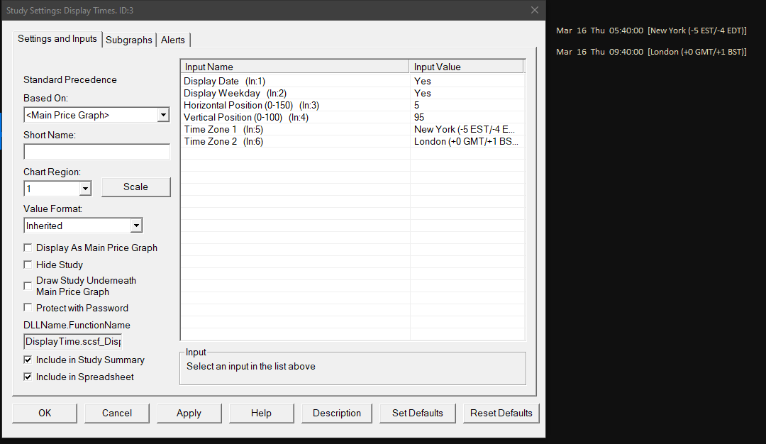

| User431178 - Posts: 805 |
                Variation on above with selectable time zones. // The top of every source code file must include this line #include "sierrachart.h" // This line is required. Change the text within the quote // marks to what you want to name your group of custom studies. SCDLLName("Display New York and Local Times") //This is the basic framework of a study function. Change the name 'DisplayTimes' to what you require. SCSFExport scsf_DisplayTimes(SCStudyInterfaceRef sc) { auto& DisplayDate = sc.Input[0]; auto& DisplayWeekday = sc.Input[1]; auto& Horizontal = sc.Input[2]; auto& Vertical = sc.Input[3]; auto& TimeZone1 = sc.Input[4]; auto& TimeZone2 = sc.Input[5]; auto& TextSizeColor = sc.Subgraph[0]; if (sc.SetDefaults) { sc.GraphName = "Display Times"; sc.AutoLoop = 0; sc.GraphRegion = 0; TextSizeColor.Name = "Adjust Text Size and Color"; TextSizeColor.DrawStyle = DRAWSTYLE_CUSTOM_TEXT; TextSizeColor.PrimaryColor = RGB(225, 215, 185); TextSizeColor.LineWidth = 10; DisplayDate.Name = "Display Date"; DisplayDate.SetYesNo(0); DisplayWeekday.Name = "Display Weekday"; DisplayWeekday.SetYesNo(0); Horizontal.Name = "Horizontal Position (0-150)"; Horizontal.SetInt(5); Horizontal.SetIntLimits(0, 150); Vertical.Name = "Vertical Position (0-100)"; Vertical.SetInt(80); Vertical.SetIntLimits(0, 100); TimeZone1.Name = "Time Zone 1"; TimeZone1.SetTimeZone(TIMEZONE_NEW_YORK); TimeZone2.Name = "Time Zone 2"; TimeZone2.SetTimeZone(TIMEZONE_LONDON); return; } const auto dT1 = sc.IsReplayRunning() ? sc.ConvertDateTimeFromChartTimeZone(sc.LatestDateTimeForLastBar, TimeZone1.GetTimeZone()) : sc.ConvertDateTimeFromChartTimeZone(sc.CurrentSystemDateTime, TimeZone1.GetTimeZone()); const auto dT2 = sc.IsReplayRunning() ? sc.ConvertDateTimeFromChartTimeZone(sc.LatestDateTimeForLastBar, TimeZone2.GetTimeZone()) : sc.ConvertDateTimeFromChartTimeZone(sc.CurrentSystemDateTime, TimeZone2.GetTimeZone()); auto displayText = SCString{}; if (sc.IsReplayRunning()) displayText.AppendFormat("Chart Is Replaying ... \n\n"); if (DisplayDate.GetYesNo()) displayText.AppendFormat("%s %d ", SHORT_NAME_FOR_MONTH[dT1.GetMonth()], dT1.GetDay()); if (DisplayWeekday.GetYesNo()) displayText.AppendFormat("%s ", SHORT_NAME_FOR_DAY_OF_WEEK[dT1.GetDayOfWeek()]); displayText.Append(sc.DateTimeToString(dT1, FLAG_DT_COMPLETE_TIME)); displayText.AppendFormat(" [%s]\n\n", TIME_ZONE_NAME_STRINGS[TimeZone1.GetTimeZone()]); if (DisplayDate.GetYesNo()) displayText.AppendFormat("%s %d ", SHORT_NAME_FOR_MONTH[dT2.GetMonth()], dT2.GetDay()); if (DisplayWeekday.GetYesNo()) displayText.AppendFormat("%s ", SHORT_NAME_FOR_DAY_OF_WEEK[dT2.GetDayOfWeek()]); displayText.Append(sc.DateTimeToString(dT2, FLAG_DT_COMPLETE_TIME)); displayText.AppendFormat(" [%s]\n\n", TIME_ZONE_NAME_STRINGS[TimeZone2.GetTimeZone()]); sc.AddAndManageSingleTextUserDrawnDrawingForStudy(sc, 0, Horizontal.GetInt(), Vertical.GetInt(), TextSizeColor, 1, displayText, 1, 0, 0); }  |
|   [2023-03-16 15:16:00]     |
| Tony - Posts: 640 |
                Thanks User431178! That was quick! Good to know the sc.Input[0].SetTimeZone(), not listed in the Members List on Sierra's web site. I guess I will have to read head files in ACS_Source folder when I have time. For things like SHORT_NAME_FOR_MONTH[] etc. Thanks again! Date Time Of Last Edit: 2023-03-16 15:46:26
