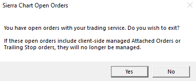

                I keep getting the attached "Sierra Chart Open Orders" message for the  2 sub instances when exiting Sierra.  However, I have no open order and I also checked with broker....no open orders. The curious thing is that I get the message on 2 sub instances (when I exit) also and I don't trade on both sub instances.  The main instance does no give the open orders message. I don't know how to get this message cleared. it seems to have started with the update to version 2270. Please help. Date Time Of Last Edit: 2021-06-15 19:45:37

| Sierra_Chart Engineering - Posts: 21301 |
                There must be an open order and it would be listed in Trade >> Trade Orders Window within that instance.

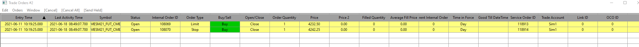

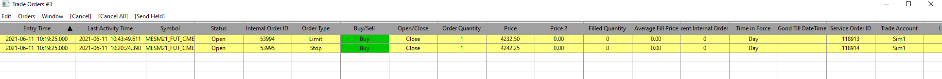

                Thanks you .  I do see what appears to be the remaining child orders for the stop and target on 6/11 when looking at the trade orders.  However, I do not see them in the trade activity log.  These are left over SIM orders.  I usually can delete them from the activity log but it is empty and the 2 orders are still showing on the Trade Order page.  How can i delete/cancel them.  the cancel etc. does not work on the trade order page.    The same is true for a second instance I have.  I attached pictures of the two instances below.  Could you clear these for me?  they are obviously not active since we have went through these prices at a later date. The exact same orders are in Instances 2 and 3 as show below  |
                Go to the main instance of Sierra Chart and enable Trade Simulation Mode: Trade Menu: Trade Simulation Mode On (Trade menu) And then go to each of those sub instances, and make sure they are connected to the main instance, and then cancel the orders: Trading Information Windows: Canceling Orders Sierra Chart Support - Engineering Level  Your definitive source for support. Other responses are from users. Try to keep your questions brief and to the point. Be aware of support policy: https://www.sierrachart.com/index.php?l=PostingInformation.php#GeneralInformation For the most reliable, advanced, and zero cost futures order routing, use the Teton service: Sierra Chart Teton Futures Order Routing  |
