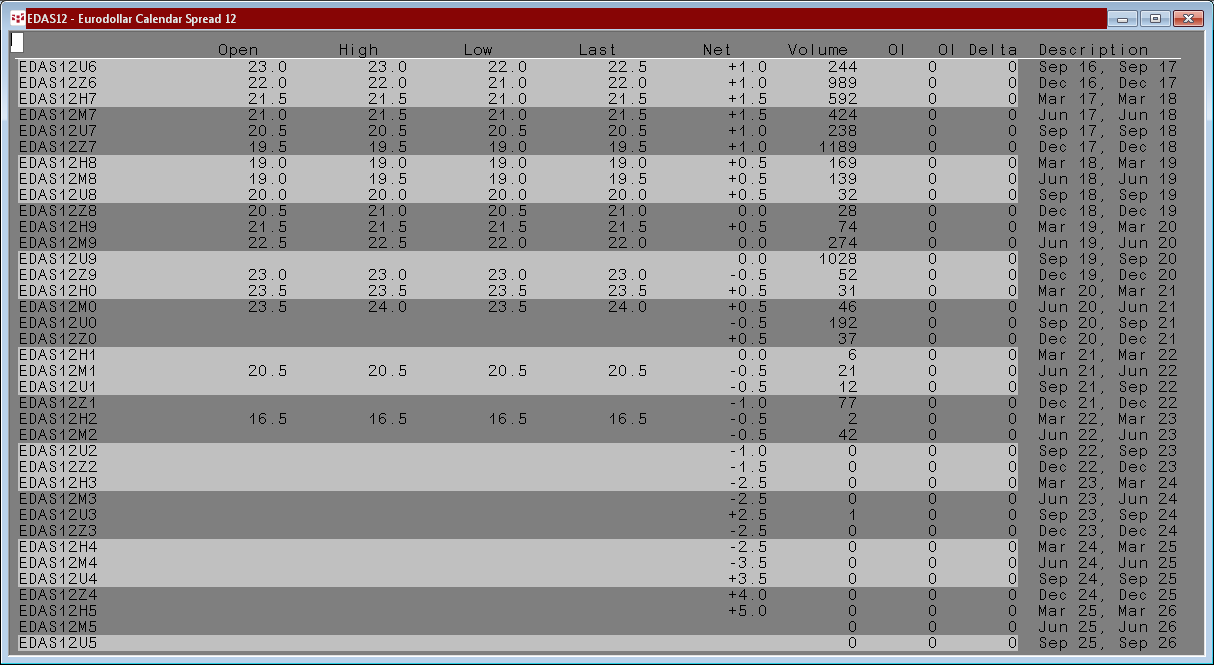

                This is from CQG: The symbol EDAS12H00 would imply the year 2000
In the attachment is the current listing of 12 month spreads Let us know if those given symbols work for both market data and trading. Sierra Chart Support - Engineering Level  Your definitive source for support. Other responses are from users. Try to keep your questions brief and to the point. Be aware of support policy: https://www.sierrachart.com/index.php?l=PostingInformation.php#GeneralInformation For the most reliable, advanced, and zero cost futures order routing, *change* to the Teton service: Sierra Chart Teton Futures Order Routing Date Time Of Last Edit: 2016-06-21 18:04:28

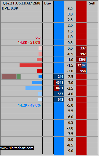

                Hi, I have a similar problem with F.US.EDAL12M18, I get data with F.US.EDAL12M8 but this is not tradable, and do not get any data with the normal symbol: http://www.sierrachart.com/image.php?Image=1466613392290.png Any ideas on what is happening? Am I the only one with CQG having these issues? Thanks  |

                We need to do some testing  of these symbols and then report this information to CQG. This will be done today.

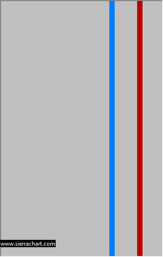

                It seems that I'm having issues to get data every time that I add a new symbol not sure why though... Is this due to CQG or my setup? I have to log into CQG Simple Trader enter a trade, log back into Sierra and cancel the trade, very weird... http://www.sierrachart.com/image.php?Image=1466688313699.png Date Time Of Last Edit: 2016-06-23 13:25:58

                There should be an initial price. What specific symbol did you have a problem with? Provide a copy of the Message Log by following these instructions: http://www.sierrachart.com/index.php?l=PostingInformation.php#MessageLog Sierra Chart Support - Engineering Level  Your definitive source for support. Other responses are from users. Try to keep your questions brief and to the point. Be aware of support policy: https://www.sierrachart.com/index.php?l=PostingInformation.php#GeneralInformation For the most reliable, advanced, and zero cost futures order routing, *change* to the Teton service: Sierra Chart Teton Futures Order Routing Date Time Of Last Edit: 2016-06-23 17:43:51
