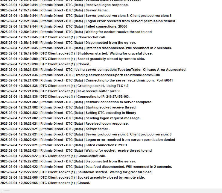

|   [2025-02-04 17:37:59]     |
| coachted - Posts: 462 |
                Thanks John... I am looking for a volatility index or options volatility for CL, 6E and 6J...I will look in th CBOT material you shared....Thanks again... Another question...I have attached a screenshot...can you please tell me what is going on and why it continues to happen...  |
|   [2025-02-04 20:12:48]     |
| John - SC Support - Posts: 42741 |
                You are getting a "Permission Denied" error from Rithmic. Refer to the following: Rithmic Trading Platform Service: Permission Denied Resolution Procedure For the most reliable, advanced, and zero cost futures order routing, use the Teton service:  Sierra Chart Teton Futures Order Routing  |

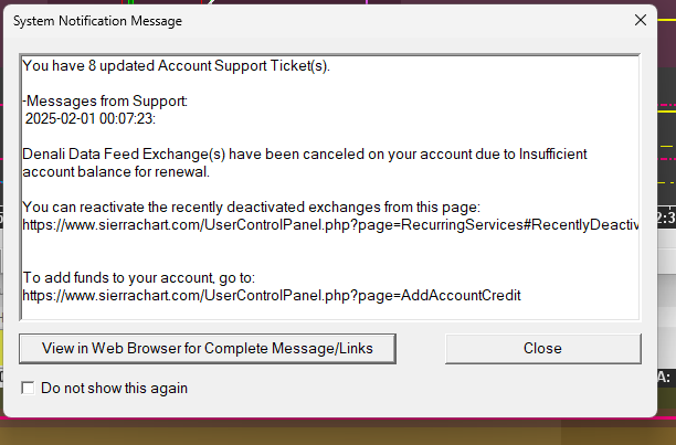

|   [2025-02-05 13:23:04]     |
                John, I dont have any data, the box says my denali was cancelled yet i paid it the other day, which you confirmed above...please advise  |
|   [2025-02-05 13:33:19]     |
| User135243 - Posts: 154 |
                if it was canceled, activate it again, if you have paid, just watch what your surplus is, if there is enough money activate your data
|   [2025-02-05 13:45:39]     |
                So yesterday it worked fine...it iup and running on 1 pc but this is the message i am recieving this message on the pc that i use rithmic for topstep accounts...
|   [2025-02-05 16:50:49]     |
                Rithmic is having issues. They have been informed.

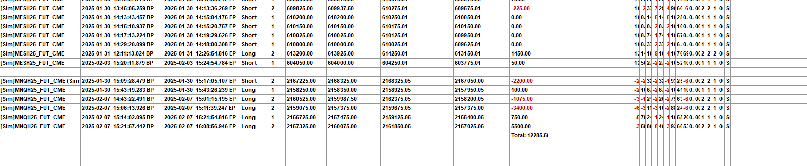

|   [2025-02-08 17:33:59]     |
                hey john  why are the decimals wrong in products i have traded wrong in trade log....here is a copy of some sim trades i did...this doesnt happen in my top step account trade log...see attachment number 2...can you tell me how to fix this in the sim
                 Date Time Of Last Edit: 2025-02-08 17:36:20
|   [2025-02-09 01:06:59]     |
| Sierra_Chart Engineering - Posts: 21299 |
                Refer to: Trade Activity Log: Solving Trade Activity Incorrect Price Formatting and P/L Values Sierra Chart Support - Engineering Level  Your definitive source for support. Other responses are from users. Try to keep your questions brief and to the point. Be aware of support policy: https://www.sierrachart.com/index.php?l=PostingInformation.php#GeneralInformation For the most reliable, advanced, and zero cost futures order routing, use the Teton service: Sierra Chart Teton Futures Order Routing  |
                my trade log is showing the decimal place in the wrong spot since...for example it has a buy in ES as 60300.00 rather than 6030.00 therefoe my pl is off how do i fix this Thanks Mike  |
|   [2025-02-14 16:03:01]     |
                Refer to the following: Trade Activity Log: Solving Trade Activity Incorrect Price Formatting and P/L Values For the most reliable, advanced, and zero cost futures order routing, use the Teton service:  Sierra Chart Teton Futures Order Routing  |

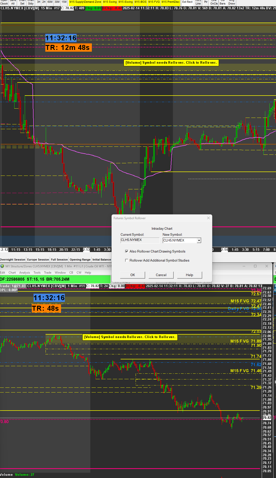

|   [2025-02-14 16:33:42]     |

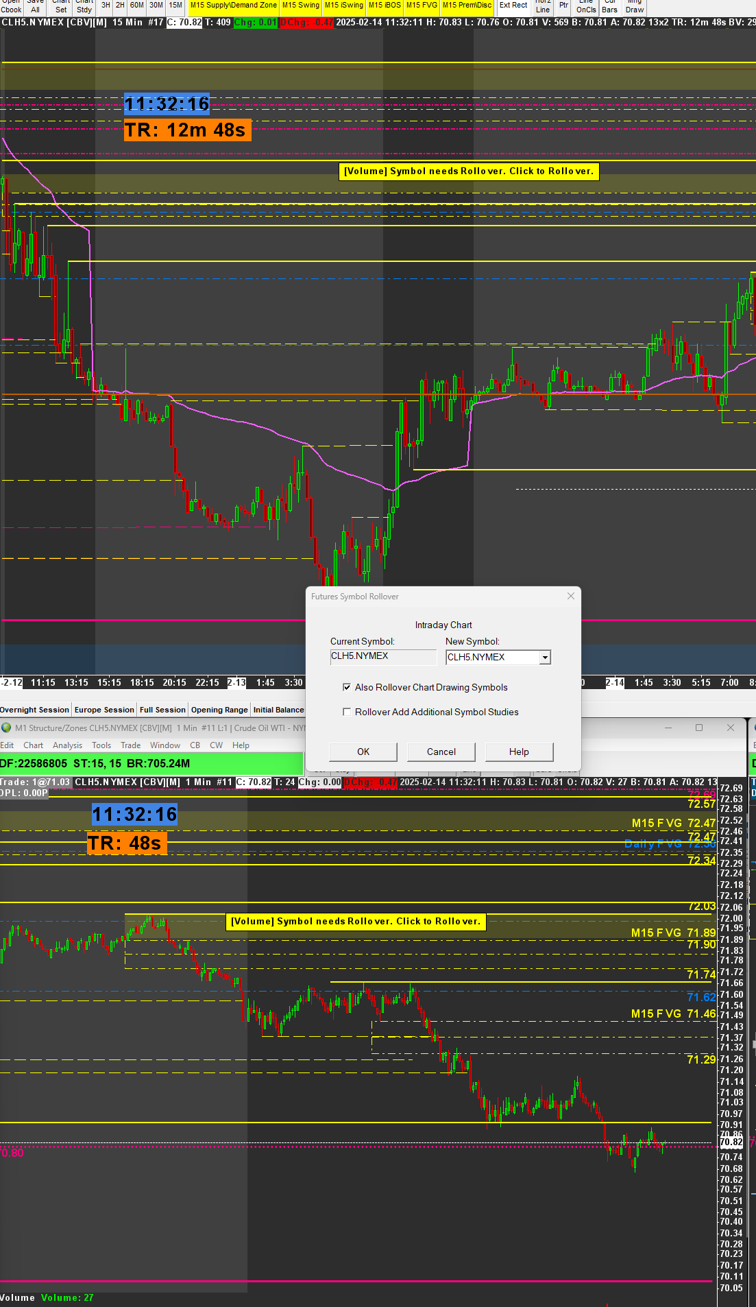

                hey just got a notice to roll over my CL contracts but as confused...I have been on this contract for a while and it is tell me to roll over to the same contract
|          Attachment Deleted.  |
|   [2025-02-14 18:53:39]     |
                The rollover window will list the current contract for rollover until the Date Rule rollover has occurred. Right now, you are being prompted to rollover due to a Volume change (the newer contract has a higher traded volume than the current contract). Therefore, just select the next contract in the list (CLJ5.NYMEX).
|   [2025-02-14 19:49:00]     |
                got you thanks....

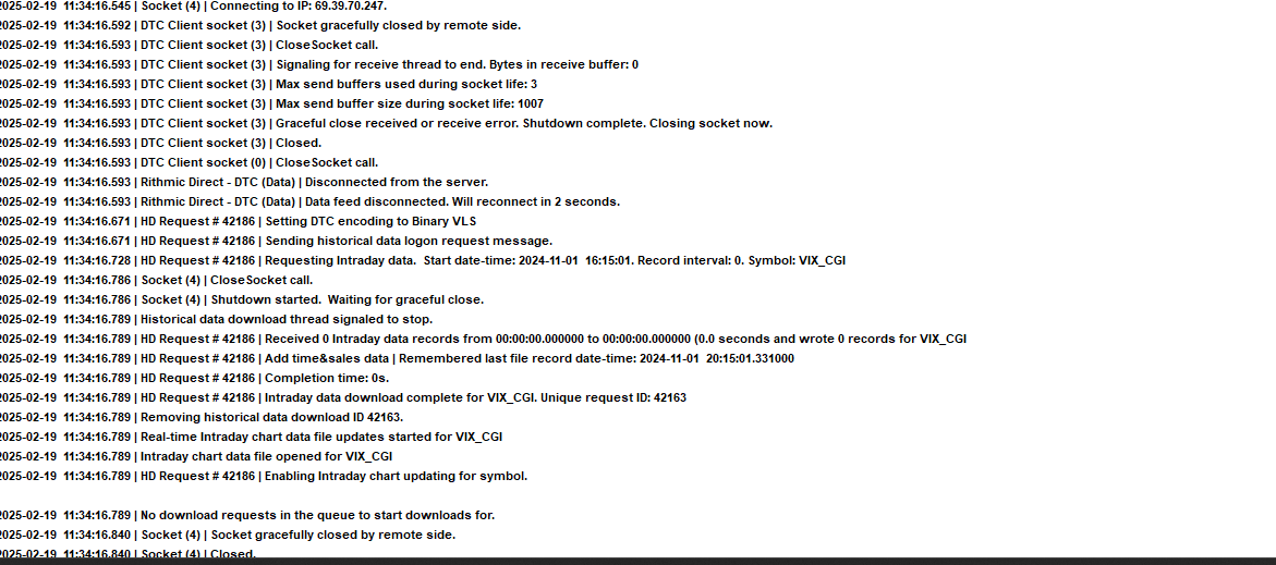

|   [2025-02-19 16:38:34]     |
                Laslty I keep getting my message window popping up...can you please advise
|   [2025-02-19 18:03:45]     |
                Refer to the following: Rithmic Trading Platform Service: Frequent Reconnections In the portion of the log you included we see the symbol VIX_CGI, which is one symbol that Rithmic will not like. And you are not setup to get the data for the CBOE Indices, therefore you should not have that symbol at all as you will not get any data for it. For the most reliable, advanced, and zero cost futures order routing, use the Teton service:  Sierra Chart Teton Futures Order Routing  |

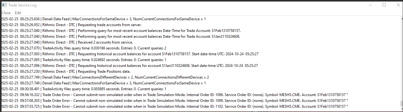

|   [2025-02-25 15:10:31]     |

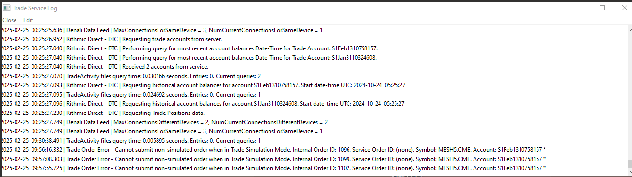

                can you explain and advise on why i am recieving this on my second pc and how to fix it
|   [2025-02-25 15:50:24]     |
                Disable Trade Simulation Mode: Overview of Trading: Difference between Simulated and Non-Simulated Trading Modes Sierra Chart Support - Engineering Level  Your definitive source for support. Other responses are from users. Try to keep your questions brief and to the point. Be aware of support policy: https://www.sierrachart.com/index.php?l=PostingInformation.php#GeneralInformation For the most reliable, advanced, and zero cost futures order routing, use the Teton service: Sierra Chart Teton Futures Order Routing  |
|   [2025-02-25 16:42:47]     |
                sorry john i just realized when you sent this that i only changed the acct and didnt turn off sim...sorry

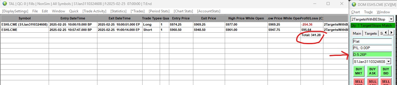

                last question my p/l is off on my dom vs the actual trade low i am confused as to why...can you please advise as this is the first time this has ever happened
