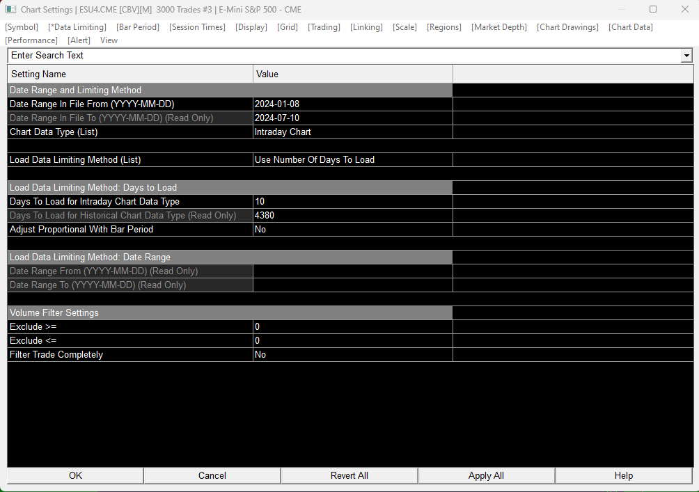

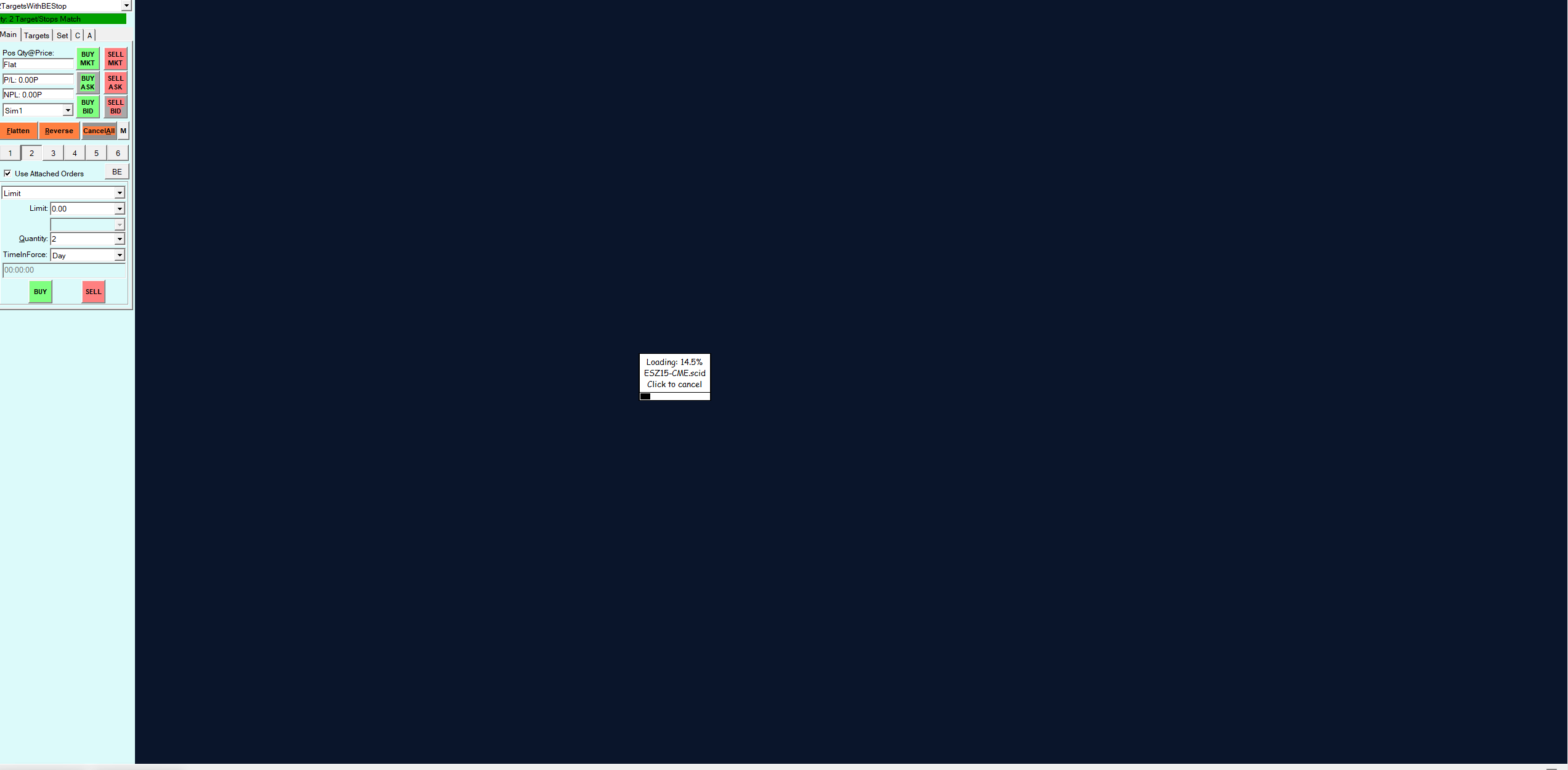

Hello, I've recently built a chartbook where the charts are either NQ or ES. I've rolled over the ESU4 and NQU4, but each timle I open the chartbook it keeps loading old tickers like ESZ15. Any clue how to correct this please? I used Translate Symbols to current services, Delete and Download, etc. but it keeps repeating the same problem and the charbook becomes less responsive. Thanks

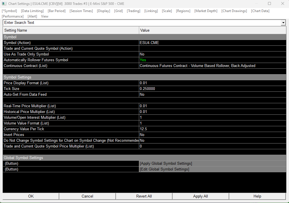

You are using a "Continuous Futures Contract" option and the number of days to load data is very large - so large that it is needing to go back to 2015 for data.
Reduce the number of days to load to start. If you do not need a Continuous Futures Contract, then set that option to None.
Refer to the following:
Chart Settings: Days to Load for Intraday Chart Data Type (Chart >> Chart Settings >> Data Limiting >> Load Data Limiting Method: Days to Load)
Chart Settings: Continuous Contract (Chart >> Chart Settings >> Symbol >> Symbol menu)

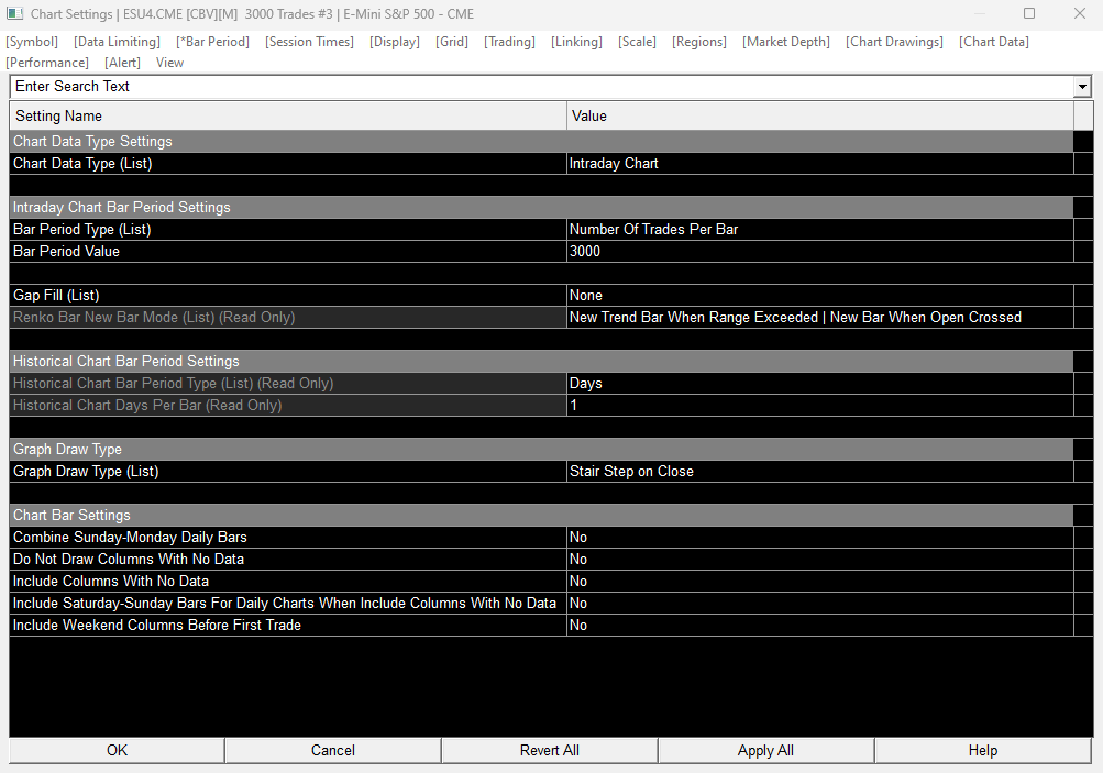

Third, I've removed "Continuous Futures Contract" option, manually deleted all the *.scid and *.dly in the data folder and restarted SC and everything works well.
FYI, my typical settings for each chart is as attached screenshots ("Continuous Futures Contract" option and 10 days history).
