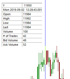

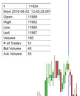

I'm having the following issue during backtesting/replaying data (regardless if I'm using Accurate Trading System Back Test Mode or Calculate at Every Tick/Trade - altough it shouldn't make a difference on this issue anyhow):
The attached images MiniDAX-Backtesting-1.jpg and MiniDAX-Backtesting-2.jpg show two bars with a high of 11992. So I'd expect
sc.BaseData[SC_LAST][index]
to turn somewhen during the processing of these bars to the value 11992. Unfortunatelly debugging shows, it never does. What is interesting during debugging is, that in both cases
sc.BaseData[SC_HIGH][index]
turns to 11992 with the same tick, when
turns to 11991.
Can you please check why the high of a bar (and possibly also the low but I didn't check that) is not represented by a tick representing this value?

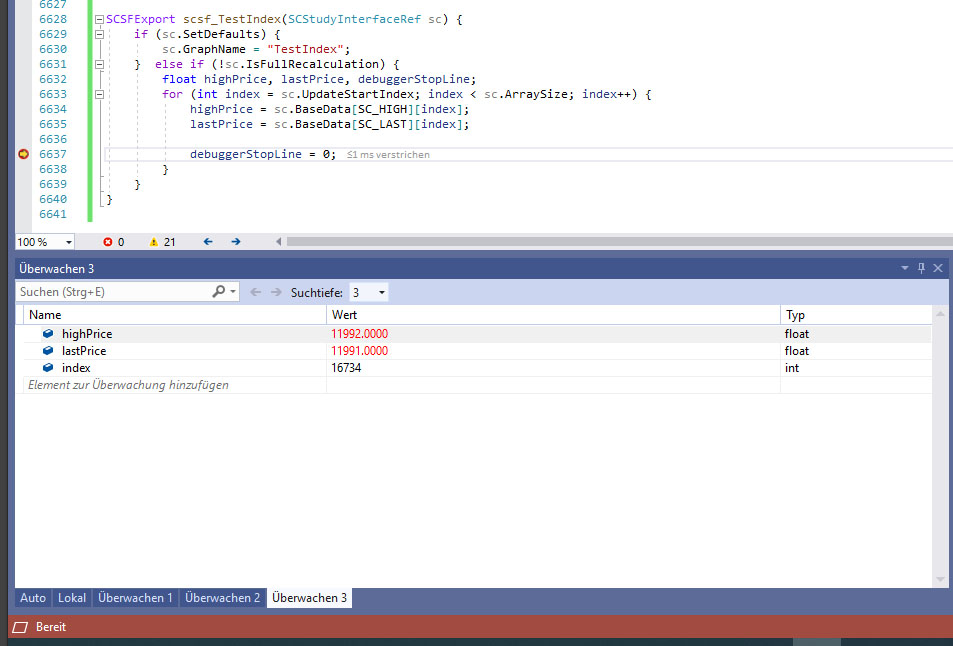

Believe me I'd be happy to be proven wrong - but another very simple test shows the following:
I put together the following testing routine:
SCSFExport scsf_TestIndex(SCStudyInterfaceRef sc) {
  if (sc.SetDefaults) {
    sc.GraphName = "TestIndex";
  } else if (!sc.IsFullRecalculation) {
    float highPrice, lastPrice, debuggerStopLine;
    for (int index = sc.UpdateStartIndex; index < sc.ArraySize; index++) {
      highPrice = sc.BaseData[SC_HIGH][index];
      lastPrice = sc.BaseData[SC_LAST][index];
      debuggerStopLine = 0;

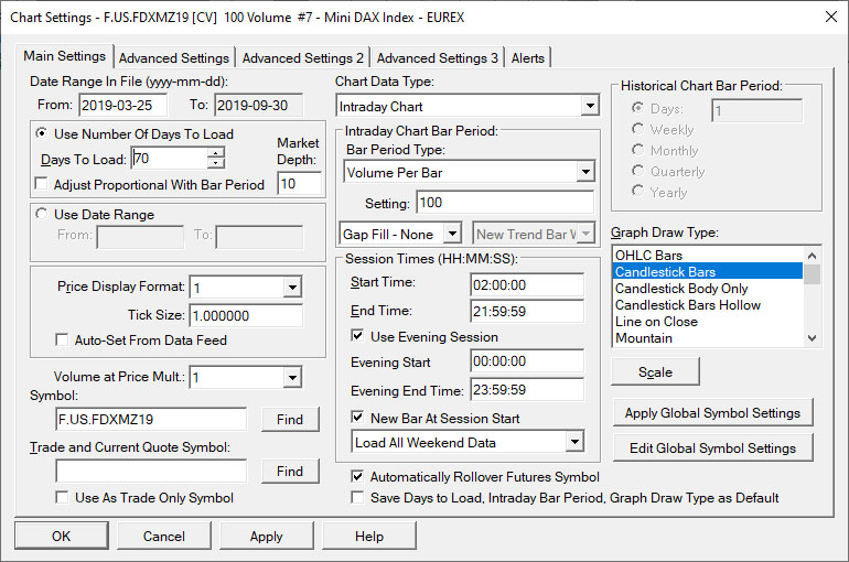

I also made sure, I'm not using Renko bars or anything else, opened a plain chart with the settings attached in the file ChartSettings.jpg and added the study outlined above to the chart. Debugger-1.jpg shows the debug information before the error occurs - please see the high and the last value both being at 11990 what is perfectly fine. With the next iteration (please see Debugger-2.jpg) the high is 11992 and the last value 11991.
Please also note the index stays unchanged - so no new bar!
Could the issue occur because of manual looping?
I don't wanna bother you but this is a serious issue!

[2019-11-18 14:31:02]
We cannot spend the time to be running through tests. There is simply 0% possibility of a problem here.
But just simply looking at what you said in post #3 why do you think there is a problem? It is perfectly normal for the sc.BaseData values to change at indexes from the old array size up to the current size during chart updating.
Because:
First there is an increase to 11990 - the new high (11990) is established by the last tick (11990). So far so good.
In the next iteration (-> the next tick!) the new high is 11992 giving a new last tick with 11991.
BUT: where is the tick that brought the high to 11992 if the last one is 11991? How can there be a new high of the bar without a tick making the high?
From an exchange point of view, this is impossible. There is a one to one-relation between a tick and a price. So the bar cannot make a new high (11992) and close at a different price (11991) with one tick, because either the price of the tick is 11992 OR 11991 - it cannot be both!
Do you see my point?
