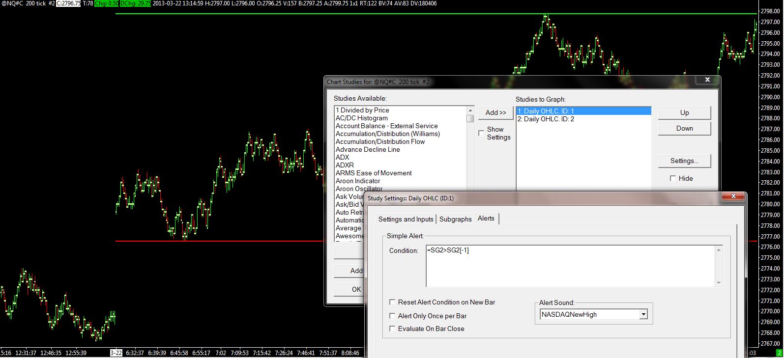

                Hello, I wanted to setup an daily high and low alerts for few of instruments that I monitor such as NQ/DOW/Financials, etc. Basically, whenever NQ makes a new High or Low for the day I wanted an alert sound. I tried it with Daily OHLC and High Low Timeframe studies but it does not work as I expect it. Here is what I did. 1. Lets say for NQ chart which is setup only for RTH session, I added two Daily OHLC studies. 2. One of the study displaying only High of the day and second will display only Low of the day 3. For High value, I setup Alert for the High "=SG2>SG2[-1]" 4. For Low value, I setup Alert for the High "=SG3<SG3[-1]" 5. I have also setup Alert sound for each of them. 6. Reset Alert condition on new bar is set to false, Alert only once per bar is set to false and Evaluate on bar close is set to false. But it is not working. I noticed that SG2 refers to current bar and SG2[-1] refers to previous bar. I was expecting SG2[-1] will refer to previous high and I can compare between the two. I didn't want to setup one alert at the chart level then you end up creating several charts per alter you want. It will work better if an alert is set at study level. Let me know if I am not setting up correctly. Thanks SherKhan  |

                Try this: Add the Daily OHLC study, set the Reference Days back to 0, set Graph High and Low Historically to Yes, and put this on the Alerts tab: =OR(C>SG2[-1],C<SG3[-1]) You can check Hide Study, if you don't want to see the lines.  |
|   [2013-03-24 23:33:24]     |
| SherKhan - Posts: 19 |
                Yes that seems to be working.  Thanks  |
