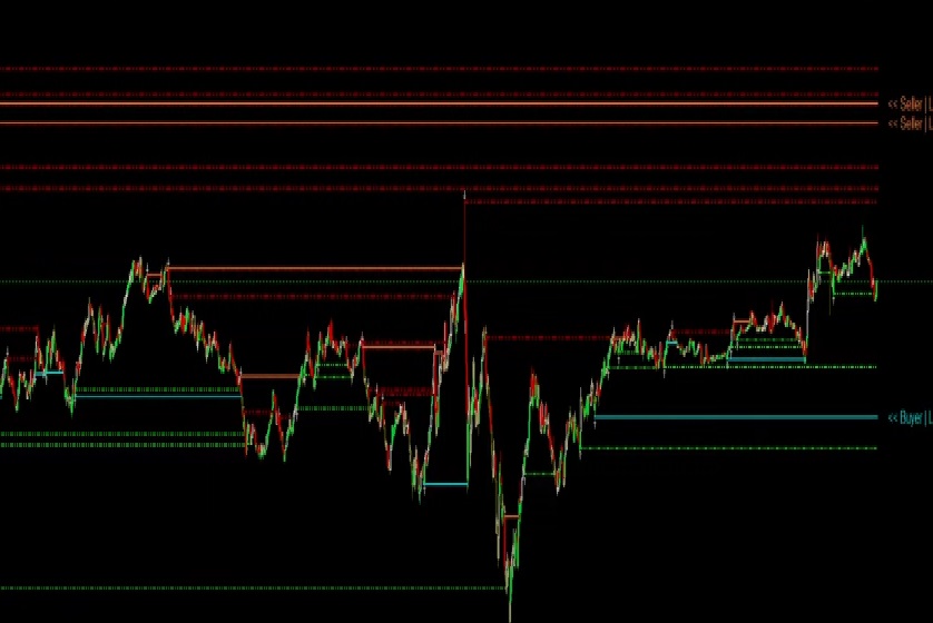

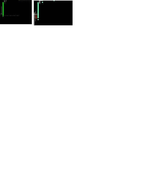

Hi, I used study Color bar based on alert condition to set the color of the candle. Would you pls help to get the line under the candle like attached files. My candles don't have the line under. Thanks Lily |
Candle without line under.jpg / V - Attached On 2024-07-03 00:26:57 UTC - Size: 9.5 KB - 55 views |

The image is too small for us to be able to make anything out from it. Please get us an image by following these instructions: Support Board Posting Information: Attaching or Posting a Screenshot/Image (Optional) For the most reliable, advanced, and zero cost futures order routing, use the Teton service: Sierra Chart Teton Futures Order Routing |

Hi, I have only picture because I cannot set up like this. Pls open the attached file. How can set up the line under candle with my conditional alert? Thank you, Lily |
Line under candle.jpg / V - Attached On 2024-07-10 03:25:05 UTC - Size: 85.84 KB - 29 views |
[2024-07-10 13:16:03] |
John - SC Support - Posts: 35333 |
It looks like that is an extension line. Refer to the following and the Input below it: Color Bar Based on Alert Condition: Draw Extension Lines at Color Bar Value For the most reliable, advanced, and zero cost futures order routing, use the Teton service: Sierra Chart Teton Futures Order Routing |

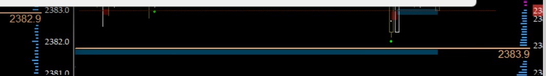

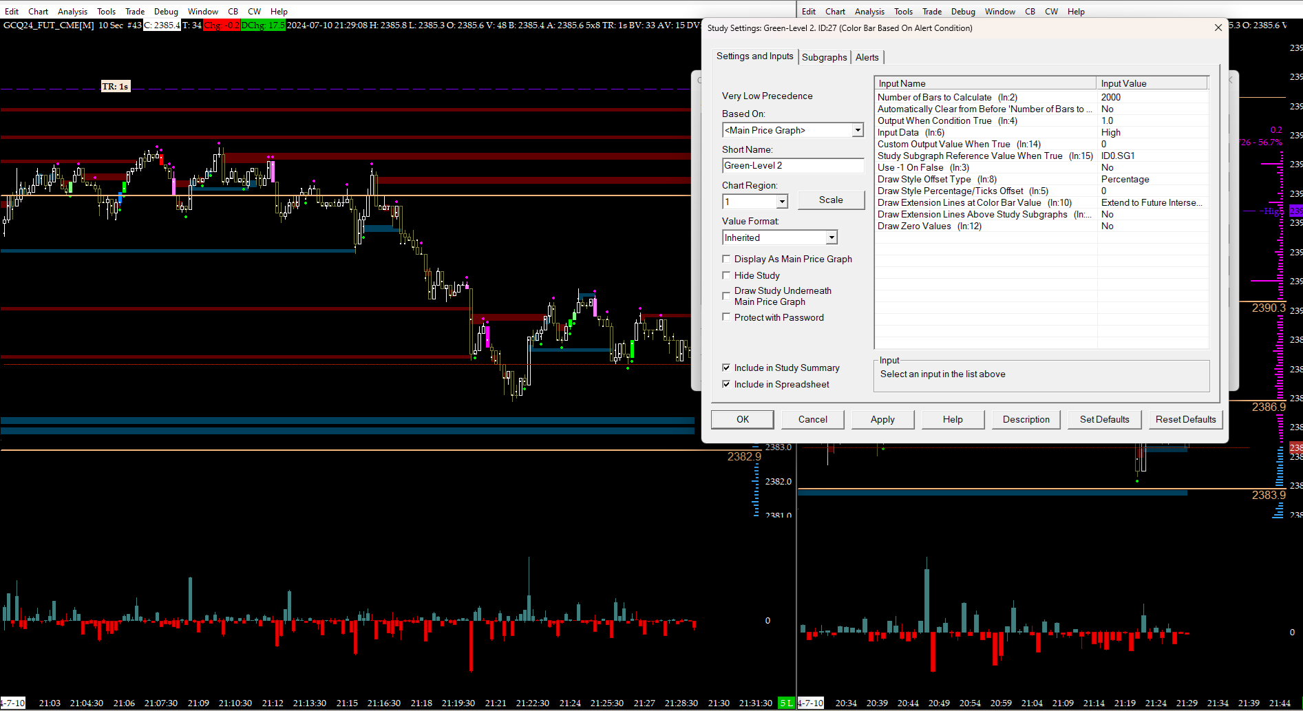

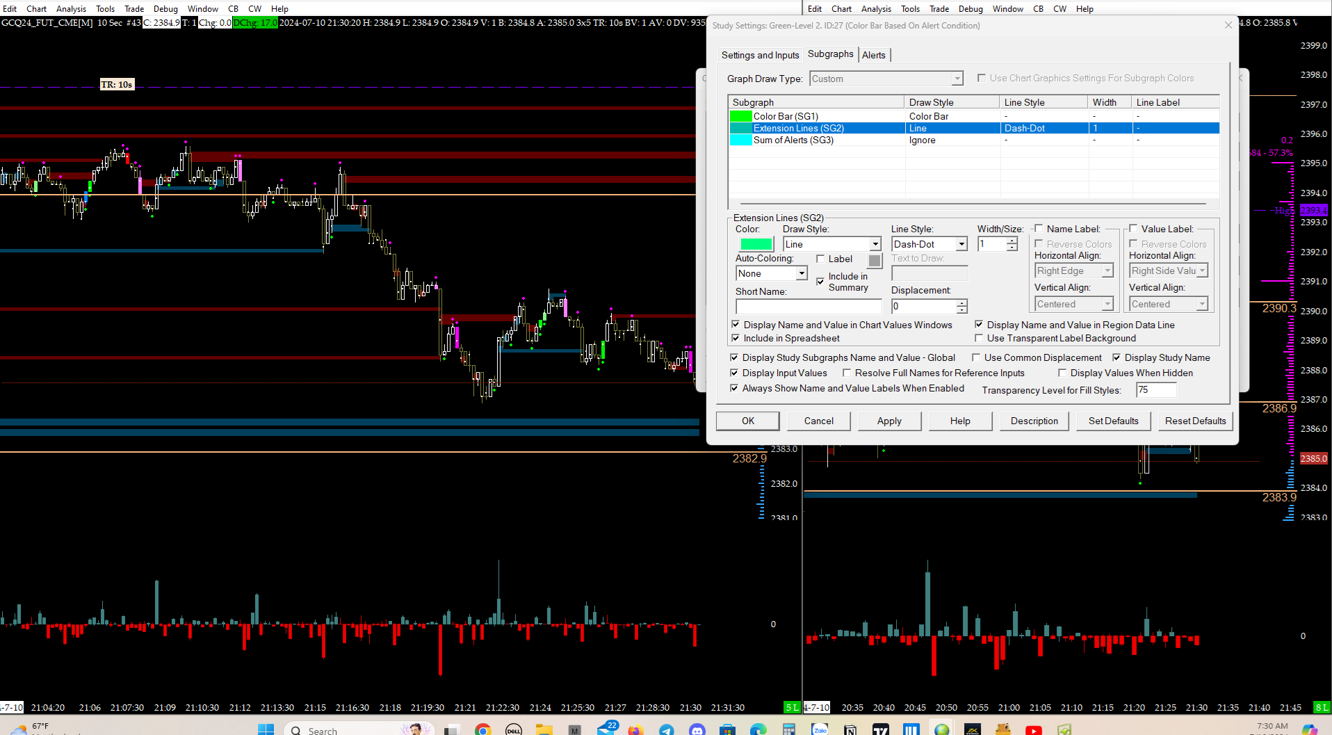

Thank you for quick response. I tried but it is not working. Pls give me advise |
Line under candle 1.jpg / V - Attached On 2024-07-10 14:33:12 UTC - Size: 177.55 KB - 35 views Line under candle 2.jpg / V - Attached On 2024-07-10 14:33:22 UTC - Size: 252.65 KB - 29 views |

Your "Output when Condition True" is set to "1.0". So the Extension Lines are being drawn at a value of 1.0. You need to change that to be where you want to see the extension lines. Refer to the following: Color Bar Based on Alert Condition: Output When Condition Is True For the most reliable, advanced, and zero cost futures order routing, use the Teton service: Sierra Chart Teton Futures Order Routing |
[2024-07-10 15:45:38] |
Lilydo - Posts: 14 |

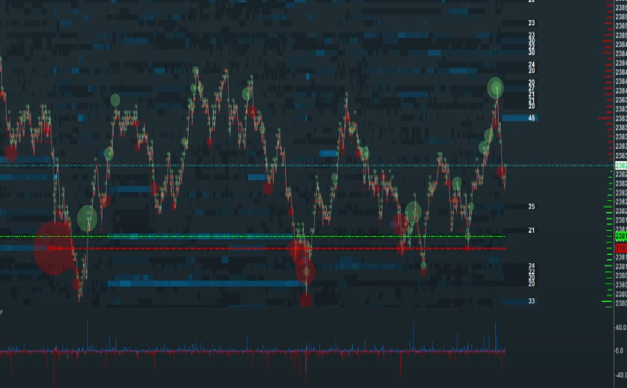

Hi John, I did it. I appreciate your support. How can I set up Large Volume trade Indicator follow tick? How can I set 1 line when bubble over 100? ( attached file) Thank you |
The documentation for the Large Volume Trade Indicator is here: Large Volume Trade Indicator There is not a way to get an extension line with the "Large Volume Trade Indicator", as this is not built into the study, and the information for the location of the markers is not exposed through the study. For the most reliable, advanced, and zero cost futures order routing, use the Teton service: Sierra Chart Teton Futures Order Routing |

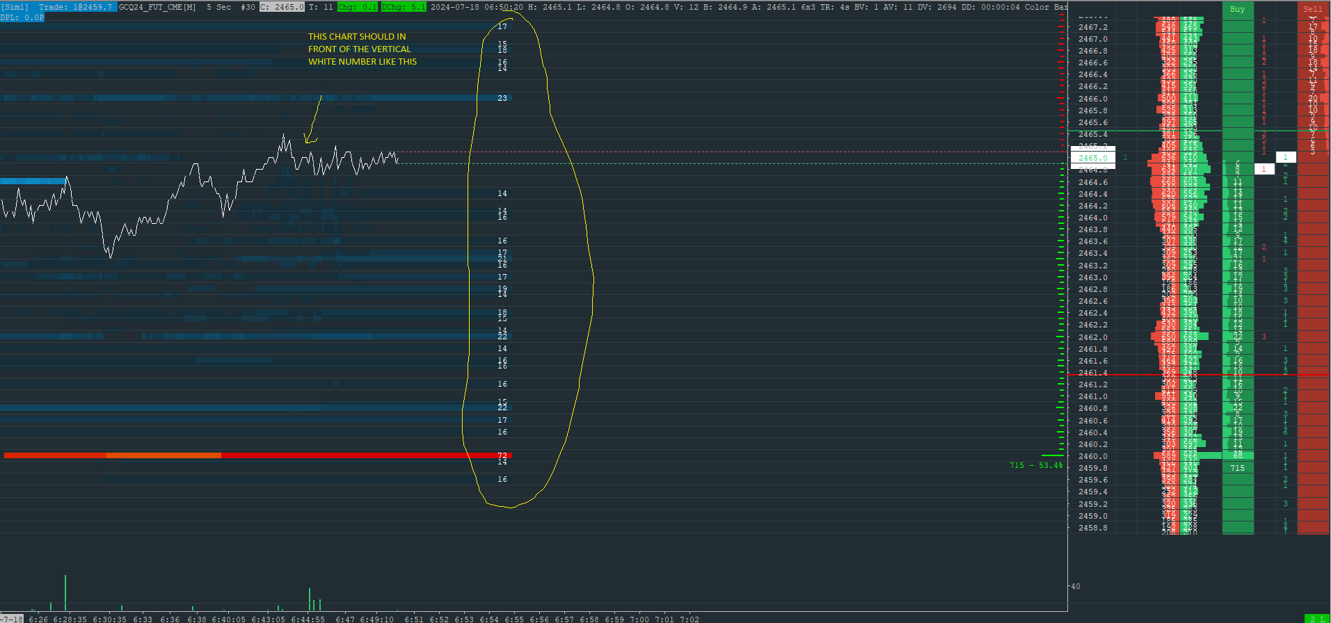

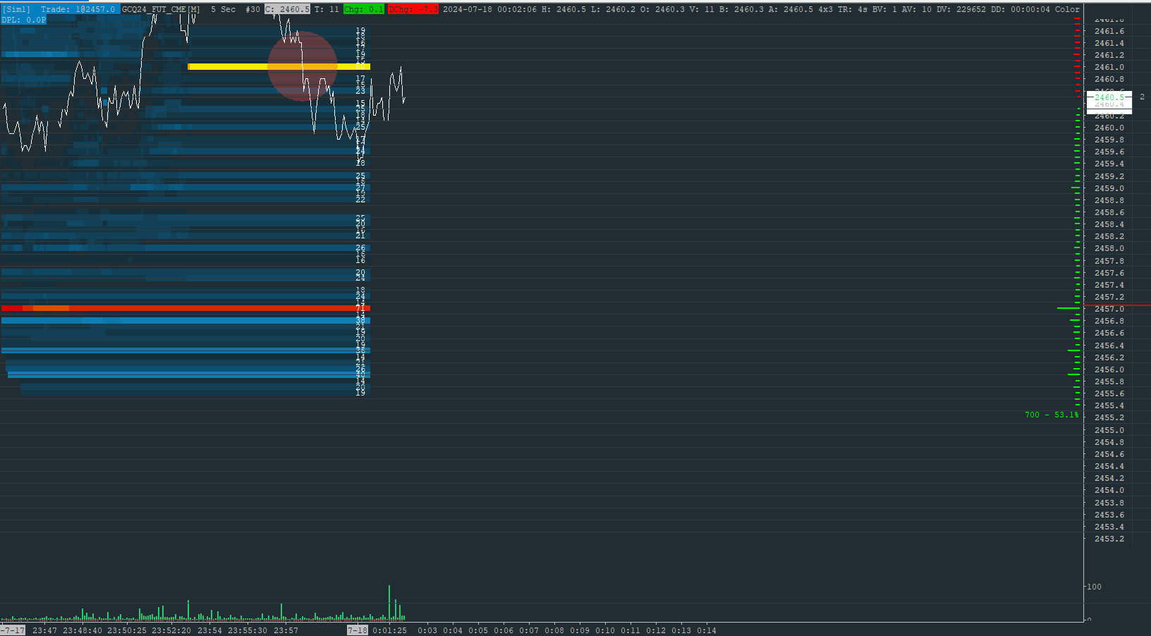

Hi John, Thank for your information. I will try another way. Do you know how to set the line chart always stands in front of the vertical number line. My chart is like the attached file. Thank you, Lily |
Heatmap.png / V - Attached On 2024-07-17 17:07:35 UTC - Size: 79.92 KB - 26 views |
[2024-07-17 17:25:21] |
We are not understanding. If you are referring to the Market Depth Historical Graph stopping and not showing on some of the more current bars, then this is due to not having the Market Depth data for those bars. Refer to the following (not Step #8 in particular): Market Depth Historical Graph: Downloading Of Historical Market Depth Data For the most reliable, advanced, and zero cost futures order routing, use the Teton service: Sierra Chart Teton Futures Order Routing |

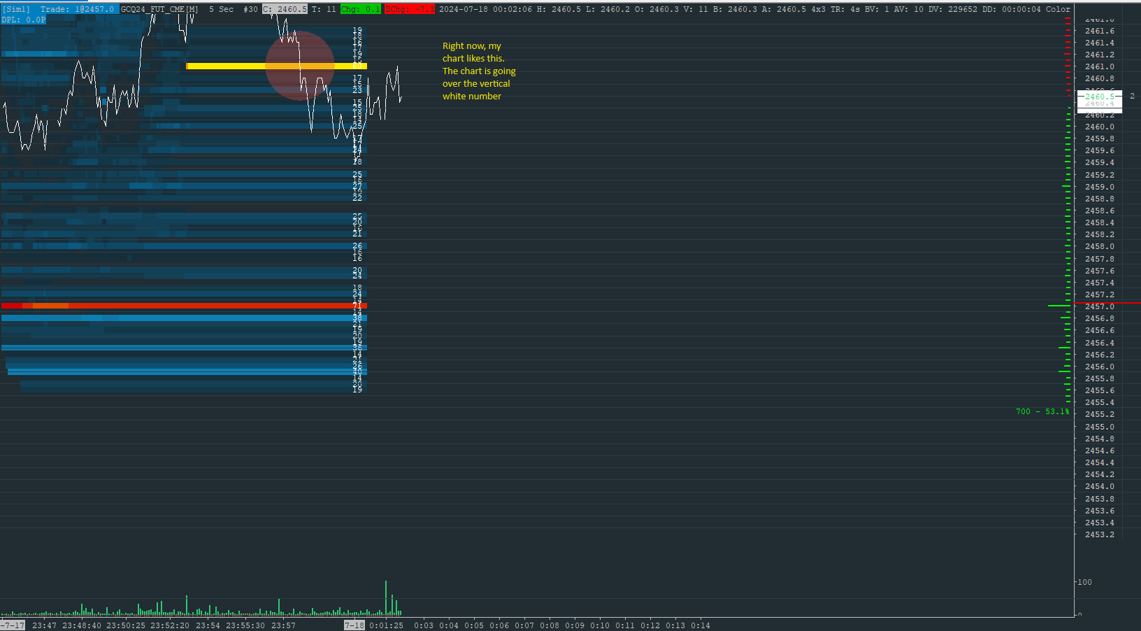

I'm sorry for not explaining clearly. Would you pls see these attached files and tell me how to set up the chart like this. The line on close chart is always in front of the white number vertical. Thank you, Lily |
Heatmap.png / V - Attached On 2024-07-17 23:56:33 UTC - Size: 95.94 KB - 38 views Heatmap1.png / V - Attached On 2024-07-17 23:56:41 UTC - Size: 157.68 KB - 28 views |
The Market Depth Historical Graph has an Input for "Show Quantity Numbers" in which one of the options is "Only After Last Bar". When choosing this option, there is another Input for "Percentage of Fill Space To Display Market Depth Quantity Rectangles In". You want to set this to a value that will put the numbers where you want them ahead of the bars. Refer to the information at the following link: https://www.sierrachart.com/index.php?page=doc/StudiesReference.php&ID=375#Market_Depth_Historical_Graph For the most reliable, advanced, and zero cost futures order routing, use the Teton service: Sierra Chart Teton Futures Order Routing |

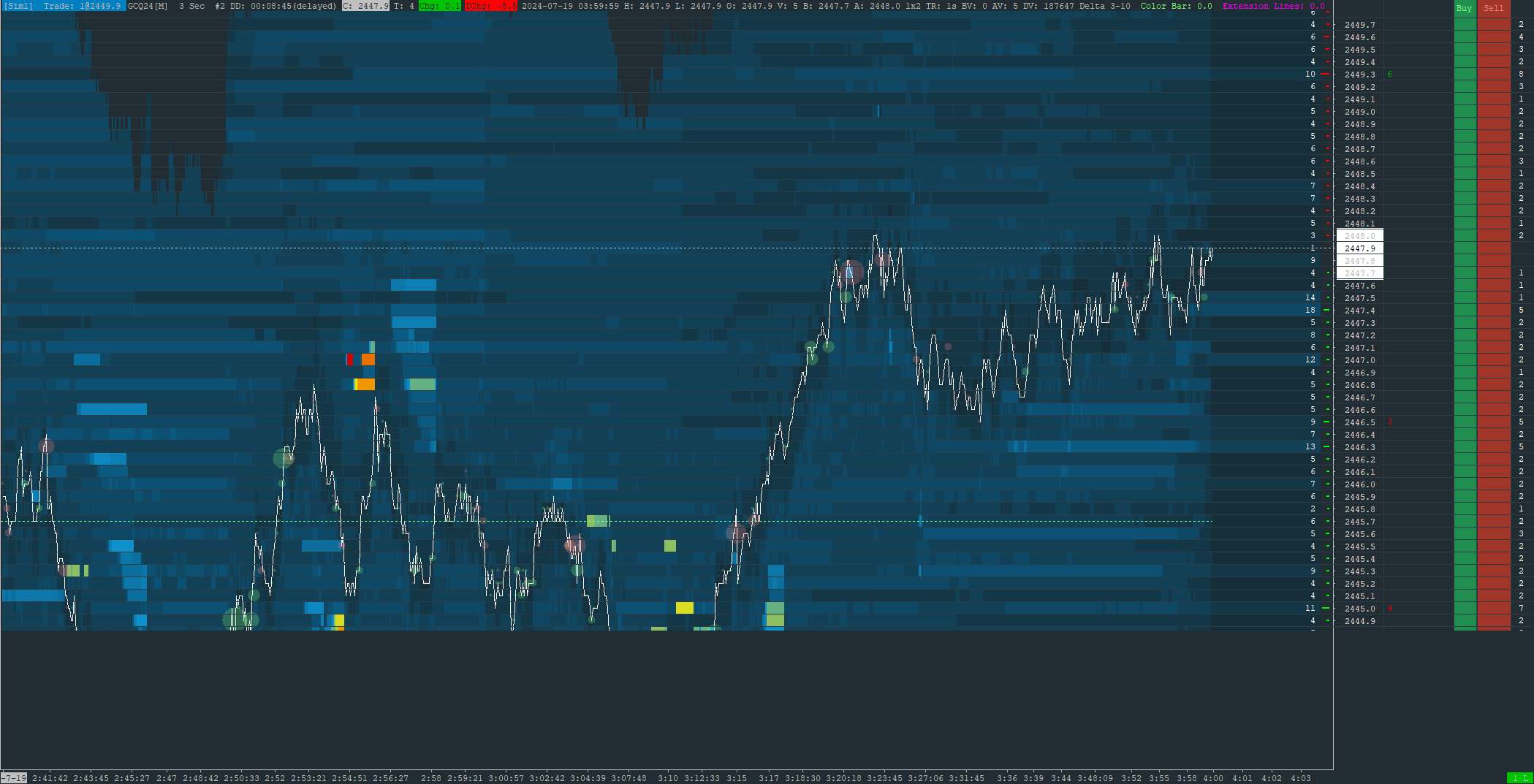

It is not working. The chart is still like this. The heatmap not following the price chart. I sent the study of heatmap setting. Pls give me your advises. Thanks |
Heatmap2.png / V - Attached On 2024-07-18 19:22:57 UTC - Size: 82.54 KB - 29 views Heatmap3.png / V - Attached On 2024-07-18 19:23:06 UTC - Size: 77.02 KB - 24 views |

We do not know. Everything looks good from what we can see. Please get us that chart by following these instructions: Support Board Posting Information: Providing Chartbook with Only a Single Chart For the most reliable, advanced, and zero cost futures order routing, use the Teton service: Sierra Chart Teton Futures Order Routing |

We can not find a reason why you are seeing the data like this. The attached image shows what we see. We did change the "Lowest Quantity for Coloring" and added a Bid/Ask Market Depth column to view that data relative to the Market Depth Historical Graph. But the data was showing in the correct location even without these changes, there just was not much to see due to some large Market Depth value such that even a 20% of maximum depth for the minimum was removing most of the data. Please do the following and then get us an image of your chart with this change: - Set the "Lowest Quantity for Coloring" to "0". For the most reliable, advanced, and zero cost futures order routing, use the Teton service: Sierra Chart Teton Futures Order Routing |
GCQ24[M] 3 Sec #2 2024-07-19 04_44_46.966.png / V - Attached On 2024-07-18 21:47:06 UTC - Size: 92.81 KB - 26 views |
