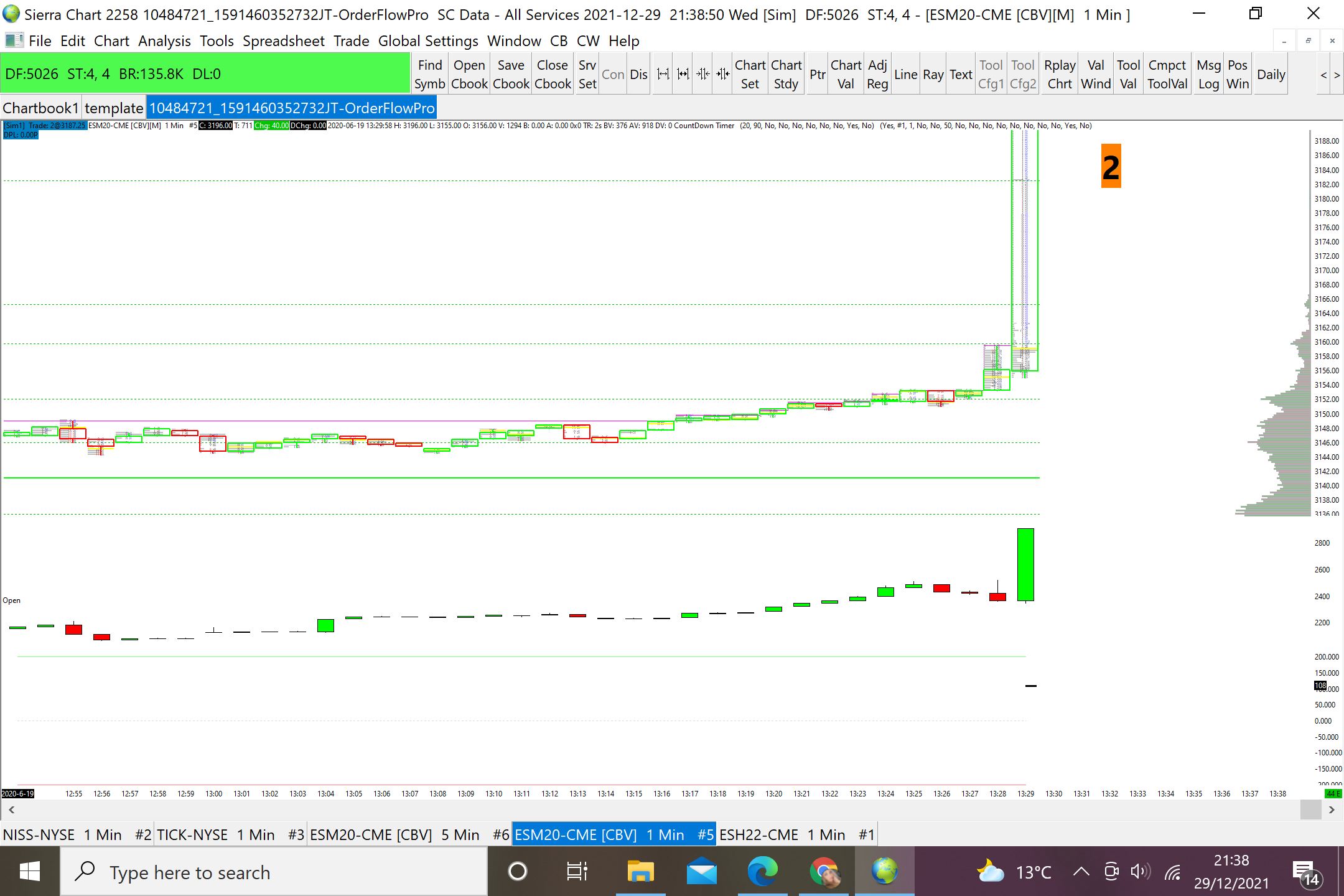

Okay thanks guys. So I changed the filename back to .cht, put it into C folder sierra data, opened the chartbook, loaded the ESH22-CME and then translated the symbols to current service. So it looks like something has loaded but each indicator displays at the bottom of the tab seperately and even then its not sized to fit the screen. I will attach a screenshot, as you can see it shows order flow but its all in seperate tabs, it isn't moving with the time (the timer is static) and it isn't fitting the screen (I can't see the order numbers within the candlesticks). Could you give me advice on how to integrate them all into a single chart and fit the screen so that I can see the orders? Also I understand that it's delayed data, but how comes its static altogether?

In the image you gave us, that is just the way that the person setup their chart. There are three regions with different indicators in each region of that chart. Refer to the following regarding regions:
Working With Charts: Chart Window and Regions
The top region has a Numbers Bars study on it, which tends to be hard to read due to the depth of the information in it. Refer to the following for information on scaling the Numbers Bars:
Numbers Bars: Scaling a Numbers Bars Chart
As to the chart being static - that is most likely due to your just having downloaded the historical data for that chart. As such, it actually downloads up to the current time. Therefore, you would need to wait 10 minutes for the delayed data to "catch up" to the data in the chart and then start printing forward in time. Just be careful, as in 13 minutes the CME stops for an hour, so don't be too impatient.
[2021-12-29 22:58:16]
Katherine Szewczyk - Posts: 8
Ah thanks John! You've been super helpful. Everything is working now. I will get back in touch if I need any more help. Have a good day.
