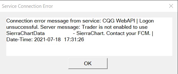

Hi there,
I got CME Non-Professional Certification and activated Denali Exchange Data Feed Exchanges, but the chart was delayed 10 min. I tried to connect Sierra Chart to my live trading account and I got this notice. I am trading on CQG platform through Mercantile Exchange of Vietnam and my Uniform Subscriber Agreement has been accepted.
imageCQG account not connect Sierra.jpg / V - Attached On 2021-07-18 17:56:52 UTC - Size: 28.64 KB - 218 views
[2021-07-19 03:30:32]
You need to contact your broker for help with getting connected to CQG to authorize the CME real-time data. For more information about the connection problem, refer to:
CQG Trading Platform Service: Common Error Messages
The reason you are not getting real-time data from the CME Group of exchanges is that you activated the Non-Professional exchange fees, but you have not verified that you have a live, funded, futures trading account, which the CME needs in order to allow you data at the lower priced fees.
Refer to the following for instructions on how to connect once a month to your *live funded* trading account to qualify for the lower-priced exchange fees:
If you do not have a funded trading account or one with a supported trading service, then refer to this solution:
Easy Solution to CME Funded Trading Account Requirement
We recommend using the above solution in any case to avoid this problem in the future.
