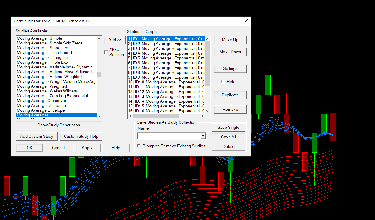

1.currenlty i have created bands/ribbons on a flex renko chart by having mutliple moving average studies..see 1st attached file
2.The Red Ribbons are calculated off the closing price of the renko bar.

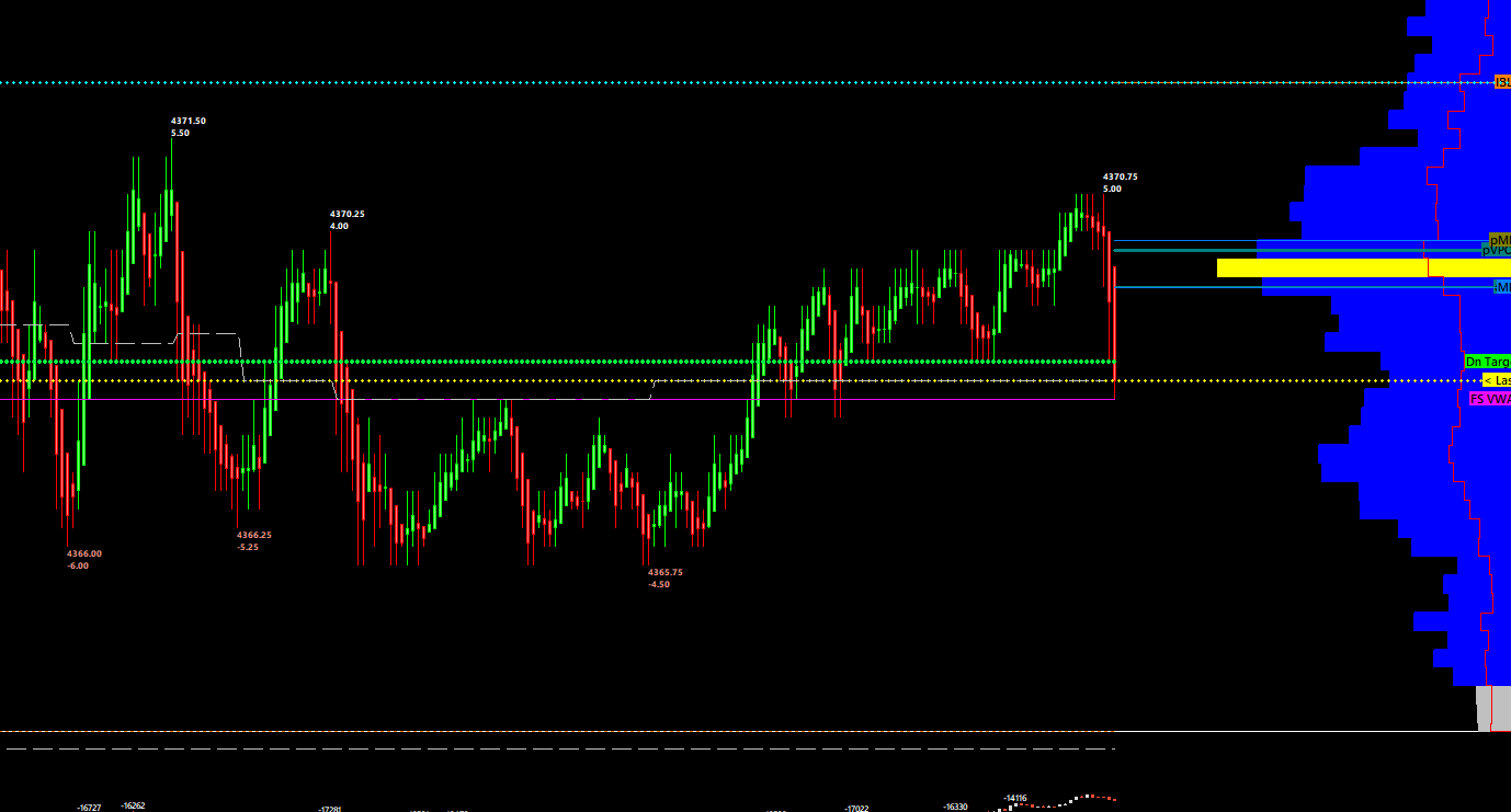

3.I also have a chart that i use that is based of of volume per bar (1000) and use the heiken ashi study - see 2nd attached file - (under chart settings i have the graph type as blank)
4. I want to overlay the ribbons from thr renko chart onto the volume chart. I currenlty have 24 individual ema's on the renko chart...and when i do a study/price overlay it does not work..the chart gets tons of lines all over it.
So my question is 2 parts...1. can i create a study that has indivdual ema's in it and then can i overlay that study from the renk chart onto the volume chart.
I am sorry if I am not being clear...essentiall i want the ema ribbons and their values from the renko chart overlayed on the volume chart
imagemoving average bands.PNG / V - Attached On 2021-07-14 21:10:29 UTC - Size: 88.25 KB - 203 views
imageheiken ashi.PNG / V - Attached On 2021-07-14 21:18:51 UTC - Size: 43.49 KB - 208 views

You should be able to overlay the EMAs from the Renko Chart to the Volume Chart using the Study/Price Overlay study. You would need to use one Study/Price Overlay for each EMA line you want to copy.
What do you mean by "when i do a study/price overlay it does not work..the chart gets tons of lines all over it."? Have you just tried one to start and make sure that you have that setup the way you want? Keep in mind that the system tries to match up the data based on the time of the bars, so you will have to work with the options in the Study/Price Overlay to make sure you are getting what you want. In particular, the Data Copy Mode and the Bar Time Matching Method. Refer to the information here:
Study/Price Overlay Study
