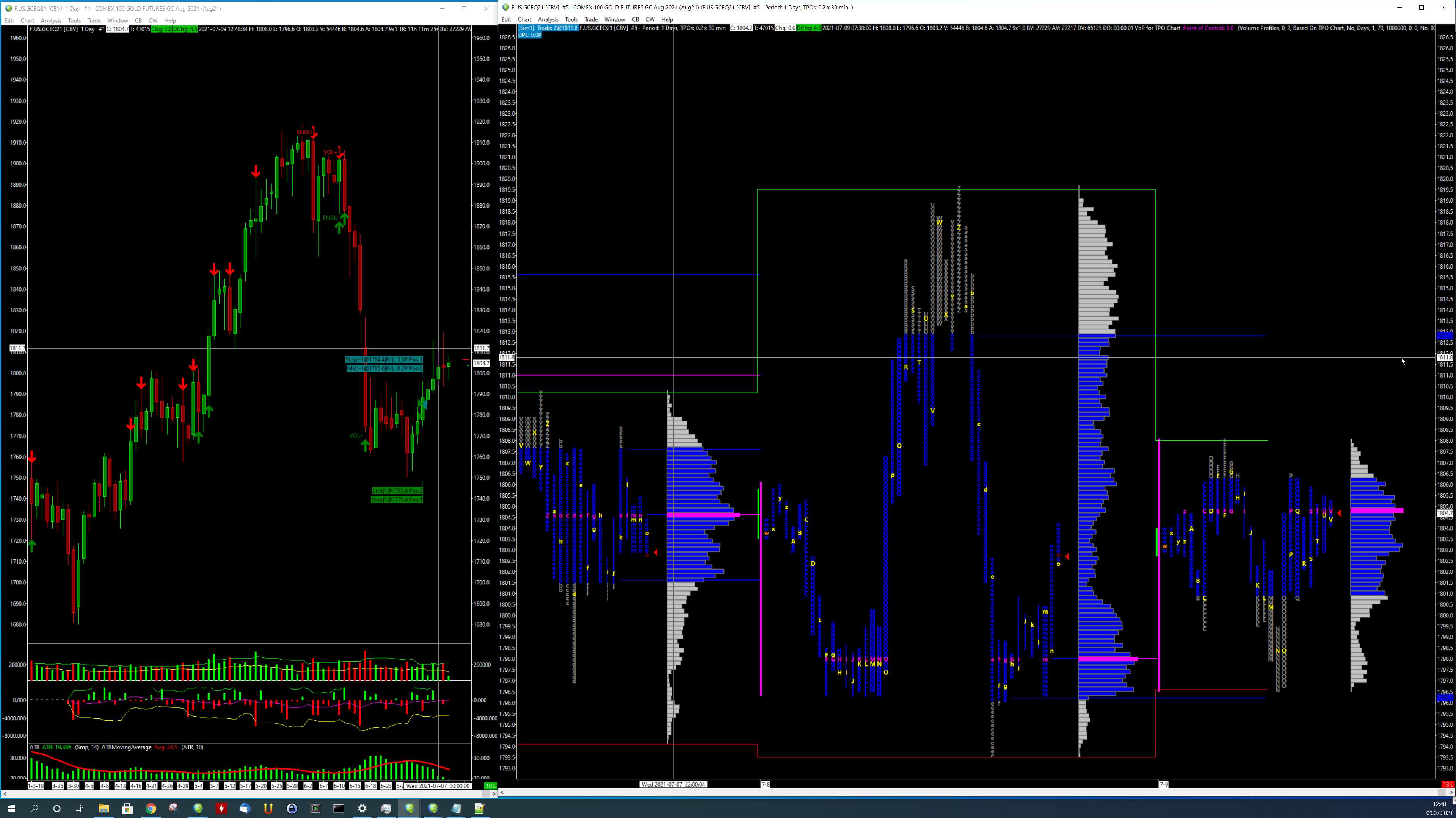

I try to export Bar and Study Data of a chart for further analyse.
I have a TPO Chart incl. POC, Value Area Low High and so on.
But all data regarding TPO (Value Area, POC) are missing in the export file?
Why are they missing?
See screenshot and a part of the export file?

[2021-07-09 15:33:18]
John - SC Support - Posts: 42737
You can not export the TPO data.

[2021-07-09 16:08:27]
User230940 - Posts: 121
I think I found it. It is the TPO Chart.
I put the study to a normal candle chart I now it seams to work.
[2021-07-09 17:09:49]
Did you mean the TPO Value Area Lines? You add that to a normal candle chart and then you can export those. Refer to the following:
