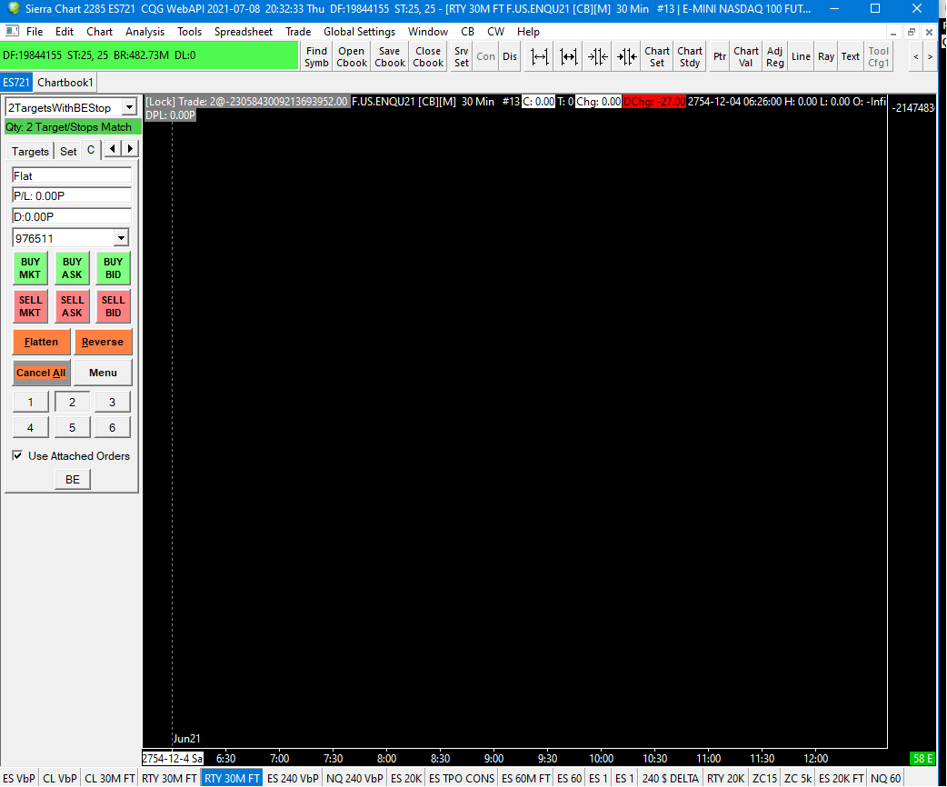

Running Numbers Bars on NQ and started receiving this error after changing the tick calculation settings. Tried changing it back and saving a new chartbook to keep the one I didn't screw up, still receiving the error and noticing lag in the program.

Looks like its loading infinite numbers. Don't know how i did that, don't know how to change it back.

imageNQ.png / V - Attached On 2021-07-09 00:36:50 UTC - Size: 39.99 KB - 218 views

What you sent to us does not have any studies on it, therefore it would appear to just be a scaling issue. Right click on the right-hand side scale and select Reset.
Let us know if you continue to have an issue.
