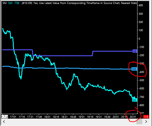

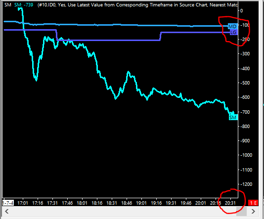

                Hello. So this chart I built is a little complicated so please bare with me. It's a chart with 4 different cumulative delta bars (volume) overlaid studies that each display a different tape range. For example, cum delta bars (volume) line 1 shows blocks 1-14, cum delta bars (volume) line 2 shows blocks 15-49, and so on. In the chart screen shots below both are taken at the same time and date. The problem is that the MD labeled line changes values based on my scrolling  up and down the chart. The other labeled lines SM & LG remain at constant values when I scroll up and down the chart. I'm well aware this explanation is confusing, please let me know if further detail is required. Also, the images below aren't "regulation" for uploading chart pictures, but i was unsure how else I could get my point across. Thanks.  |

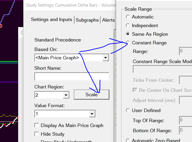

                You could check the scale for the MD overlay study. It looks like it could be set to independent scaling rather than same as region?

                yeah unfortunate that didn't work. The most confusing part is I tried duplicating the charts (sm or LG) that didn't change values when moved and then changing it to my MD tape range and still had the same issue.
