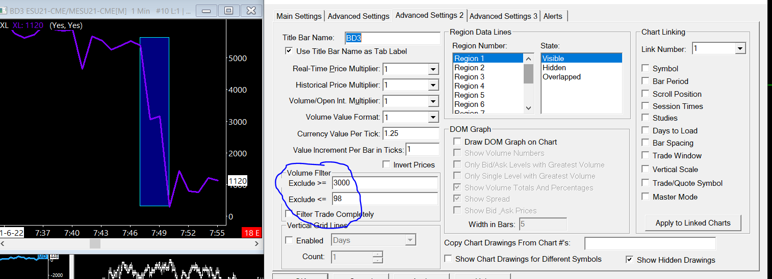

                Hello, I recently built a cumulative delta chart for blocks 99+ with the "combine trades into original summary" setting on - I'll post an image below of the settings as well as the chart. On the chart I highlighted the time frame 7:47-7:50 where it said the 99+ cumulative delta was going down. I'll also post an image from my recording from that day where my tape shows the 99+ delta being cumulatively positive if you add it up. what's wrong with my chart? Please let me know if more clarification is necessary.  |

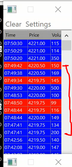

                Here is the image of the tape from that day and the time 7:47-7:50. I also made sure that my tape also runs under the settings "combine trades into original summary".

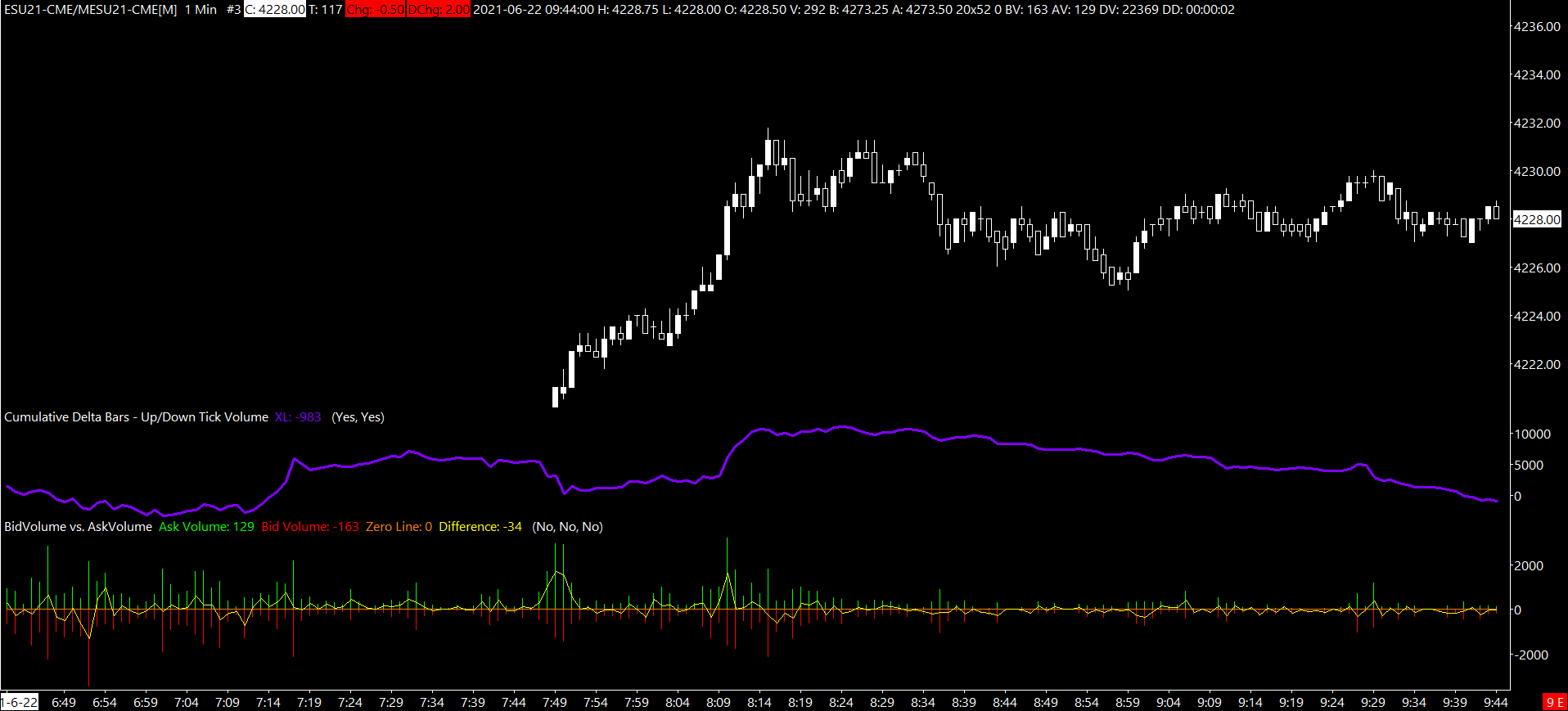

                I am convinced there is an issue so I have done everything you have asked above. please let me know if further clarification is needed. http://www.sierrachart.com/image.php?Image=1624837103187.png  |
|   [2021-06-28 00:07:40]     |
                That chart does not meet our requirements and we have no idea what study you are looking at. It does not look like Cumulative Delta Bars-Volume. It could not be at all because of the fact that, there is a change in value when there is no bid volume or  ask volume.   Filtering out all trades below a volume of 100 and combining into the original summary trade, this is an example of what we see: http://www.sierrachart.com/image.php?Image=1624838712357.png Something clearly is wrong with the configuration of that chart and studies that you have. Sierra Chart Support - Engineering Level  Your definitive source for support. Other responses are from users. Try to keep your questions brief and to the point. Be aware of support policy: https://www.sierrachart.com/index.php?l=PostingInformation.php#GeneralInformation For the most reliable, advanced, and zero cost futures order routing, *change* to the Teton service: Sierra Chart Teton Futures Order Routing Date Time Of Last Edit: 2021-06-28 00:08:14

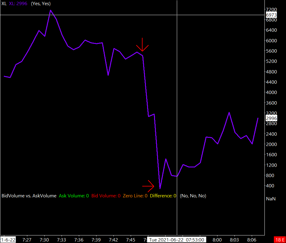

                Here is the chart so that it is designed like the one above: http://www.sierrachart.com/image.php?Image=1624846668482.png what I'm trying to achieve is a chart with the cumulative delta of blocks 99+, with no price chart visible - like the first image. Date Time Of Last Edit: 2021-06-28 02:18:19
