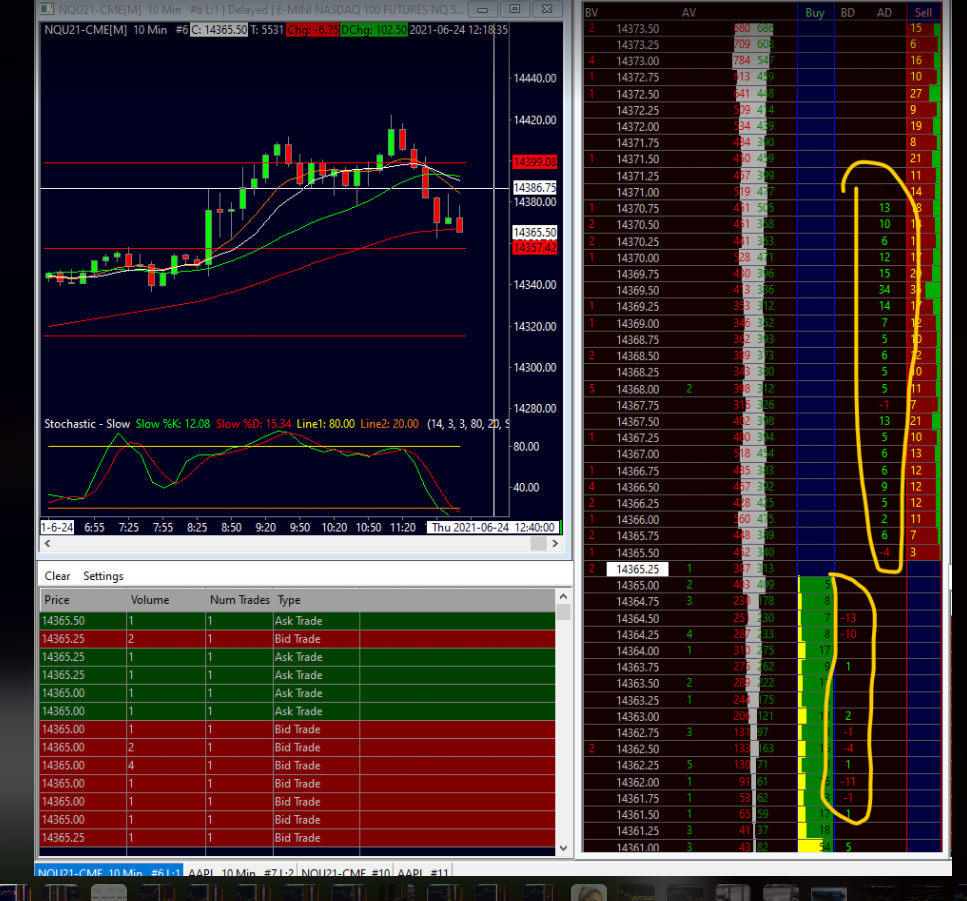

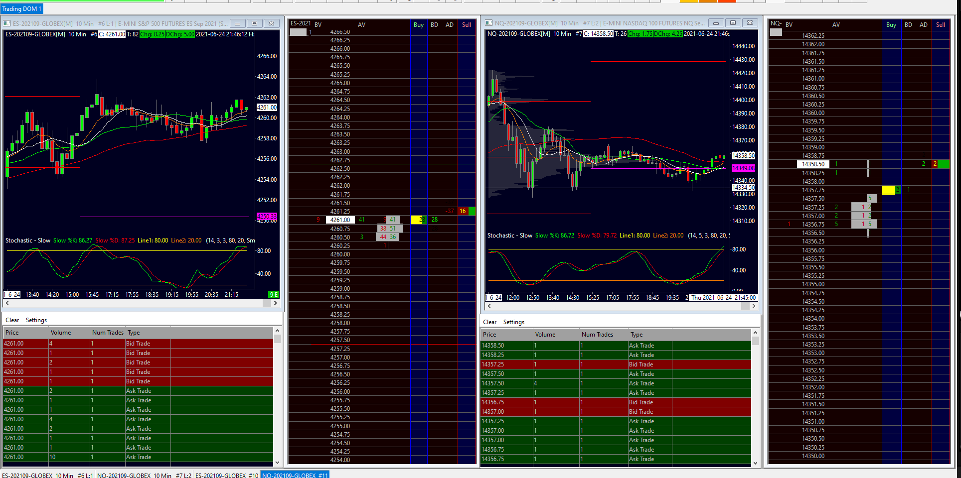

Hi. I set up my Trading Dom but now I can not see some data. Like ASK/BID pulling/stacking. It looks like just Level I data. But all that happened after I got connected through IB Brokers. Can u help? I used to see it like is it on picture 1. Now I see it like it is on picture 2. Can you tell me where is the problem? Thanks
imageScreenshot 2021-06-24 215042.png / V - Attached On 2021-06-25 17:59:31 UTC - Size: 426.82 KB - 216 views
imageScreenshot 2021-06-24 214755.png / V - Attached On 2021-06-25 17:59:39 UTC - Size: 193.16 KB - 202 views
[2021-06-25 18:48:17]
John - SC Support - Posts: 42737
What is File >> Data/Trade Service Settings >> Current Selected Service set to?
And also on that same window under Common Settings what is the Allow Support For Sierra Chart Data Feeds set to?
[2021-06-25 19:08:28]
User850090 - Posts: 27
It is on YES.But it is working now. I had to pay for CME market depth.
What do I have to activate to get market depth for US stocks? Thanks
[2021-06-25 20:50:32]
Our US Equities exchange (to which you are subscribed) does not have the Level 2 market depth data. We are working on a new interface that will have this, but it is probably a month or so away.
In the meantime, the best we can offer is the IQ Feed which has the Market Depth available in a separate application. Refer to the information here:
DTN IQ Feed Data Service
