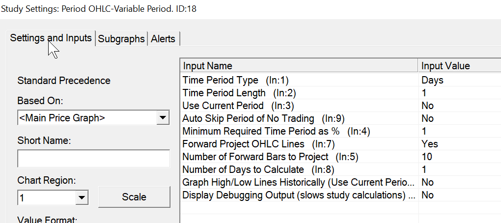

I am trying to plot yesterday's RTH high, low, close.
The study in use is Period OHLC-Variable Period.
I've ignored the "open".
The high and close are correct showing the previous RTH levels but the low is very far off the RTH close.
Is this the correct study to indicate the previous RTH's high, low, close?
Please check my configuration. See enclosure for my configuration.
Date Time Of Last Edit: 2021-06-25 15:09:28
image2021-06-25 09_56_20-Study Settings_ Period OHLC-Variable Per.png / V - Attached On 2021-06-25 15:07:36 UTC - Size: 32.96 KB - 409 views
[2021-06-25 16:30:48]
John - SC Support - Posts: 42737
This is one of a few studies that can be used for what you are looking for. Although this study is going to use all the data in the chart and not just the RTH. So if your chart is both RTH and Evening session, then it is going to give you the information for the entire trading day.
You may want to use the Daily OHLC instead, which can be set to just give you the RTH results. Refer to the information here:
Daily OHLC
