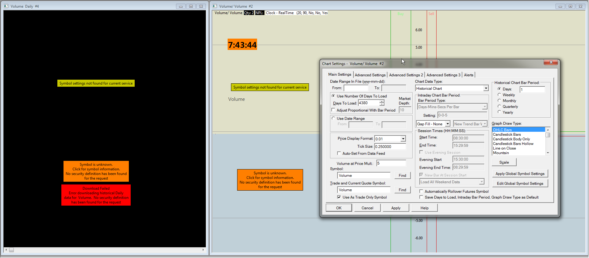

                This is a intraday ES chartbook i've been using for months/years. ES symbol switched for "Volume symbol" : ???? See attachment  |

| John - SC Support - Posts: 42737 |
                We have another report of an issue like this and we are looking into it. For now, update to the latest Pre-Release and disable the option for Global Settings >> Symbol Settings >> Use Custom Symbol Settings Values. Let us know if you have an issue after you do this.

| User877753 - Posts: 152 |
                For now, I've rolled back to 2276 and restored backup charbooks : works fine. Will try later your suggestion, thanks.  |
                What version were you on previously where you had the issue?
                2278

| Sierra_Chart Engineering - Posts: 21299 |
                The issue is not specific to a particular version. We do not know what the scenario is which causes this. Although it could not be specific to a particular version. We have one possible idea of why it could occur, but it is a scenario which should just not occur. Sierra Chart Support - Engineering Level  Your definitive source for support. Other responses are from users. Try to keep your questions brief and to the point. Be aware of support policy: https://www.sierrachart.com/index.php?l=PostingInformation.php#GeneralInformation For the most reliable, advanced, and zero cost futures order routing, use the Teton service: Sierra Chart Teton Futures Order Routing  |
