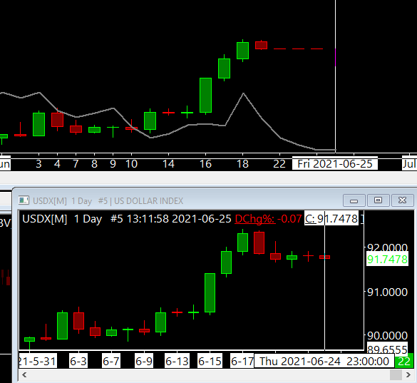

USDX showing blanck days on 1d hist. and doesnt show the last trading day on 24h

                Hi SC team, I think this started not long ago as I have this chart for a while now. USDX on the top panel as you easily can see is not showing the last 3 candles and the current one is not correctly showing todays action as it is only a line The second panel shows the USDX with a 24h chart. This one, as you can see from the cursor does not show the current day(fri) at all. On and hourly candle and other smaller timeframes the USDX shows no problems. It only happens when I try to make it display it on a daily format, at least for me. I did not try all TF's. I have used this method of sharing an image because I needed to show the 2 different charts of the same daily candle(1D historical and 24H) Please some help would be very much welcome Thank you  |

| John - SC Support - Posts: 42737 |

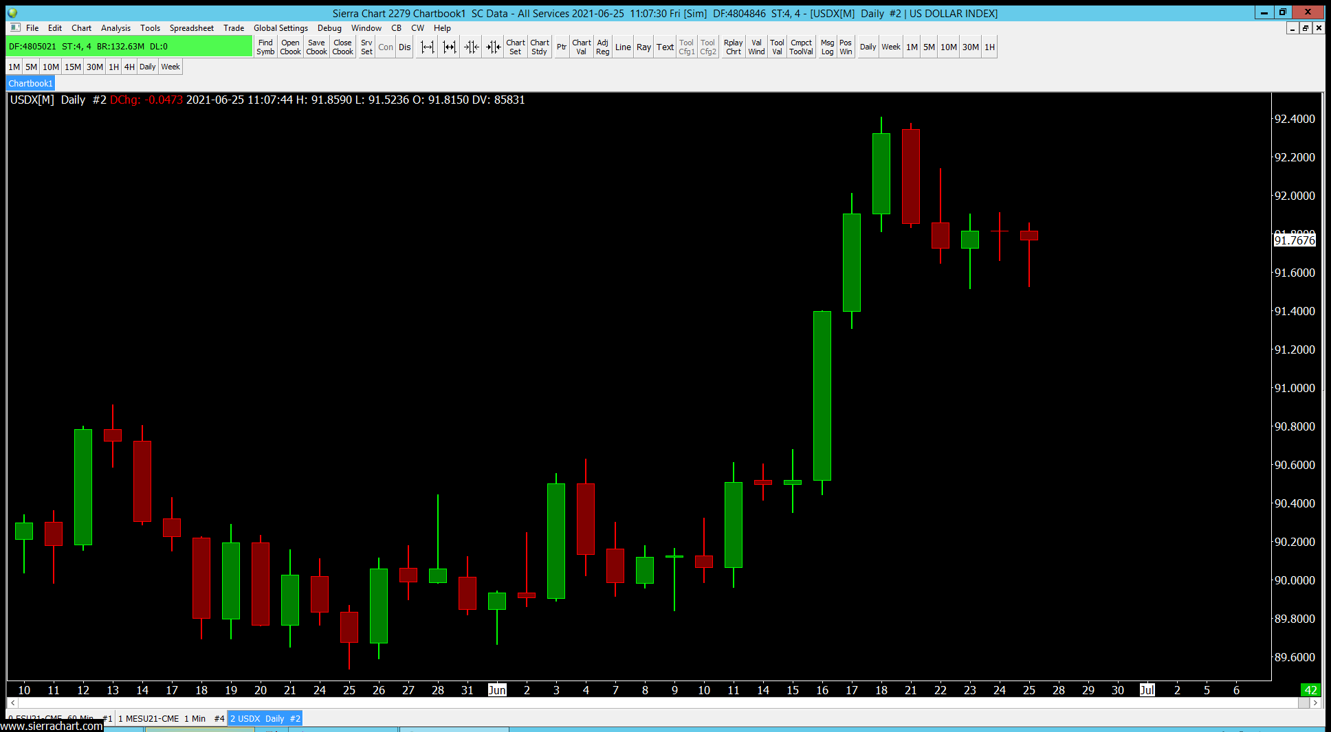

                Let's start with the Intraday chart. That one is correct. The date is showing yesterday due to your Session Times. You must have an Evening Session set. The trading day then starts with the beginning of the Evening Session. As to the Daily Historical chart, there is something not quite right. Here is what we see: http://www.sierrachart.com/image.php?Image=1624637265120.png Try redownloading the data by following these instructions: https://www.sierrachart.com/index.php?page=doc/helpdetails6.html#h6.3 For the most reliable, advanced, and zero cost futures order routing, use the Teton service:  Sierra Chart Teton Futures Order Routing  |

                Hi John, Thanks for the fast reply. Deleting the data and downloading it worked via the menu on a new seperate chart for USDX . I had done this on the chart itself(right click) but I am guessing it didnt work correctly, or as I wanted it, because the USDX symbol was on a panel added with add additional symbol study. I think I therefor was redownloading the data from the main chart. Does that make sense? Thanks again John for the fast one.  |

                Yes, you would need to redownload the data on a chart that has that symbol as the main symbol. It would not force a redownload for an Add Additional Symbol study.
