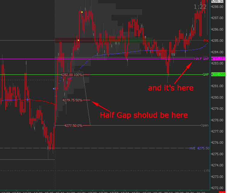

                Hello again! I am making a GAP and HALF GAP formula which calculates the gap and a half gap from the closing and opening of the current day, the formula for the gap = (ID0.SG4@4) and for the HALF GAP = ( ID0.SG4 @ 4 + ID0.SG1 @ 3) / 2 the problem is that the formula only applies when the GAP will be above the price and not below surely I am doing wrong, could you help me to make the calculation correctly! Thank you  |

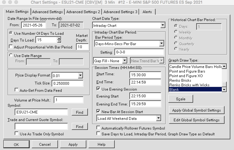

                For the Gap line, do you want to plot the value of the previous RTH close? For the Half Gap line, do you want to plot the midpoint between the previous RTH Close and the current RTH Open? What is the time of the previous RTH Close you are using for the Gap? Please post a pic of your chart's Chart Settings >> Main Settings tab  |
|   [2021-07-03 20:01:12]     |
| Hopeman - Posts: 166 |
                For the Gap line, do you want to plot the value of the previous RTH close? - YES For the Half Gap line, do you want to plot the midpoint between the previous RTH Close and the current RTH Open? - YES What is the time of the previous RTH Close you are using for the Gap? What is the time of the previous RTH Close you are using for the Gap? 22:14:59  |

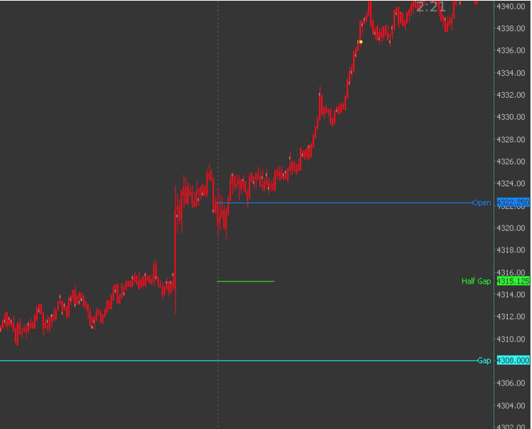

                To extract the previous RTH Close, try this: Cell R3: =IF(MROUND(FRACTIME(A3),1/86400)=TIMEVALUE("22:15:00"),E4,R4) This will round the Time of the DateTime to 1 second, and compare it to the timevalue of 22:15:00. If they are equal, it will persist the Close of the previous bar until the next 22:15:00. This is the Gap line. Set the Draw Style to Dash. To calculate the Half Gap, use two more columns: Cell S3: =IF(MROUND(FRACTIME(A3),1/86400)=TIMEVALUE("15:30:00"),B3,IF(MROUND(FRACTIME(A3),1/86400)=TIMEVALUE("22:15:00"),0,S4)) This will extract the RTH Open and make it persistent until the RTH Close. Set the Draw Style to Hidden or Ignore. Cell T3: =IF(S3>0,AVERAGE(R3,S3),0) This is the Half Gap line. Set the Draw Style to Dash.  |

                Now it works fine Sir !! but I can't understand why it doesn't work with a simple form if I change the seconds to the exact time which do you think it might work fine? Thank you so much Date Time Of Last Edit: 2021-07-04 10:44:08
|   [2021-07-04 11:35:02]     |
| Sawtooth - Posts: 4285 |
                Sometimes you have to round the time to remove floating point errors. Using the Spreadsheet Study: Imprecision of Floating-Point Numbers and Comparisons Working with Spreadsheets: Floating-Point Values and Comparisons When Using the Spreadsheet Study Spreadsheet Functions: Serial DateTime Values  |
