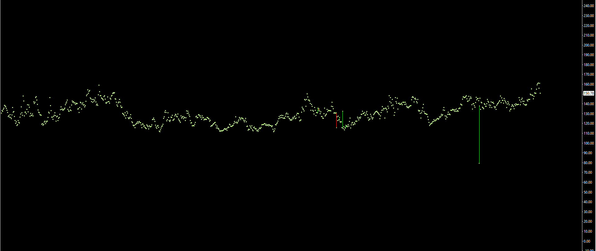

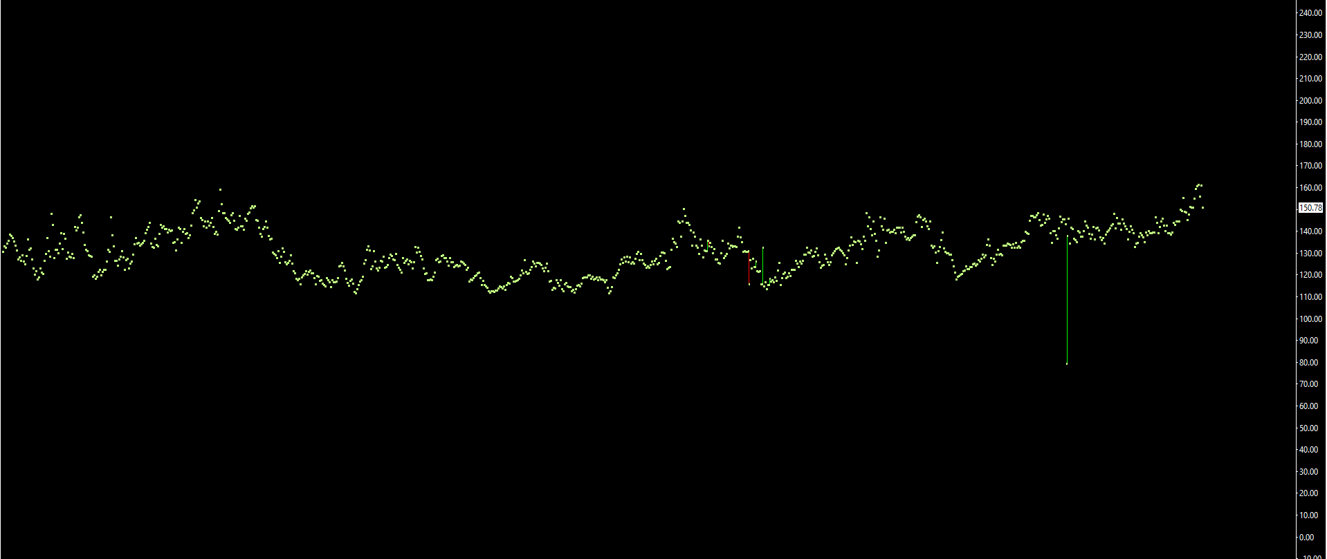

                Still waiting on response above! And also why am I getting weird looking data for the symbol $SKEW (see screen shot attached), setting for symbol is set to OHLC bars. How do I fix that?
                 Date Time Of Last Edit: 2021-06-21 16:07:09
|   [2021-06-25 05:17:46]     |
| Sierra_Chart Engineering - Posts: 21301 |
                Regarding post #41, we did find the information and restored the list of symbols. They are listed here: https://www.sierrachart.com/index.php?page=doc/SierraChart_RealTime_And_Historical_Symbols.php&SymbolsPage=Indices#INDEX We do not provide any technical support for those symbols. You just have to accept the data they provide. And also why am I getting weird looking data for the symbol $SKEW (see screen shot attached), setting for symbol is set to OHLC bars. How do I fix that?
The data is what it is. If that is what you see, that is what is provided.
