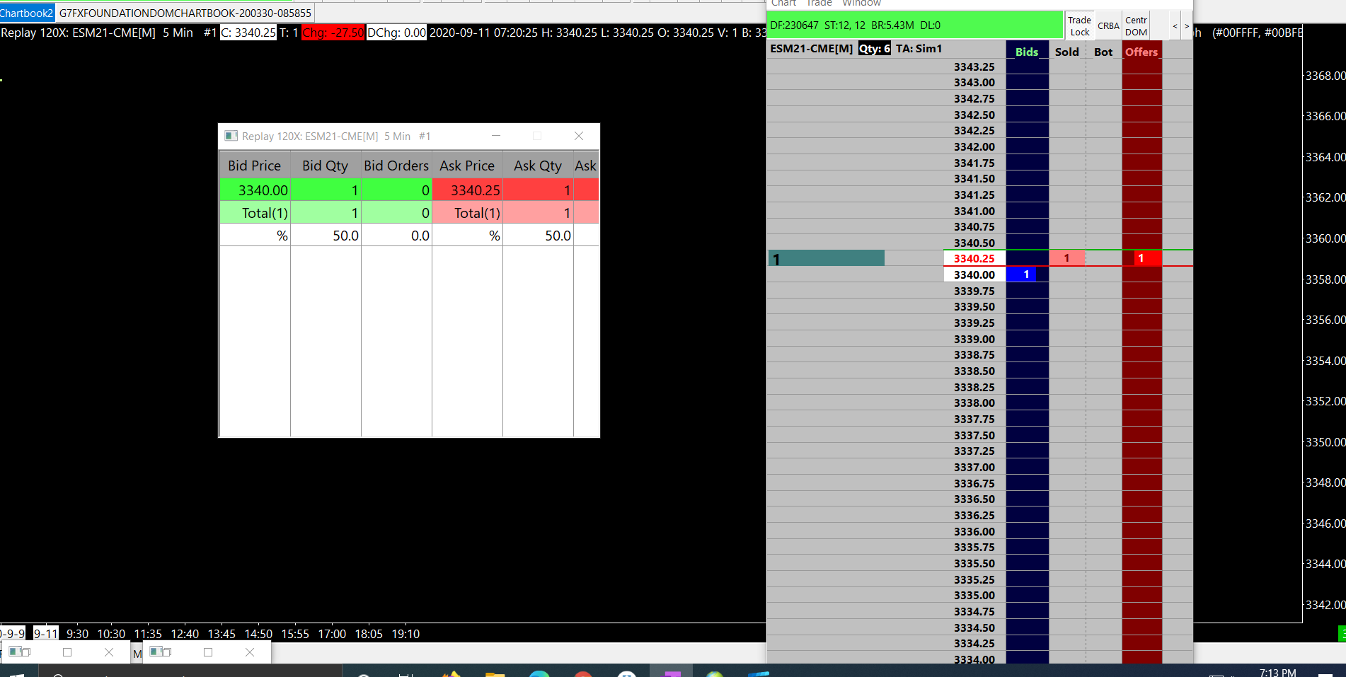

Hi
I am currently on Service Pack 11 withe Denali feed.

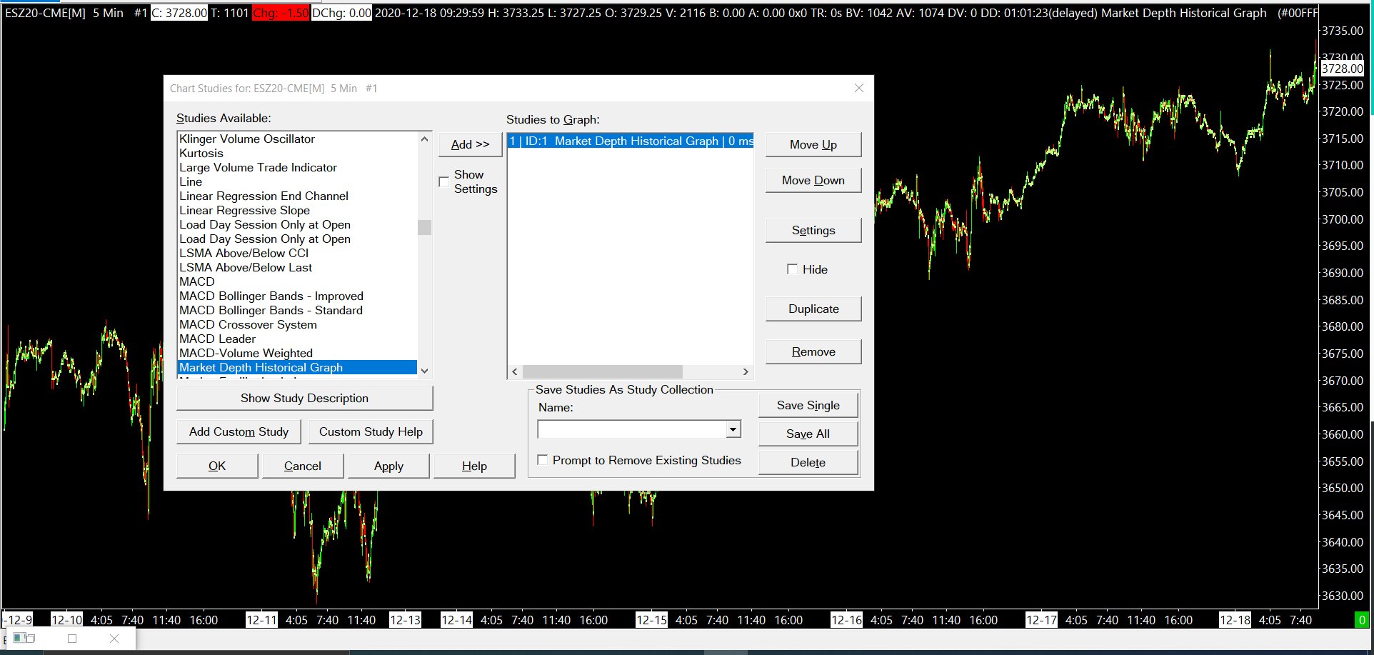

When l replay DOM l only get the number 1 appearing in the volume - see attachment labelled pic1.png. This is what l did.

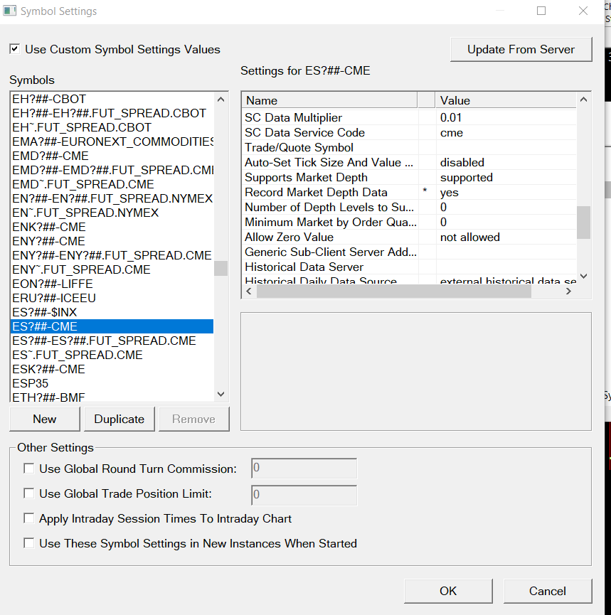

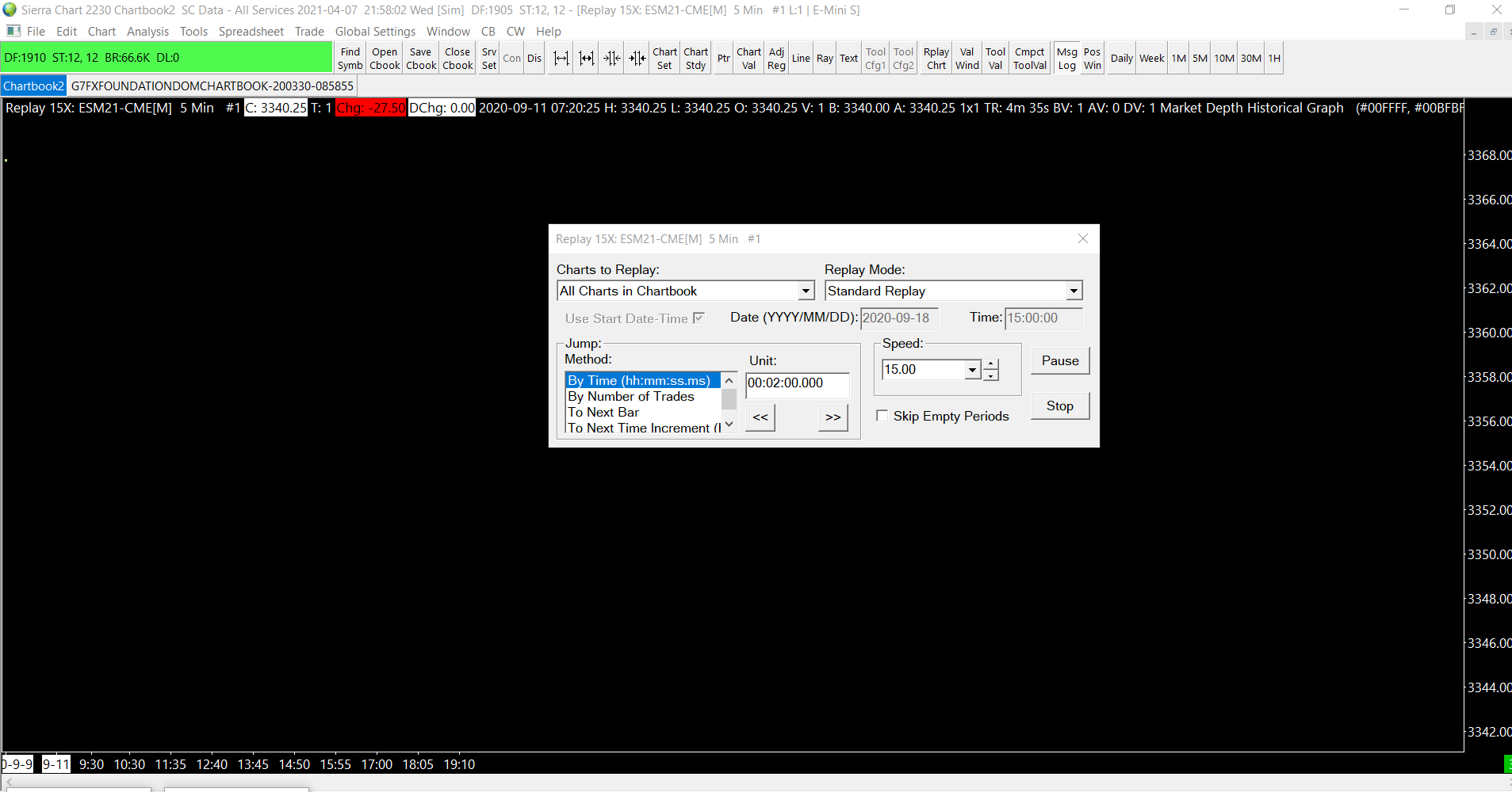

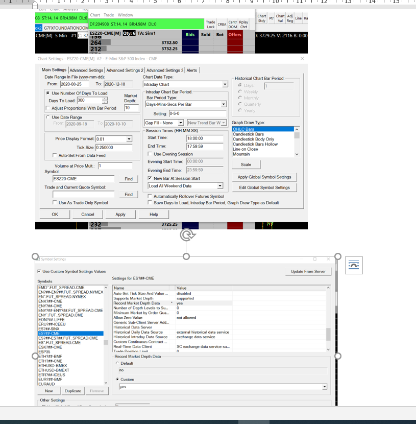

(a) I then loaded 300 days worth of data. See attachment pic2.png. Also on this screenshot l added the relevant futures symbol for the date l required.

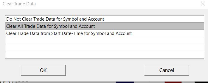

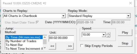

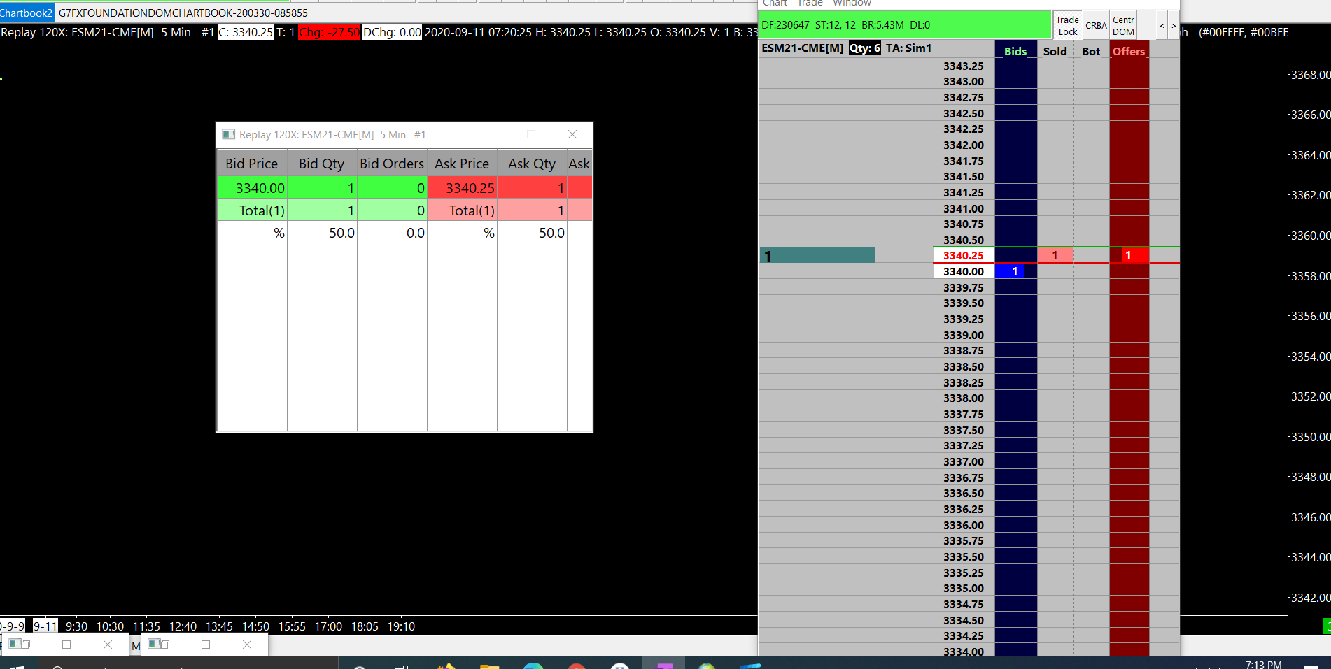

(b) l then ran a replay for a particular date which falls within the specified number of days (300), see pic3.png.
I still get the same error message.
Please advise

According to your images, you were in the middle of the Replay when you made the changes. You definitely have the right idea in terms of making sure that the Trading DOM has the number of days loaded going back at least as far as the replay you want to run. But this is not something you can change in the middle of a replay.
Please stop the replay and try again. Make sure your Trading DOM is setup prior to starting the replay. Also make sure that you have the Market Depth data recorded for the time of the replay. Refer to the following:

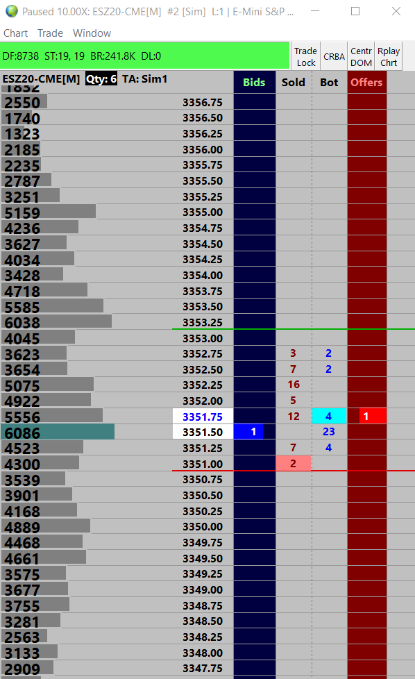

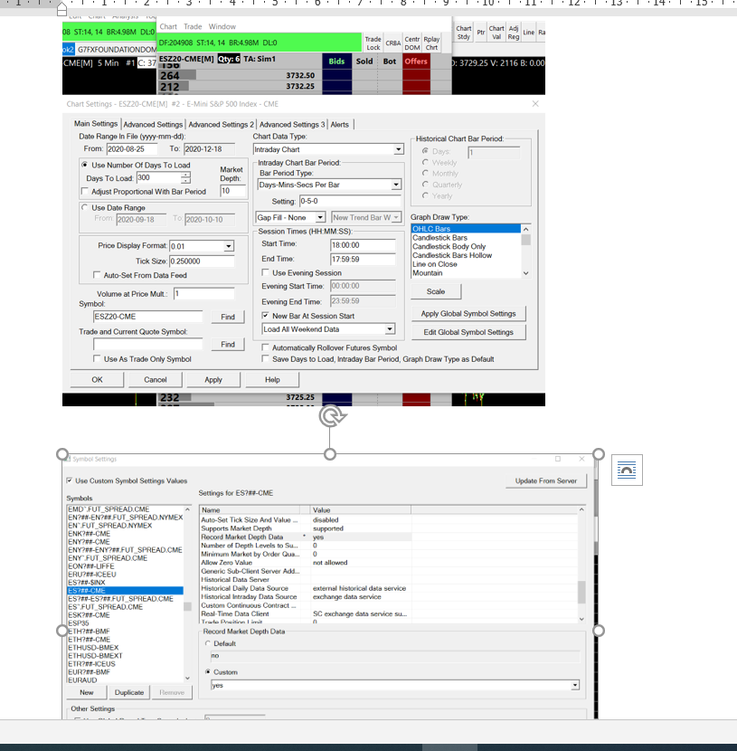

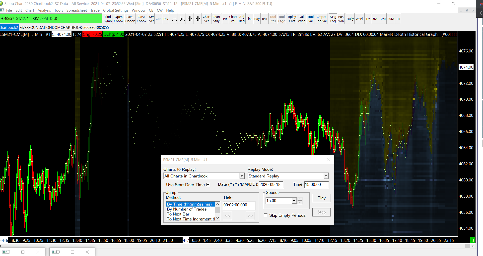

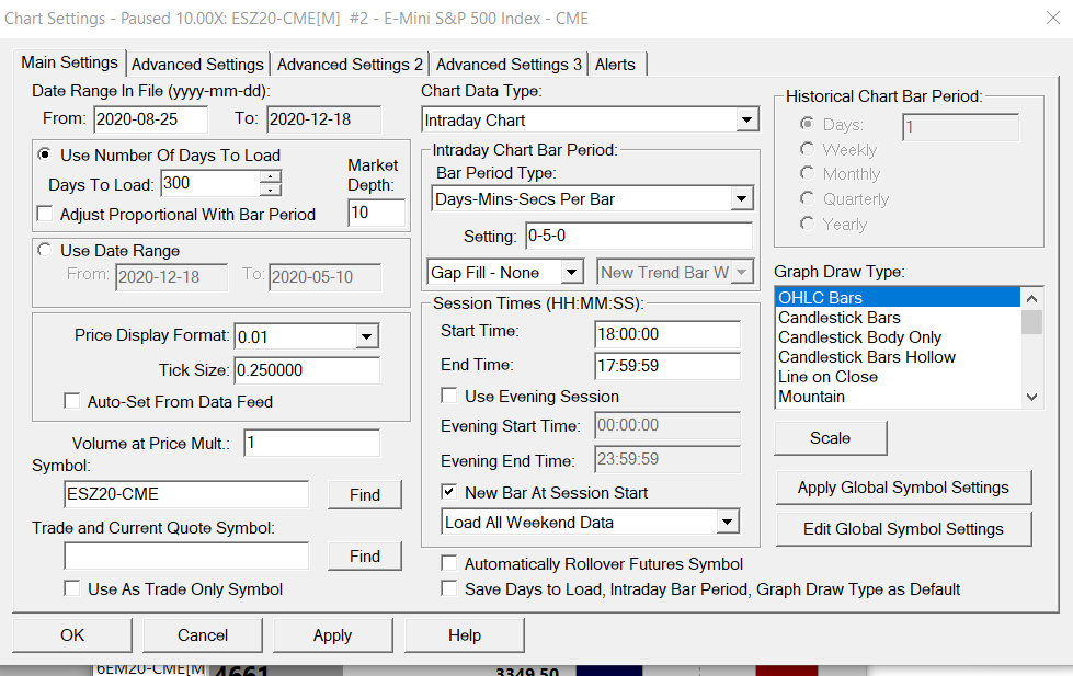

Hi
I followed your instructions - please see screenshots . I get the same problem.
I only have a chart and DOM in this chartbook, both settings are the same.
When you said "Make sure your Trading DOM is setup prior to starting the replay." what do you exactly mean , l basically used the "use number of days"
And set it to 300, hit apply and then started the replay.
Please advise
Thanks in advance

In your pic6.png image you show that you have the Market Depth Historical Graph on your chart, but there is nothing displayed. This means that you do not have the Market Depth recorded. You need to have the Market Depth data for the time of the replay. Refer to the information at this link:
Replaying Charts: Replaying of Market Depth Data
Also refer to the following:
Market Depth Historical Graph: Market Depth Historical Graph Not Displaying
And the following:
Market Depth Historical Graph: Downloading Of Historical Market Depth Data

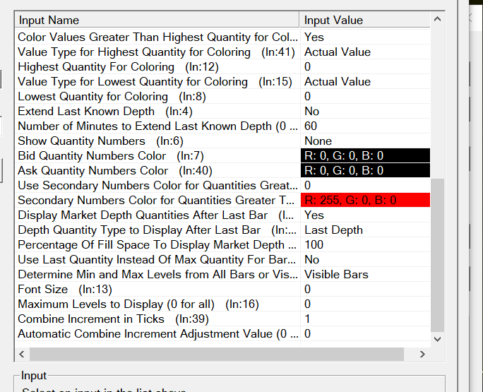

John - SC Support - Posts: 48095

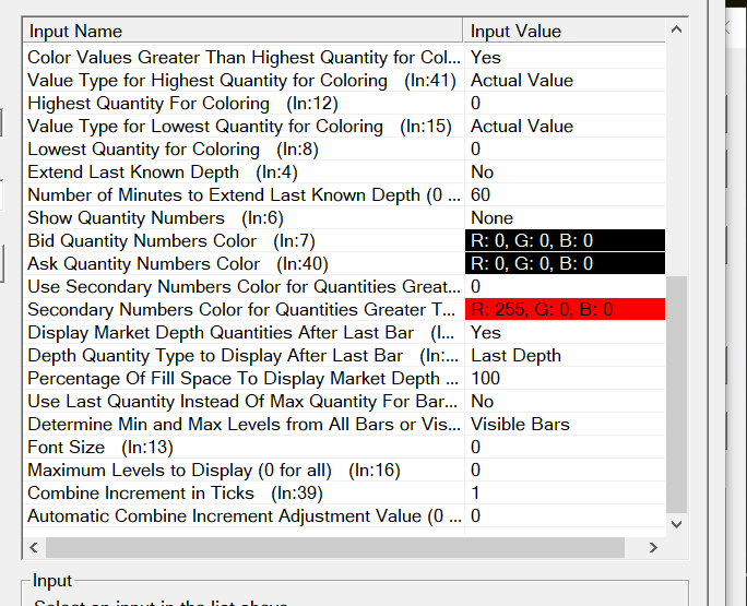

Can you please take an image of the chart with the Market Depth Historical Graph turned on. Make sure the Input for Extend Last Known Depth is set to No and the Maximum Levels to Display is set to 0.

Please find requested attachments. Just for your reference the "Extend Last Known Depth" option was already set to No but the "Maximum Levels to Display"
option was 40 so l set to zero. Applied then disconnect and connect. I presume you wanted to see the chart when in replay mode ?
