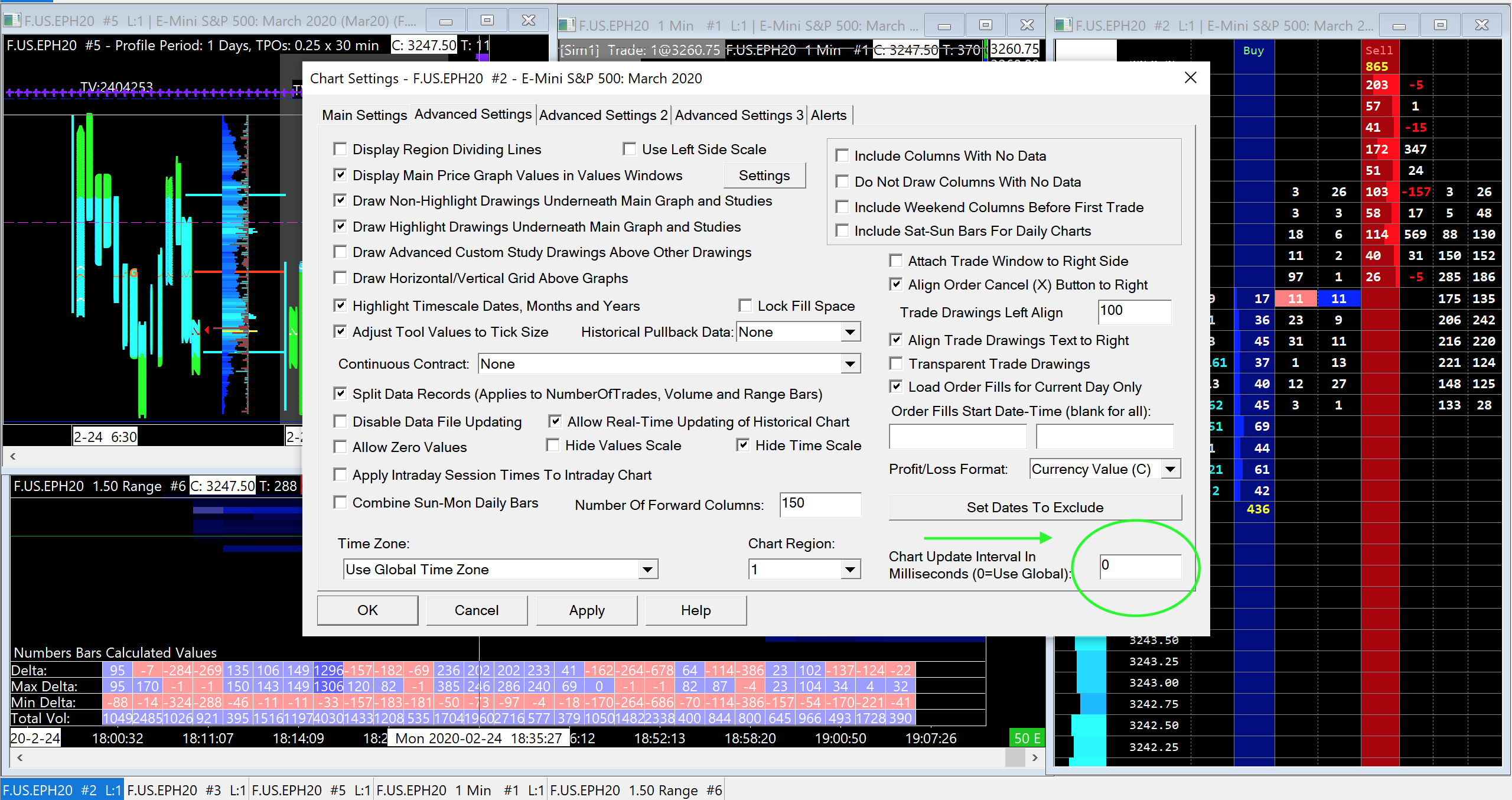

                Hello, every time I try and change my chart update interval in seconds for my DOM, it changes it back to 0.  It is at 0 right now and if I click on it and change it to 1, it will flash and become 0 again.  Please let me know if you can help, thanks.

                Chart update interval is measured in milliseconds. The lowest setting possible is 10ms. For 1 second update interval, set to 1000ms. General Settings Window: Chart Update Interval (Global Settings >> General Settings >> General >> Update Intervals)  |
|   [2020-02-25 09:02:45]     |
                Yes you need to set the Chart Update Interval to 1000 in your case.
