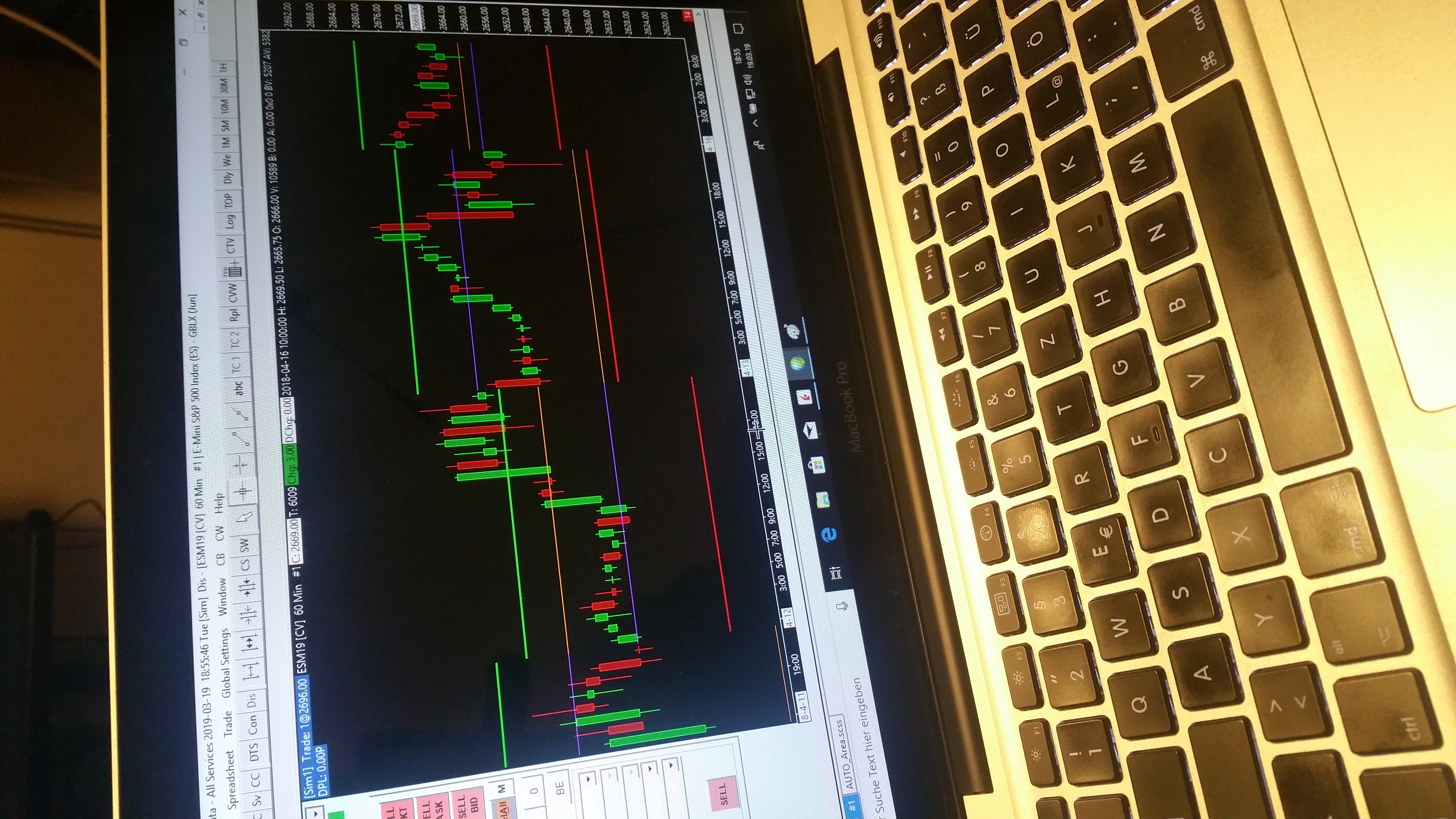

| User575872 - Posts: 78 |
                1. How can I tell the system that the formulas from #51 are only used when the High and Low from "Reference Days Back 1" are in the range of "Reference Days Back 2"?    2. Why is it that using the formula from # 51 at this point in the chart does not trigger an order? (see attached pictures)  |
|   [2019-03-06 19:52:35]     |
| Sawtooth - Posts: 4285 |
                1. Please tell me the ID#s of both instances of the Daily OHLC study. 2. Swap the shorts and longs in the P3 formula: P3: =IF(AND(E3>=AB3-2*$J$21,AA3<AB3,AA3>AC3), 1, IF(AND(E3<=AC3+2*$J$21,AA3<AB3,AA3>AC3), 0, P4)) Date Time Of Last Edit: 2019-03-06 21:52:32

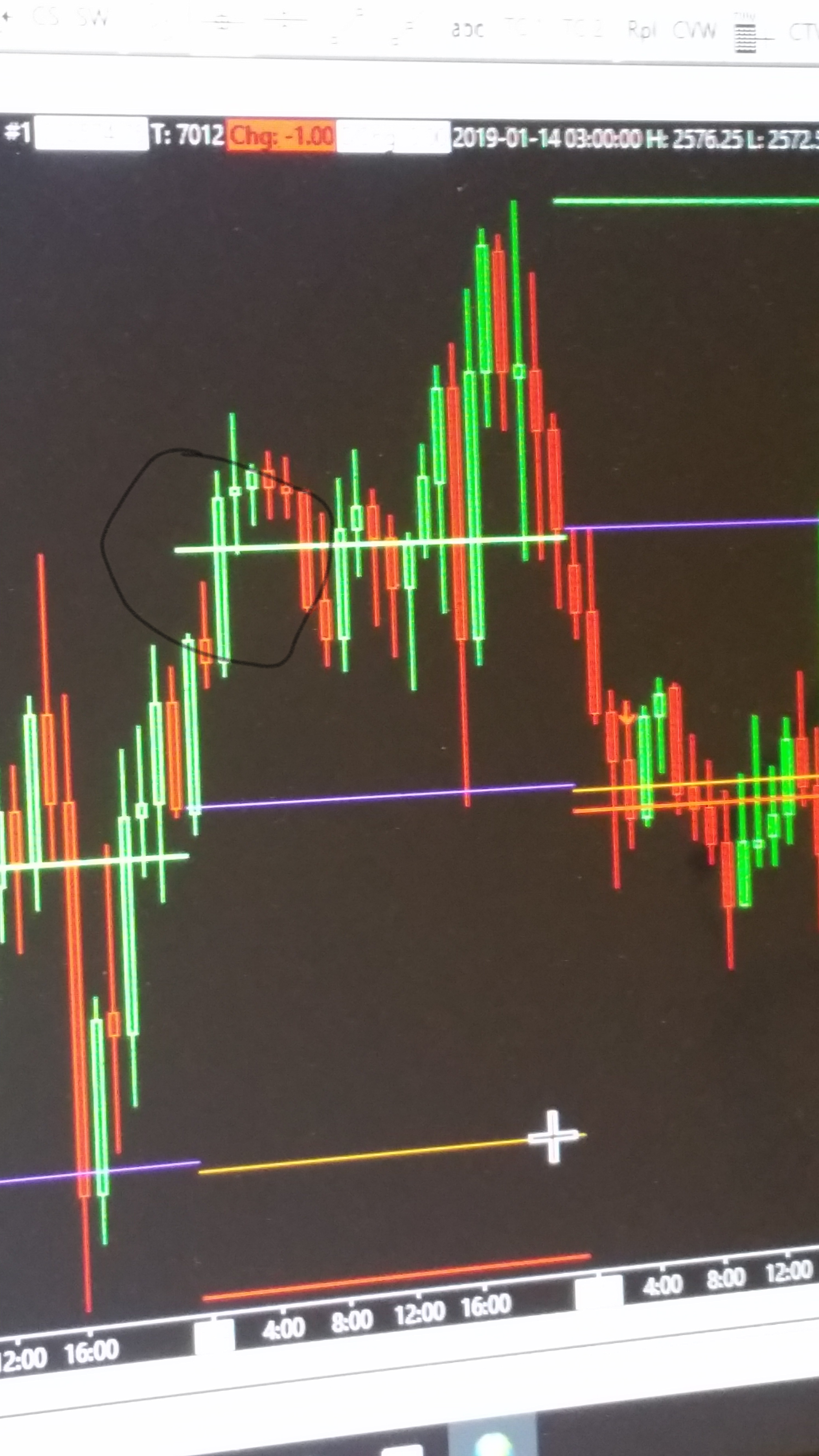

                #58 I used the formula for cell p3 Only a understanding ask: Why does the spreadsheet-system trigger day 4-12 but not 4-13 ?  |
|   [2019-03-19 18:21:03]     |
                ...it was breakout at high or low
|   [2019-03-19 20:10:58]     |
The P3 formula in post #58 doesn't give another long unless the Last price crosses the LOD.From post #51: and you always want to alternate longs and shorts
