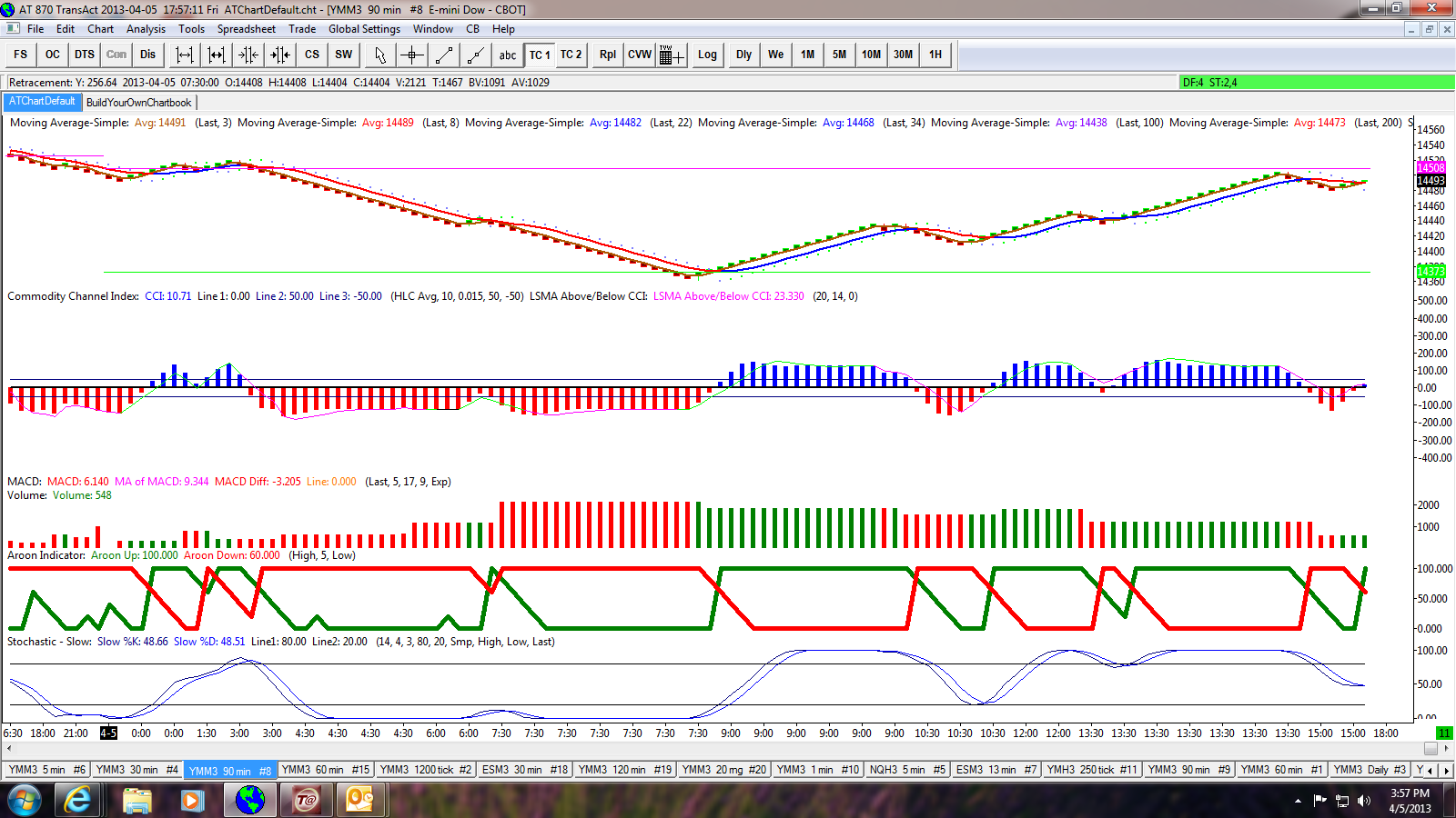

                Hi, maybe my charts are outdated and I need to update to a newer version. I am using transact, because my chart setting charts are not renko charts. To many pivots, drawing bricks where typically they should not exist. I also can not adjust the time. TY
|   [2013-04-06 23:27:25]     |
                From User: The chart below is a renko enhance STUDY using 90 min setting. This is what I was saying about having to refresh this chart. Without refreshing this chart would not look like this. But isn't nice? Your chart setting chart does not look like this. I also noticed on your chart setting chart I cannot change the time frame only the size of the bar. Is that correct? Sierra Chart Support   |
|   [2013-04-09 04:52:05]     |
                The Renko in Ticks setting found in Chart >> Chart Settings produces very accurate Renko bars when used with tick by tick data. The reason when using the Renko study that you probably have to perform a recalculation is because the underlying bars are 90 minutes. The Renko study is not going to function correctly with an underlying bar duration that long. There simply is no support for using a long time duration underlying bar. Sierra Chart Support - Engineering Level  Your definitive source for support. Other responses are from users. Try to keep your questions brief and to the point. Be aware of support policy: https://www.sierrachart.com/index.php?l=PostingInformation.php#GeneralInformation For the most reliable, advanced, and zero cost futures order routing, *change* to the Teton service: Sierra Chart Teton Futures Order Routing Date Time Of Last Edit: 2013-04-09 04:52:51
