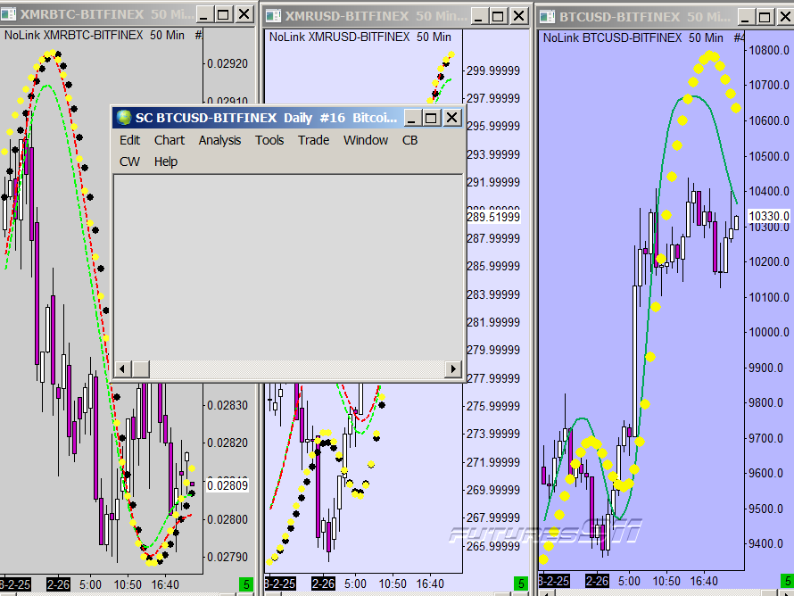

                Ok, regarding my issue with Bitfinex symbols not updating from 2/26/18, I have reviewed possible issues in SC documentation you suggested (the ones with the red asterix), including deleting the historical data and downloading new data.  However, that just yields a blank Historical chart as shown in the attached clip. As for intraday, still no updates after 2/26/18. The message log for all three symbols I tried: (ZMRBTC-BITFINEX, BTCUSD-BITFINEX Daily & Intraday) says '0 records received'. Any other suggestions?  |

|   [2018-04-22 19:01:30]     |
                Update Sierra Chart using this installer: https://www.sierrachart.com/downloads/SierraChartFileDownloader.exe If you still do not get the current data, then follow the below instructions: Follow the instructions here to clear the Message Log: Message Log: Clearing the Message Log Fully re-download the data in the chart by going to the chart and selecting "Edit >>Delete All Data and Download". After about a minute provide a copy of the Message Log following these instructions: Support Board Posting Information: How to Post Your Message Log (Required In Some Cases) Sierra Chart Support - Engineering Level  Your definitive source for support. Other responses are from users. Try to keep your questions brief and to the point. Be aware of support policy: https://www.sierrachart.com/index.php?l=PostingInformation.php#GeneralInformation For the most reliable, advanced, and zero cost futures order routing, *change* to the Teton service: Sierra Chart Teton Futures Order Routing Date Time Of Last Edit: 2018-04-22 19:01:52

                This is a response to my last query re: not getting data on BTCUSD-BITFINEX from 2/26/18. I tried your suggestions, but still no data. (by the way, I also have a chart for XMRUSD-BITFINEX, and it will not load data either. As instructed, attached is the log you referred to. ------------------------------------------------ Reading Internal Order ID file. | 2018-05-11 12:26:03 Reading Trade Orders file. | 2018-05-11 12:26:03 Reading Trade Positions file. | 2018-05-11 12:26:03 Listening on UDP port 22903. | 2018-05-11 12:26:03 Software version: 1705 | 2018-05-11 12:26:03 Usage end date: 2018-05-27 | 2018-05-11 12:26:03 Enabled for: Advanced Features. | 2018-05-11 12:26:03 Enabled for: Sierra Chart Historical Data Service. | 2018-05-11 12:26:03 Allow Support for Sierra Chart Data Feeds is enabled. | 2018-05-11 12:26:03 Current selected Data/Trading service: SC Data - All Services | 2018-05-11 12:26:03 Chart Update Interval: 5000 | 2018-05-11 12:26:03 Time Zone: -07:00:00 (MST-07) | 2018-05-11 12:26:03 2018-05-11 12:26:02 Local computer time | 2018-05-11 12:26:03 2018-05-11 19:26:02 Local computer time in UTC | 2018-05-11 12:26:03 2018-05-11 12:26:02 Local computer time in SC Time Zone | 2018-05-11 12:26:03 2018-05-11 19:25:58 Server time in UTC | 2018-05-11 12:26:03 Local computer UTC time and Server UTC time difference: 4 seconds. | 2018-05-11 12:26:03 Program path: C:\SierraChart\ | 2018-05-11 12:26:03 Data Files path: C:\SierraChart\Data\ | 2018-05-11 12:26:03 OS Version Number: 6.1 | 2018-05-11 12:26:03 Locale Setting: C | 2018-05-11 12:26:03 Checking for new symbol settings for service code scdataallservices | 2018-05-11 12:26:03 HTTPS connection to www.sierrachart.com:443 (4) | Creating socket. Using TLS 1.2. | 2018-05-11 12:26:03 HTTPS connection to www.sierrachart.com:443 (4) | Connecting to IP: 204.15.192.108. | 2018-05-11 12:26:03 Received 5 login tokens. | 2018-05-11 12:26:03 HTTPS connection to www.sierrachart.com:443 (5) | Creating socket. Using TLS 1.2. | 2018-05-11 12:26:05 HTTPS connection to www.sierrachart.com:443 (5) | Connecting to IP: 204.15.192.108. | 2018-05-11 12:26:05 Symbol settings are up-to-date for scdataallservices | 2018-05-11 12:26:07 HTTPS connection to www.sierrachart.com:443 (2) | Socket gracefully closed by remote side. | 2018-05-11 12:26:08 HTTPS connection to www.sierrachart.com:443 (2) | Received socket Close event. | 2018-05-11 12:26:08 HTTPS connection to www.sierrachart.com:443 (2) | Initiating close of socket by core. | 2018-05-11 12:26:08 HTTPS connection to www.sierrachart.com:443 (2) | Graceful close received or receive error. Shutdown complete. Closing socket now. | 2018-05-11 12:26:08 HTTPS connection to www.sierrachart.com:443 (2) | Closed. | 2018-05-11 12:26:08 HTTPS connection to www.sierrachart.com:443 (5) | Socket gracefully closed by remote side. | 2018-05-11 12:26:10 HTTPS connection to www.sierrachart.com:443 (5) | Received socket Close event. | 2018-05-11 12:26:10 HTTPS connection to www.sierrachart.com:443 (5) | Initiating close of socket by core. | 2018-05-11 12:26:10 HTTPS connection to www.sierrachart.com:443 (5) | Graceful close received or receive error. Shutdown complete. Closing socket now. | 2018-05-11 12:26:10 HTTPS connection to www.sierrachart.com:443 (5) | Closed. | 2018-05-11 12:26:10 HTTPS connection to www.sierrachart.com:443 (4) | Socket gracefully closed by remote side. | 2018-05-11 12:26:12 HTTPS connection to www.sierrachart.com:443 (4) | Received socket Close event. | 2018-05-11 12:26:12 HTTPS connection to www.sierrachart.com:443 (4) | Initiating close of socket by core. | 2018-05-11 12:26:12 HTTPS connection to www.sierrachart.com:443 (4) | Graceful close received or receive error. Shutdown complete. Closing socket now. | 2018-05-11 12:26:12 HTTPS connection to www.sierrachart.com:443 (4) | Closed. | 2018-05-11 12:26:12 SC Data - All Services | Connected to data server. | 2018-05-11 12:26:13 BGG18 Daily #10 | Reloading chart. | 2018-05-11 12:26:15 BTCUSD-BITFINEX Daily #11 | Reloading chart. | 2018-05-11 12:26:15 BGK18 60 Min #12 | Reloading chart. | 2018-05-11 12:26:16 BGK18 21 Min #13 | Reloading chart. | 2018-05-11 12:26:16 BG# Daily #14 | Reloading chart. | 2018-05-11 12:26:16 CLK18 90 Min #15 | Reloading chart. | 2018-05-11 12:26:16 CLK18 21 Min #17 | Reloading chart. | 2018-05-11 12:26:16 CL# Weekly #1 | Reloading chart. | 2018-05-11 12:26:16 CL# Monthly #2 | Reloading chart. | 2018-05-11 12:26:16 BGM18 120 Min #8 | Reloading chart. | 2018-05-11 12:26:16 BGK18 120 Min #19 | Reloading chart. | 2018-05-11 12:26:16 CLK18 120 Min #20 | Reloading chart. | 2018-05-11 12:26:16 BTCUSD-BITFINEX 13 Min #18 | Reloading chart. | 2018-05-11 12:26:16 BTCUSD-BITFINEX Daily #21 | Reloading chart. | 2018-05-11 12:26:16 BTCUSD-BITFINEX 26 Min #22 | Reloading chart. | 2018-05-11 12:26:16 BTCUSD-BITFINEX 90 Min #23 | Reloading chart. | 2018-05-11 12:26:16 BGK18 50 Min #3 | Reloading chart. | 2018-05-11 12:26:16 BTCUSD-BITFINEX 50 Min #4 | Reloading chart. | 2018-05-11 12:26:16 BGK18 21 Min #5 | Reloading chart. | 2018-05-11 12:26:17 BGK18 50 Min #6 | Reloading chart. | 2018-05-11 12:26:17 BTCUSD-BITFINEX 120 Min #7 | Reloading chart. | 2018-05-11 12:26:17 BTCUSD-BITFINEX 180 Min #9 | Reloading chart. | 2018-05-11 12:26:17 BTCUSD-BITFINEX Daily #16 | Reloading chart. | 2018-05-11 12:26:17 XMRUSD-BITFINEX 50 Min #24 | Reloading chart. | 2018-05-11 12:26:17 XMRBTC-BITFINEX 50 Min #25 | Reloading chart. | 2018-05-11 12:26:17 BTCUSD-BITFINEX 50 Min #26 | Reloading chart. | 2018-05-11 12:26:17 BG# Weekly #27 | Reloading chart. | 2018-05-11 12:26:17 BGK18 90 Min #28 | Reloading chart. | 2018-05-11 12:26:18 BGM18 Daily #29 | Reloading chart. | 2018-05-11 12:26:18 BGM18 120 Min #30 | Reloading chart. | 2018-05-11 12:26:18 BTCUSD-BITFINEX Daily #11 | Currently no data in file to display. Will start historical data download and real-time updates. File: C:\SierraChart\Data\BTCUSD-BITFINEX.dly | 2018-05-11 12:26:18 BTCUSD-BITFINEX Daily #21 | Currently no data in file to display. Will start historical data download and real-time updates. File: C:\SierraChart\Data\BTCUSD-BITFINEX.dly | 2018-05-11 12:26:18 BTCUSD-BITFINEX Daily #16 | Currently no data in file to display. Will start historical data download and real-time updates. File: C:\SierraChart\Data\BTCUSD-BITFINEX.dly | 2018-05-11 12:26:18 XMRBTC-BITFINEX 50 Min #25 | Currently no data in file to display. Will start historical data download and real-time updates. File: C:\SierraChart\Data\XMRBTC-BITFINEX.scid | 2018-05-11 12:26:18 SC Data - All Services | Starting real-time market data updates for: BGG18. ID: 1 | 2018-05-11 12:26:20 SC Data - All Services | Subscribing to streaming market data in the service client is not supported. Symbol: BGG18 | 2018-05-11 12:26:20 SC Data - All Services | Requesting security definition data for: BGG18. ID: 1 | 2018-05-11 12:26:20 HD Request # 2 | Downloading Historical Daily chart data for BGG18. Starting date: 2018-02-13. Service: cfefut | 2018-05-11 12:26:20 HD Request # 2 | Requesting historical Daily data for BGG18 starting at 2018-02-12 | 2018-05-11 12:26:20 HTTPS connection to historicaldata.sierrachart.com:443 (6) | Creating socket. Using TLS 1.2. | 2018-05-11 12:26:20 HTTPS connection to historicaldata.sierrachart.com:443 (6) | Connecting to IP: 88.99.0.216. | 2018-05-11 12:26:20 SC Data - All Services | Starting real-time market data updates for: BTCUSD-BITFINEX. ID: 2 | 2018-05-11 12:26:21 SC Data - All Services | Subscribing to streaming market data in the service client is not supported. Symbol: BTCUSD-BITFINEX | 2018-05-11 12:26:21 SC Data - All Services | Requesting security definition data for: BTCUSD-BITFINEX. ID: 2 | 2018-05-11 12:26:21 SC Data - All Services | Starting real-time market data updates for: BGK18. ID: 3 | 2018-05-11 12:26:21 SC Data - All Services | Subscribing to streaming market data in the service client is not supported. Symbol: BGK18 | 2018-05-11 12:26:21 SC Data - All Services | Requesting security definition data for: BGK18. ID: 3 | 2018-05-11 12:26:21 Intraday data recording state for symbol BGK18 is set to download 'Pending'. | 2018-05-11 12:26:21 Delaying start of download for BGK18 | 2018-05-11 12:26:21 SC Data - All Services | Starting real-time market data updates for: BG#. ID: 4 | 2018-05-11 12:26:21 SC Data - All Services | Subscribing to streaming market data in the service client is not supported. Symbol: BG# | 2018-05-11 12:26:21 SC Data - All Services | Requesting security definition data for: BG#. ID: 4 | 2018-05-11 12:26:21 SC Data - All Services | Starting real-time market data updates for: CLK18. ID: 5 | 2018-05-11 12:26:21 SC Data - All Services | Subscribing to streaming market data in the service client is not supported. Symbol: CLK18 | 2018-05-11 12:26:21 SC Data - All Services | Requesting security definition data for: CLK18. ID: 5 | 2018-05-11 12:26:21 Intraday data recording state for symbol CLK18 is set to download 'Pending'. | 2018-05-11 12:26:21 SC Data - All Services | Starting real-time market data updates for: CL#. ID: 6 | 2018-05-11 12:26:21 SC Data - All Services | Subscribing to streaming market data in the service client is not supported. Symbol: CL# | 2018-05-11 12:26:21 SC Data - All Services | Requesting security definition data for: CL#. ID: 6 | 2018-05-11 12:26:21 SC Data - All Services | Starting real-time market data updates for: BGM18. ID: 7 | 2018-05-11 12:26:21 SC Data - All Services | Subscribing to streaming market data in the service client is not supported. Symbol: BGM18 | 2018-05-11 12:26:21 SC Data - All Services | Requesting security definition data for: BGM18. ID: 7 | 2018-05-11 12:26:21 Intraday data recording state for symbol BGM18 is set to download 'Pending'. | 2018-05-11 12:26:21 Intraday data recording state for symbol BTCUSD-BITFINEX is set to download 'Pending'. | 2018-05-11 12:26:21 Historical Daily data request for BTCUSD-BITFINEX is discarded because a matching download is already pending and the new one is not for earlier data. | 2018-05-11 12:26:21 Delaying start of download for BGK18 | 2018-05-11 12:26:22 Historical Daily data request for BTCUSD-BITFINEX is discarded because a matching download is already pending and the new one is not for earlier data. | 2018-05-11 12:26:22 SC Data - All Services | Starting real-time market data updates for: XMRUSD-BITFINEX. ID: 8 | 2018-05-11 12:26:22 SC Data - All Services | Subscribing to streaming market data in the service client is not supported. Symbol: XMRUSD-BITFINEX | 2018-05-11 12:26:22 SC Data - All Services | Requesting security definition data for: XMRUSD-BITFINEX. ID: 8 | 2018-05-11 12:26:22 Intraday data recording state for symbol XMRUSD-BITFINEX is set to download 'Pending'. | 2018-05-11 12:26:22 HD Request # 2 | Receiving historical Daily data for BGG18 starting at 2018-02-13 | 2018-05-11 12:26:22 HD Request # 2 | Writing historical Daily data to the file BGG18.dly | 2018-05-11 12:26:22 HD Request # 2 | Received 3 records from 2018-02-13 00:00:00 to 2018-02-14 00:00:00 (2.0 days) and wrote 2 records for BGG18 | 2018-05-11 12:26:22 HD Request # 2 | Completion time: 2s | 2018-05-11 12:26:22 HD Request # 2 | Daily data download complete for BGG18. Unique request ID: 1 | 2018-05-11 12:26:22 Removed historical data download ID 1 | 2018-05-11 12:26:22 HD Request # 3 | Downloading Historical Daily chart data for BTCUSD-BITFINEX. Starting date: 1968-05-11. Service: bitfinex | 2018-05-11 12:26:22 HD Request # 3 | Requesting historical Daily data for BTCUSD-BITFINEX starting at 1968-05-10 | 2018-05-11 12:26:22 SC Data - All Services | Starting real-time market data updates for: XMRBTC-BITFINEX. ID: 9 | 2018-05-11 12:26:22 SC Data - All Services | Subscribing to streaming market data in the service client is not supported. Symbol: XMRBTC-BITFINEX | 2018-05-11 12:26:22 SC Data - All Services | Requesting security definition data for: XMRBTC-BITFINEX. ID: 9 | 2018-05-11 12:26:22 Intraday data recording state for symbol XMRBTC-BITFINEX is set to download 'Pending'. | 2018-05-11 12:26:22 HD Request # 3 | Received 0 records from 00:00:00 to 00:00:00 (0.0 seconds) and wrote 0 records for BTCUSD-BITFINEX | 2018-05-11 12:26:23 HD Request # 3 | Completion time: 0s | 2018-05-11 12:26:23 HD Request # 3 | Daily data download complete for BTCUSD-BITFINEX. Unique request ID: 2 | 2018-05-11 12:26:23 Removed historical data download ID 2 | 2018-05-11 12:26:23 HD Request # 4 | Downloading Historical Daily chart data for BG#. Starting date: 2018-05-10. Service: scdataallservices | 2018-05-11 12:26:23 HD Request # 4 | Requesting historical Daily Continuous data for BGZ10 starting at 2018-05-09 | 2018-05-11 12:26:23 HD Request # 4 | Receiving historical Daily data for BG# starting at 2018-05-10 | 2018-05-11 12:26:24 HD Request # 4 | Writing historical Daily data to the file BG#.dly | 2018-05-11 12:26:24 HD Request # 4 | Received 3 records from 2018-05-10 00:00:00 to 2018-05-11 00:00:00 (2.0 days) and wrote 2 records for BG# | 2018-05-11 12:26:24 HD Request # 4 | Completion time: 2s | 2018-05-11 12:26:24 HD Request # 4 | Daily data download complete for BG#. Unique request ID: 4 | 2018-05-11 12:26:24 Removed historical data download ID 4 | 2018-05-11 12:26:24 HD Request # 5 | Downloading Historical Daily chart data for CL#. Starting date: 2018-05-10. Service: scdataallservices | 2018-05-11 12:26:24 HD Request # 5 | Requesting historical Daily Continuous data for CLZ10 starting at 2018-05-09 | 2018-05-11 12:26:24 HD Request # 5 | Receiving historical Daily data for CL# starting at 2018-05-10 | 2018-05-11 12:26:25 HD Request # 5 | Writing historical Daily data to the file CL#.dly | 2018-05-11 12:26:25 HD Request # 5 | Received 3 records from 2018-05-10 00:00:00 to 2018-05-11 00:00:00 (2.0 days) and wrote 2 records for CL# | 2018-05-11 12:26:25 HD Request # 5 | Completion time: 1s | 2018-05-11 12:26:25 HD Request # 5 | Daily data download complete for CL#. Unique request ID: 6 | 2018-05-11 12:26:25 Removed historical data download ID 6 | 2018-05-11 12:26:25 HD Request # 6 | Downloading Intraday chart data for BTCUSD-BITFINEX to the file BTCUSD-BITFINEX.scid. Service: bitfinex | 2018-05-11 12:26:25 HD Request # 6 | Download start date-time: 2018-02-26 21:56:38.000 | 2018-05-11 12:26:25 HD Request # 6 | Requesting historical Intraday Minute data for BTCUSD-BITFINEX starting at 2018-02-26 23:56:38 (Exchange time). | 2018-05-11 12:26:25 BGG18 Daily #10 | Reloading chart. | 2018-05-11 12:26:25 BTCUSD-BITFINEX Daily #11 | Reloading chart. | 2018-05-11 12:26:26 BTCUSD-BITFINEX Daily #11 | Currently no data in file to display. Will start historical data download and real-time updates. File: C:\SierraChart\Data\BTCUSD-BITFINEX.dly | 2018-05-11 12:26:26 HD Request # 7 | Downloading Intraday chart data for BGK18 to the file BGK18.scid. Service: cfefut | 2018-05-11 12:26:26 HD Request # 7 | Download start date-time: 2018-05-11 12:02:11.000 | 2018-05-11 12:26:26 HD Request # 7 | Using server: ds7.sierracharts.com port 10149 | 2018-05-11 12:26:26 Socket (7) | Creating socket. | 2018-05-11 12:26:26 Socket (7) | Connecting to IP: 8.18.161.133. | 2018-05-11 12:26:26 BG# Daily #14 | Reloading chart. | 2018-05-11 12:26:26 CL# Weekly #1 | Reloading chart. | 2018-05-11 12:26:26 CL# Monthly #2 | Reloading chart. | 2018-05-11 12:26:26 HD Request # 7 | Setting DTC encoding to Binary VLS | 2018-05-11 12:26:26 HD Request # 7 | Sending historical data logon request message. | 2018-05-11 12:26:26 HD Request # 7 | Requesting Intraday data. Start date-time: 2018-05-11 12:02:11. Record interval: 2. Symbol: BGK18 | 2018-05-11 12:26:26 HD Request # 7 | Decompressing data. | 2018-05-11 12:26:26 HD Request # 7 | Receiving Intraday data for BGK18 starting at 2018-05-11 12:02:11 | 2018-05-11 12:26:26 HD Request # 7 | Timestamp of first Intraday data file record written: 2018-05-11 12:02:11 | 2018-05-11 12:26:26 Socket (7) | Initiating close of socket by core. | 2018-05-11 12:26:26 Socket (7) | Shutdown started. Waiting for graceful close. | 2018-05-11 12:26:26 Historical data download thread signaled to stop. | 2018-05-11 12:26:26 HD Request # 7 | Received 40 records from 2018-05-11 12:02:11 to 2018-05-11 12:16:22 (14.2 minutes) and wrote 40 records for BGK18 | 2018-05-11 12:26:26 HD Request # 7 | Completion time: 0s | 2018-05-11 12:26:26 HD Request # 7 | Intraday data download complete for BGK18. Unique request ID: 3 | 2018-05-11 12:26:26 Removed historical data download ID 3 | 2018-05-11 12:26:26 Real-time Intraday chart data file updates started for BGK18 | 2018-05-11 12:26:26 Opened cached Intraday file: C:\SierraChart\Data\BGK18.scid | 2018-05-11 12:26:26 Intraday chart data file opened for BGK18 | 2018-05-11 12:26:26 HD Request # 8 | Downloading Intraday chart data for CLK18 to the file CLK18.scid. Service: nymex | 2018-05-11 12:26:26 HD Request # 8 | Download start date-time: 2018-04-20 11:29:48.000 | 2018-05-11 12:26:26 HD Request # 8 | Using server: ds1.sierracharts.com port 10150 | 2018-05-11 12:26:26 Socket (8) | Creating socket. | 2018-05-11 12:26:26 Socket (8) | Connecting to IP: 8.18.161.135. | 2018-05-11 12:26:26 Socket (7) | Socket gracefully closed by remote side. | 2018-05-11 12:26:26 Socket (7) | Closed. | 2018-05-11 12:26:26 HD Request # 6 | Received 0 records from 00:00:00 to 00:00:00 (0.0 seconds) and wrote 0 records for BTCUSD-BITFINEX | 2018-05-11 12:26:26 HD Request # 6 | Completion time: 0s | 2018-05-11 12:26:26 HD Request # 6 | Intraday data download complete for BTCUSD-BITFINEX. Unique request ID: 8 | 2018-05-11 12:26:26 Removed historical data download ID 8 | 2018-05-11 12:26:26 Real-time Intraday chart data file updates started for BTCUSD-BITFINEX | 2018-05-11 12:26:26 Opened cached Intraday file: C:\SierraChart\Data\BTCUSD-BITFINEX.scid | 2018-05-11 12:26:26 Intraday chart data file opened for BTCUSD-BITFINEX | 2018-05-11 12:26:26 Delaying start of download for XMRUSD-BITFINEX | 2018-05-11 12:26:26 BTCUSD-BITFINEX Daily #21 | Reloading chart. | 2018-05-11 12:26:26 BTCUSD-BITFINEX Daily #21 | Currently no data in file to display. Will start historical data download and real-time updates. File: C:\SierraChart\Data\BTCUSD-BITFINEX.dly | 2018-05-11 12:26:26 HD Request # 8 | Setting DTC encoding to Binary VLS | 2018-05-11 12:26:26 HD Request # 8 | Sending historical data logon request message. | 2018-05-11 12:26:26 HD Request # 8 | Requesting Intraday data. Start date-time: 2018-04-20 11:29:48. Record interval: 2. Symbol: CLK18 | 2018-05-11 12:26:26 HD Request # 8 | Decompressing data. | 2018-05-11 12:26:26 HD Request # 8 | Receiving Intraday data for CLK18 starting at 2018-04-20 11:29:48 | 2018-05-11 12:26:26 HD Request # 8 | Timestamp of first Intraday data file record written: 2018-04-20 11:29:48 | 2018-05-11 12:26:26 Socket (8) | Initiating close of socket by core. | 2018-05-11 12:26:26 Socket (8) | Shutdown started. Waiting for graceful close. | 2018-05-11 12:26:26 Historical data download thread signaled to stop. | 2018-05-11 12:26:26 HD Request # 8 | Received 1 record from 2018-04-20 11:29:48 to 2018-04-20 11:29:48 (0.0 seconds) and wrote 1 record for CLK18 | 2018-05-11 12:26:26 HD Request # 8 | Completion time: 1s | 2018-05-11 12:26:26 HD Request # 8 | Intraday data download complete for CLK18. Unique request ID: 5 | 2018-05-11 12:26:26 Removed historical data download ID 5 | 2018-05-11 12:26:26 Real-time Intraday chart data file updates started for CLK18 | 2018-05-11 12:26:26 Opened cached Intraday file: C:\SierraChart\Data\CLK18.scid | 2018-05-11 12:26:26 Intraday chart data file opened for CLK18 | 2018-05-11 12:26:26 HD Request # 9 | Downloading Intraday chart data for BGM18 to the file BGM18.scid. Service: cfefut | 2018-05-11 12:26:26 HD Request # 9 | Download start date-time: 2018-05-11 12:01:32.000 | 2018-05-11 12:26:26 HD Request # 9 | Using server: ds7.sierracharts.com port 10149 | 2018-05-11 12:26:26 Socket (9) | Creating socket. | 2018-05-11 12:26:26 Socket (9) | Connecting to IP: 8.18.161.133. | 2018-05-11 12:26:26 Socket (8) | Socket gracefully closed by remote side. | 2018-05-11 12:26:26 Socket (8) | Closed. | 2018-05-11 12:26:26 HD Request # 9 | Setting DTC encoding to Binary VLS | 2018-05-11 12:26:26 HD Request # 9 | Sending historical data logon request message. | 2018-05-11 12:26:26 HD Request # 9 | Requesting Intraday data. Start date-time: 2018-05-11 12:01:32. Record interval: 2. Symbol: BGM18 | 2018-05-11 12:26:27 HD Request # 9 | Decompressing data. | 2018-05-11 12:26:27 HD Request # 9 | Receiving Intraday data for BGM18 starting at 2018-05-11 12:01:32 | 2018-05-11 12:26:27 HD Request # 9 | Timestamp of first Intraday data file record written: 2018-05-11 12:01:32 | 2018-05-11 12:26:27 Socket (9) | Initiating close of socket by core. | 2018-05-11 12:26:27 Socket (9) | Shutdown started. Waiting for graceful close. | 2018-05-11 12:26:27 Historical data download thread signaled to stop. | 2018-05-11 12:26:27 HD Request # 9 | Received 7 records from 2018-05-11 12:01:32 to 2018-05-11 12:16:22 (14.8 minutes) and wrote 7 records for BGM18 | 2018-05-11 12:26:27 HD Request # 9 | Completion time: 0s | 2018-05-11 12:26:27 HD Request # 9 | Intraday data download complete for BGM18. Unique request ID: 7 | 2018-05-11 12:26:27 Removed historical data download ID 7 | 2018-05-11 12:26:27 Real-time Intraday chart data file updates started for BGM18 | 2018-05-11 12:26:27 Opened cached Intraday file: C:\SierraChart\Data\BGM18.scid | 2018-05-11 12:26:27 Intraday chart data file opened for BGM18 | 2018-05-11 12:26:27 Socket (9) | Socket gracefully closed by remote side. | 2018-05-11 12:26:27 Socket (9) | Closed. | 2018-05-11 12:26:27 BTCUSD-BITFINEX Daily #16 | Reloading chart. | 2018-05-11 12:26:27 BTCUSD-BITFINEX Daily #16 | Currently no data in file to display. Will start historical data download and real-time updates. File: C:\SierraChart\Data\BTCUSD-BITFINEX.dly | 2018-05-11 12:26:27 HD Request # 10 | Downloading Intraday chart data for XMRUSD-BITFINEX to the file XMRUSD-BITFINEX.scid. Service: bitfinex | 2018-05-11 12:26:27 HD Request # 10 | Download start date-time: 2018-02-26 20:48:08.000 | 2018-05-11 12:26:27 HD Request # 10 | Requesting historical Intraday Minute data for XMRUSD-BITFINEX starting at 2018-02-26 22:48:08 (Exchange time). | 2018-05-11 12:26:27 BG# Weekly #27 | Reloading chart. | 2018-05-11 12:26:27 HD Request # 10 | Received 0 records from 00:00:00 to 00:00:00 (0.0 seconds) and wrote 0 records for XMRUSD-BITFINEX | 2018-05-11 12:26:28 HD Request # 10 | Completion time: 1s | 2018-05-11 12:26:28 HD Request # 10 | Intraday data download complete for XMRUSD-BITFINEX. Unique request ID: 11 | 2018-05-11 12:26:28 Removed historical data download ID 11 | 2018-05-11 12:26:28 Real-time Intraday chart data file updates started for XMRUSD-BITFINEX | 2018-05-11 12:26:28 Opened cached Intraday file: C:\SierraChart\Data\XMRUSD-BITFINEX.scid | 2018-05-11 12:26:28 Intraday chart data file opened for XMRUSD-BITFINEX | 2018-05-11 12:26:28 HD Request # 11 | Downloading Intraday chart data for XMRBTC-BITFINEX to the file XMRBTC-BITFINEX.scid. Service: bitfinex | 2018-05-11 12:26:28 HD Request # 11 | Download start date-time: 2018-01-12 12:26:28.000 | 2018-05-11 12:26:28 HD Request # 11 | Requesting historical Intraday Minute data for XMRBTC-BITFINEX starting at 2018-01-12 14:26:28 (Exchange time). | 2018-05-11 12:26:28 HD Request # 11 | Received 0 records from 00:00:00 to 00:00:00 (0.0 seconds) and wrote 0 records for XMRBTC-BITFINEX | 2018-05-11 12:26:29 HD Request # 11 | Completion time: 0s | 2018-05-11 12:26:29 HD Request # 11 | Intraday data download complete for XMRBTC-BITFINEX. Unique request ID: 12 | 2018-05-11 12:26:29 Removed historical data download ID 12 | 2018-05-11 12:26:29 Real-time Intraday chart data file updates started for XMRBTC-BITFINEX | 2018-05-11 12:26:29 Opened cached Intraday file: C:\SierraChart\Data\XMRBTC-BITFINEX.scid | 2018-05-11 12:26:29 Intraday chart data file opened for XMRBTC-BITFINEX | 2018-05-11 12:26:29 HD Request # 12 | Downloading Historical Daily chart data for BGM18. Starting date: 2018-05-10. Service: cfefut | 2018-05-11 12:26:29 HD Request # 12 | Requesting historical Daily data for BGM18 starting at 2018-05-09 | 2018-05-11 12:26:29 HD Request # 12 | Receiving historical Daily data for BGM18 starting at 2018-05-10 | 2018-05-11 12:26:30 HD Request # 12 | Writing historical Daily data to the file BGM18.dly | 2018-05-11 12:26:30 HD Request # 12 | Received 3 records from 2018-05-10 00:00:00 to 2018-05-11 00:00:00 (2.0 days) and wrote 2 records for BGM18 | 2018-05-11 12:26:30 HD Request # 12 | Completion time: 0s | 2018-05-11 12:26:30 HD Request # 12 | Daily data download complete for BGM18. Unique request ID: 13 | 2018-05-11 12:26:30 Removed historical data download ID 13 | 2018-05-11 12:26:30 BGM18 Daily #29 | Reloading chart. | 2018-05-11 12:26:33 HTTPS connection to historicaldata.sierrachart.com:443 (6) | Socket gracefully closed by remote side. | 2018-05-11 12:29:30 HTTPS connection to historicaldata.sierrachart.com:443 (6) | Initiating close of socket by core. | 2018-05-11 12:29:30 HTTPS connection to historicaldata.sierrachart.com:443 (6) | Graceful close received or receive error. Shutdown complete. Closing socket now. | 2018-05-11 12:29:30 HTTPS connection to historicaldata.sierrachart.com:443 (6) | Closed. | 2018-05-11 12:29:30 Remote instance connected: | 2018-05-11 12:44:24 BGK18 50 Min #3 | Out of order timestamps detected. Chart tool drawings and some chart studies may not function properly. Prior Date Time: 2018-05-11 12:30:00. Next Bar Date Time: 2018-05-11 11:40:00. Filename: BGK18.scid | 2018-05-11 12:44:53 BGK18 50 Min #6 | Out of order timestamps detected. Chart tool drawings and some chart studies may not function properly. Prior Date Time: 2018-05-11 12:30:00. Next Bar Date Time: 2018-05-11 11:40:00. Filename: BGK18.scid | 2018-05-11 12:44:53 BGG18 Daily #10 | Reloading chart. | 2018-05-11 12:44:57 BG# Weekly #27 | Reloading chart. | 2018-05-11 12:44:59 BG# Daily #14 | Reloading chart. | 2018-05-11 12:45:02 CL# Monthly #2 | Reloading chart. | 2018-05-11 12:45:02 CL# Weekly #1 | Reloading chart. | 2018-05-11 12:45:02 BGM18 Daily #29 | Reloading chart. | 2018-05-11 12:45:04 SC Data - All Services | Performing periodic download of Intraday data for open Intraday charts not receiving real-time data | 2018-05-11 12:56:14 Intraday data recording state for symbol BTCUSD-BITFINEX is set to download 'Pending'. | 2018-05-11 12:56:14 Intraday data recording state for symbol BGK18 is set to download 'Pending'. | 2018-05-11 12:56:14 Intraday data recording state for symbol BGM18 is set to download 'Pending'. | 2018-05-11 12:56:14 Intraday data recording state for symbol XMRUSD-BITFINEX is set to download 'Pending'. | 2018-05-11 12:56:14 Intraday data recording state for symbol XMRBTC-BITFINEX is set to download 'Pending'. | 2018-05-11 12:56:14 HD Request # 13 | Downloading Intraday chart data for BTCUSD-BITFINEX to the file BTCUSD-BITFINEX.scid. Service: bitfinex | 2018-05-11 12:56:14 HD Request # 13 | Download start date-time: 2018-01-12 12:56:13.000 | 2018-05-11 12:56:14 HD Request # 13 | Requesting historical Intraday Minute data for BTCUSD-BITFINEX starting at 2018-01-12 14:56:13 (Exchange time). | 2018-05-11 12:56:14 HD Request # 14 | Downloading Intraday chart data for BGK18 to the file BGK18.scid. Service: cfefut | 2018-05-11 12:56:14 HD Request # 14 | Download start date-time: 2018-05-11 12:34:40.000 | 2018-05-11 12:56:14 HD Request # 14 | Using server: ds1.sierracharts.com port 10150 | 2018-05-11 12:56:14 Socket (41) | Creating socket. | 2018-05-11 12:56:14 Socket (41) | Connecting to IP: 8.18.161.135. | 2018-05-11 12:56:14 HTTPS connection to historicaldata.sierrachart.com:443 (40) | Creating socket. Using TLS 1.2. | 2018-05-11 12:56:14 HTTPS connection to historicaldata.sierrachart.com:443 (40) | Connecting to IP: 88.99.0.216. | 2018-05-11 12:56:14 HD Request # 14 | Setting DTC encoding to Binary VLS | 2018-05-11 12:56:14 HD Request # 14 | Sending historical data logon request message. | 2018-05-11 12:56:14 HD Request # 14 | Requesting Intraday data. Start date-time: 2018-05-11 12:34:40. Record interval: 2. Symbol: BGK18 | 2018-05-11 12:56:14 HD Request # 14 | Decompressing data. | 2018-05-11 12:56:14 HD Request # 14 | Receiving Intraday data for BGK18 starting at 2018-05-11 12:34:40 | 2018-05-11 12:56:14 HD Request # 14 | Timestamp of first Intraday data file record written: 2018-05-11 12:34:40 | 2018-05-11 12:56:14 Socket (41) | Initiating close of socket by core. | 2018-05-11 12:56:14 Historical data download thread signaled to stop. | 2018-05-11 12:56:14 Socket (41) | Shutdown started. Waiting for graceful close. | 2018-05-11 12:56:14 HD Request # 14 | Received 16 records from 2018-05-11 12:34:40 to 2018-05-11 12:40:52 (6.2 minutes) and wrote 16 records for BGK18 | 2018-05-11 12:56:14 HD Request # 14 | Completion time: 1s | 2018-05-11 12:56:14 HD Request # 14 | Intraday data download complete for BGK18. Unique request ID: 15 | 2018-05-11 12:56:14 Removed historical data download ID 15 | 2018-05-11 12:56:14 Real-time Intraday chart data file updates started for BGK18 | 2018-05-11 12:56:14 Opened cached Intraday file: C:\SierraChart\Data\BGK18.scid | 2018-05-11 12:56:14 Intraday chart data file opened for BGK18 | 2018-05-11 12:56:14 HD Request # 15 | Downloading Intraday chart data for BGM18 to the file BGM18.scid. Service: cfefut | 2018-05-11 12:56:14 HD Request # 15 | Download start date-time: 2018-05-11 12:16:22.000 | 2018-05-11 12:56:14 HD Request # 15 | Using server: ds7.sierracharts.com port 10149 | 2018-05-11 12:56:14 Socket (42) | Creating socket. | 2018-05-11 12:56:14 Socket (42) | Connecting to IP: 8.18.161.133. | 2018-05-11 12:56:14 Socket (41) | Socket gracefully closed by remote side. | 2018-05-11 12:56:14 Socket (41) | Closed. | 2018-05-11 12:56:14 HD Request # 15 | Setting DTC encoding to Binary VLS | 2018-05-11 12:56:14 HD Request # 15 | Sending historical data logon request message. | 2018-05-11 12:56:14 HD Request # 15 | Requesting Intraday data. Start date-time: 2018-05-11 12:16:22. Record interval: 2. Symbol: BGM18 | 2018-05-11 12:56:14 HD Request # 15 | Decompressing data. | 2018-05-11 12:56:14 HD Request # 15 | Receiving Intraday data for BGM18 starting at 2018-05-11 12:16:22 | 2018-05-11 12:56:14 HD Request # 15 | Timestamp of first Intraday data file record written: 2018-05-11 12:16:22 | 2018-05-11 12:56:14 Socket (42) | Initiating close of socket by core. | 2018-05-11 12:56:14 Socket (42) | Shutdown started. Waiting for graceful close. | 2018-05-11 12:56:14 Historical data download thread signaled to stop. | 2018-05-11 12:56:14 HD Request # 15 | Received 4 records from 2018-05-11 12:16:22 to 2018-05-11 12:45:04 (28.7 minutes) and wrote 4 records for BGM18 | 2018-05-11 12:56:14 HD Request # 15 | Completion time: 0s | 2018-05-11 12:56:14 HD Request # 15 | Intraday data download complete for BGM18. Unique request ID: 16 | 2018-05-11 12:56:14 Removed historical data download ID 16 | 2018-05-11 12:56:14 Real-time Intraday chart data file updates started for BGM18 | 2018-05-11 12:56:14 Opened cached Intraday file: C:\SierraChart\Data\BGM18.scid | 2018-05-11 12:56:14 Intraday chart data file opened for BGM18 | 2018-05-11 12:56:14 Socket (42) | Socket gracefully closed by remote side. | 2018-05-11 12:56:15 Socket (42) | Closed. | 2018-05-11 12:56:15 HD Request # 13 | Received 0 records from 00:00:00 to 00:00:00 (0.0 seconds) and wrote 0 records for BTCUSD-BITFINEX | 2018-05-11 12:56:16 HD Request # 13 | Completion time: 2s | 2018-05-11 12:56:16 HD Request # 13 | Intraday data download complete for BTCUSD-BITFINEX. Unique request ID: 14 | 2018-05-11 12:56:16 Removed historical data download ID 14 | 2018-05-11 12:56:16 Real-time Intraday chart data file updates started for BTCUSD-BITFINEX | 2018-05-11 12:56:16 Opened cached Intraday file: C:\SierraChart\Data\BTCUSD-BITFINEX.scid | 2018-05-11 12:56:16 Intraday chart data file opened for BTCUSD-BITFINEX | 2018-05-11 12:56:16 HD Request # 16 | Downloading Intraday chart data for XMRUSD-BITFINEX to the file XMRUSD-BITFINEX.scid. Service: bitfinex | 2018-05-11 12:56:16 HD Request # 16 | Download start date-time: 2018-02-26 20:48:08.000 | 2018-05-11 12:56:16 HD Request # 16 | Requesting historical Intraday Minute data for XMRUSD-BITFINEX starting at 2018-02-26 22:48:08 (Exchange time). | 2018-05-11 12:56:16 HD Request # 16 | Received 0 records from 00:00:00 to 00:00:00 (0.0 seconds) and wrote 0 records for XMRUSD-BITFINEX | 2018-05-11 12:56:17 HD Request # 16 | Completion time: 1s | 2018-05-11 12:56:17 HD Request # 16 | Intraday data download complete for XMRUSD-BITFINEX. Unique request ID: 17 | 2018-05-11 12:56:17 Removed historical data download ID 17 | 2018-05-11 12:56:17 Real-time Intraday chart data file updates started for XMRUSD-BITFINEX | 2018-05-11 12:56:17 Opened cached Intraday file: C:\SierraChart\Data\XMRUSD-BITFINEX.scid | 2018-05-11 12:56:17 Intraday chart data file opened for XMRUSD-BITFINEX | 2018-05-11 12:56:17 HD Request # 17 | Downloading Intraday chart data for XMRBTC-BITFINEX to the file XMRBTC-BITFINEX.scid. Service: bitfinex | 2018-05-11 12:56:17 HD Request # 17 | Download start date-time: 2018-01-12 12:56:16.000 | 2018-05-11 12:56:17 HD Request # 17 | Requesting historical Intraday Minute data for XMRBTC-BITFINEX starting at 2018-01-12 14:56:16 (Exchange time). | 2018-05-11 12:56:17 HD Request # 17 | Received 0 records from 00:00:00 to 00:00:00 (0.0 seconds) and wrote 0 records for XMRBTC-BITFINEX | 2018-05-11 12:56:18 HD Request # 17 | Completion time: 2s | 2018-05-11 12:56:18 HD Request # 17 | Intraday data download complete for XMRBTC-BITFINEX. Unique request ID: 18 | 2018-05-11 12:56:18 Removed historical data download ID 18 | 2018-05-11 12:56:18 Real-time Intraday chart data file updates started for XMRBTC-BITFINEX | 2018-05-11 12:56:18 Opened cached Intraday file: C:\SierraChart\Data\XMRBTC-BITFINEX.scid | 2018-05-11 12:56:18 Intraday chart data file opened for XMRBTC-BITFINEX | 2018-05-11 12:56:18  |
|   [2018-05-11 21:15:43]     |
                The first thing we want you to do is to update Sierra Chart using this installer: https://www.sierrachart.com/downloads/SierraChartFileDownloader.exe The problem you are having is the fact that the Symbol Settings are not present for these crypto currency symbols. Follow the instructions here to update the Symbol Settings: Global Symbol Settings: Update Global Symbol Settings Sierra Chart Support - Engineering Level  Your definitive source for support. Other responses are from users. Try to keep your questions brief and to the point. Be aware of support policy: https://www.sierrachart.com/index.php?l=PostingInformation.php#GeneralInformation For the most reliable, advanced, and zero cost futures order routing, *change* to the Teton service: Sierra Chart Teton Futures Order Routing  |
|   [2018-05-12 17:58:22]     |
| TraderTen - Posts: 80 |
                OK, I updated the Symbol Settings, but still no Bitfinex data.  Any other suggestions? The log says '0' records received for both BTCUSD & XMRUSD.  |
|   [2018-05-12 21:28:15]     |
                Okay this is puzzling.  Without going further into this,  we will just have you perform a Full Reset of the Symbol Settings: https://www.sierrachart.com/index.php?page=doc/GlobalSymbolSettings.php#FullResetSymbolSettingsSteps Sierra Chart Support - Engineering Level  Your definitive source for support. Other responses are from users. Try to keep your questions brief and to the point. Be aware of support policy: https://www.sierrachart.com/index.php?l=PostingInformation.php#GeneralInformation For the most reliable, advanced, and zero cost futures order routing, *change* to the Teton service: Sierra Chart Teton Futures Order Routing Date Time Of Last Edit: 2018-05-19 05:48:54
|   [2018-05-19 05:08:47]     |
                IT WORKED! THANKS!
