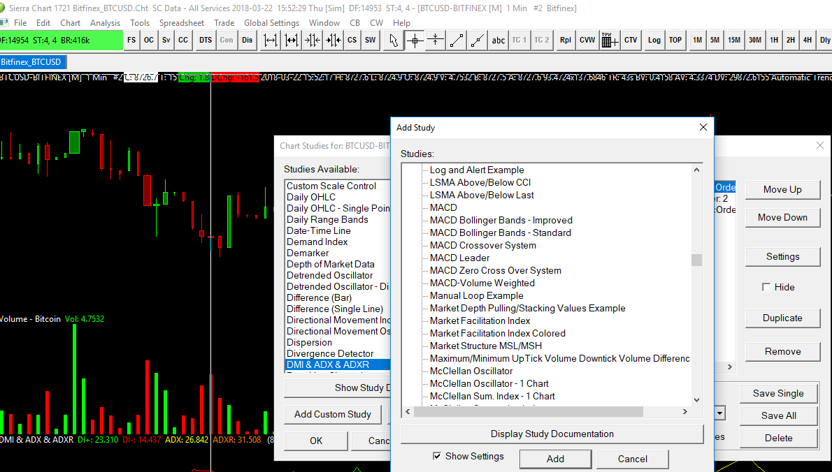

                I confirm that the name is "MACD zero lag", and that I do not see it in the study list anymore, even the one I installed myself. (1721 -32) Tried a remote compil in SC 64bits, same problem. Maybe the support have an idea about this ?  |

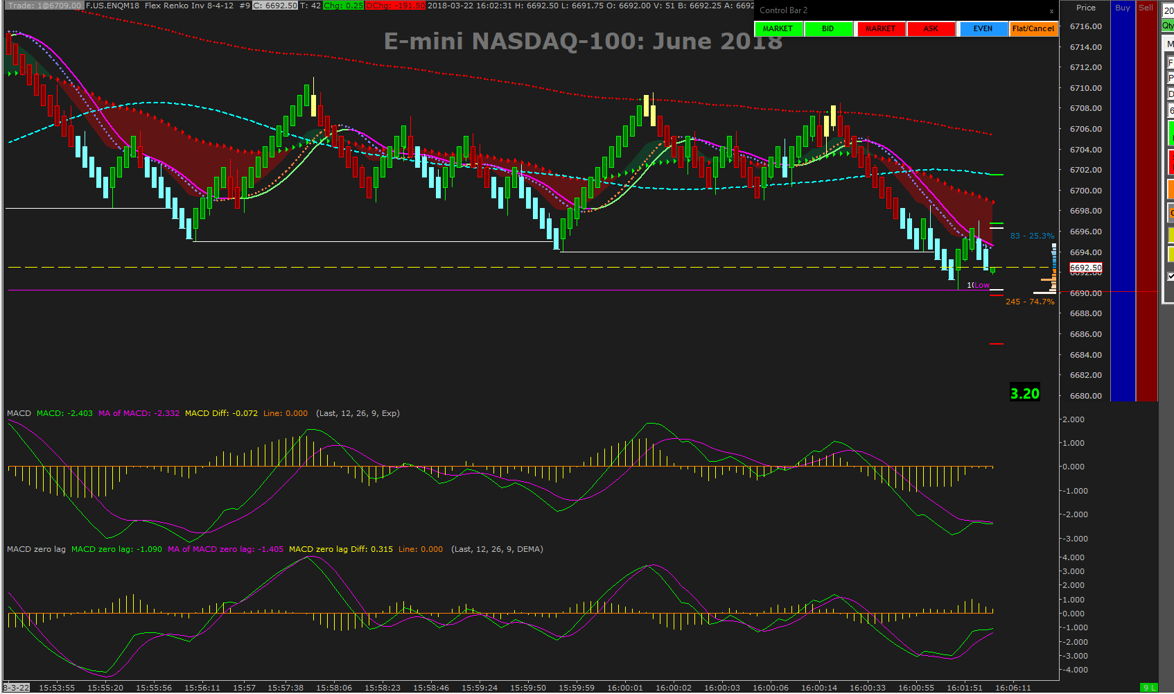

Tried a remote compil in SC 64bits, same problem. Maybe the support have an idea about this ? Worked fine for me, I compiled it and see it on my chart. I've included both your Study and the Standard Study side by side in the chart below if anyone's interested comparing the two. I did add the FreeDLL command to your code as I didn't see that in there. Not sure if that was necessary or not but it's working. I've attached a copy of the 64bit version also. Thanks for writing this and sharing--> Scott  |

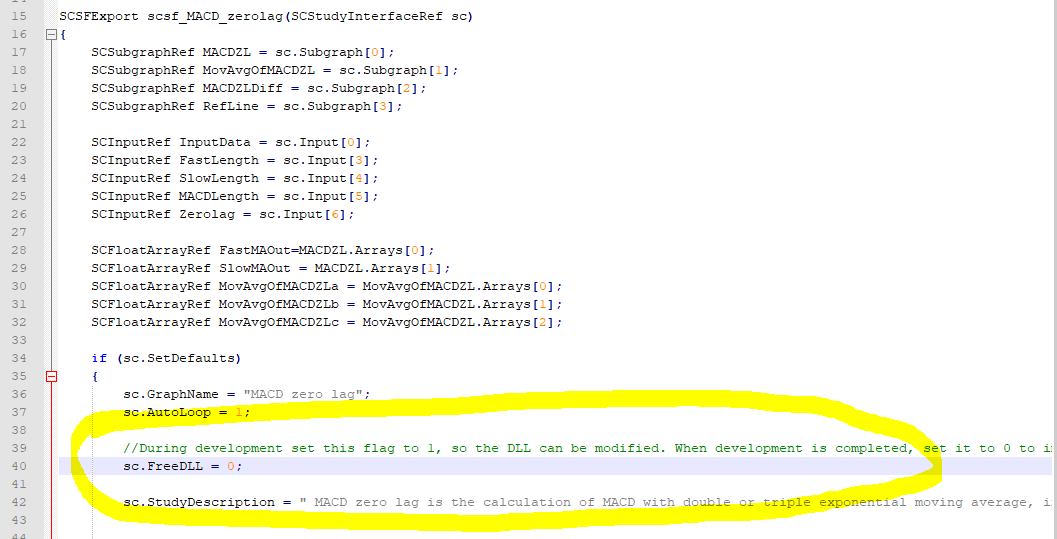

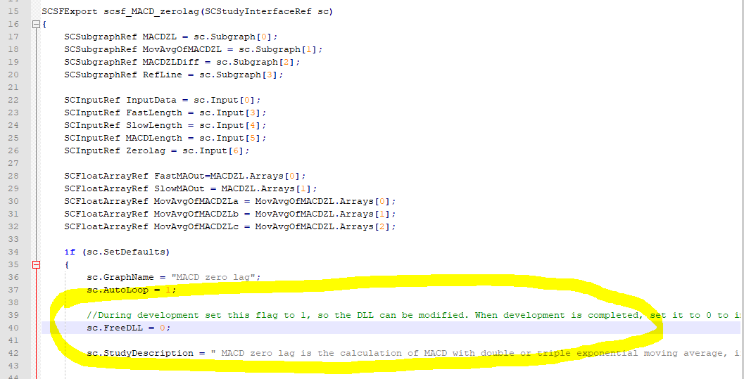

                Hi Scott, Thank you for your comment and efforts. I also compiled it but I don't see it. Where did you add FreeDLL command exactly? Thanks. Ozzy  |
|   [2018-03-22 20:45:20]     |
| Xfanman1 - Posts: 320 |
                Ozzy, see the attached image.  If you need help compiling the 32bit version let me know I can do it for you.  Otherwise I know you said you tried 1722 vur make sure you double check because the Custom DLL's' disappeared in 1721 I think. --Scott P.S., I added the modified .CPP file for you in case that helps. Date Time Of Last Edit: 2018-03-22 20:46:50
|   [2018-03-22 21:25:05]     |
| User952186 - Posts: 58 |
                Thank you! It was due to the version I was using 1721 now upgraded to 1722.  |
