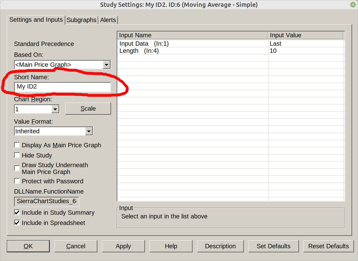

                @raheemrazzak You are welcome, one of the possible option for your case is saving multiple study collections, and define buttons on the tool bar, so that each bar loads different set of study collections For ACSIL, unfortunately, I am not aware of a way to access chronological #, for the time being, this is the solution I am thinking (tested, works): Give each study an unique Short Name (see attached image) with or without space, doesn't matter, just make sure it matches exactly with the name in the code. That means it doesn't matter which order you loaded your studies, you will always be able to identify each one. I loaded Simple Moving Average, and give it a Short Name as "My ID2", the previous code would be modified as below: Then you can do whatever you want, i.e. press "q" to hide/unhide this group of studies, press "a" to hide/unhide that group of studies, etc, quite a work though if you have dozens or hundreds of studies. I will let you know if I would think of a better way to do it. #include "sierrachart.h" SCDLLName("KeyToHide") SCSFExport scsf_KeyToHide(SCStudyInterfaceRef sc) { if (sc.SetDefaults) { sc.GraphName = "Key To Hide"; sc.GraphRegion = 0; sc.AutoLoop = 1; sc.UpdateAlways = 1; sc.ReceiveCharacterEvents = 1; return; } static int VisibilityOfGroup1 {1}; static int VisibilityOfGroup2 {1}; if (sc.CharacterEventCode==113) // "q"uick hide or unhide Group One VisibilityOfGroup1 = !VisibilityOfGroup1; if (VisibilityOfGroup1) { sc.SetStudyVisibilityState(sc.GetStudyIDByName(sc.ChartNumber, "My ID2", 1), 1); //sc.SetStudyVisibilityState(sc.GetStudyIDByName(sc.ChartNumber, "My ID7", 1), 1); //sc.SetStudyVisibilityState(sc.GetStudyIDByName(sc.ChartNumber, "My ID9", 1), 1); } else { sc.SetStudyVisibilityState(sc.GetStudyIDByName(sc.ChartNumber, "My ID2", 1), 0); //sc.SetStudyVisibilityState(sc.GetStudyIDByName(sc.ChartNumber, "My ID7", 1), 0); //sc.SetStudyVisibilityState(sc.GetStudyIDByName(sc.ChartNumber, "My ID9", 1), 0); } } Date Time Of Last Edit: 2023-10-30 04:56:39
