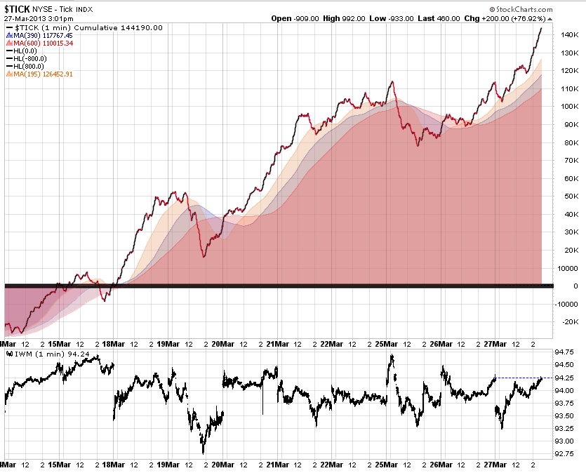

trying to figure out how to construct a simple cumulative tick chart with moving averages. simple 1 minute line graph will do. trying to recreate the chart i have attached. thanks
C:\Users\Matt Barnette\Desktop\MM\2013-03-27_1404cumulative_tick.png
image2013-03-27_1404cumulative_tick.png / V - Attached On 2013-03-27 19:07:54 UTC - Size: 63.94 KB - 1129 views

Look at using the Cumulative Sum of Study:
http://www.sierrachart.com/index.php?l=doc/doc_TechnicalStudiesReference.html#s134
You can then base a Moving Average on the study:
http://www.sierrachart.com/index.php?l=doc/doc_ChartStudies.html#BasedOn
