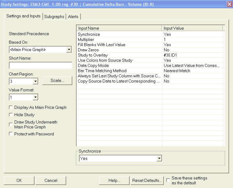

                I usually make a quick change in one of the inputs and the problem is corrected. I'll just do that. I attached an image of the inputs Maybe I am not doing this correctly but I tried to add a second Study/Price Overlay for the Zig Zag but I get only the line but no text. That is why I originally added the Zig Zag to the overlay. Date Time Of Last Edit: 2013-03-27 18:11:09
|   [2013-03-27 18:13:07]     |
                The settings look fine.  We do not have any other suggestions. Also text does not copy over when using the Study/Price Overlay study.
