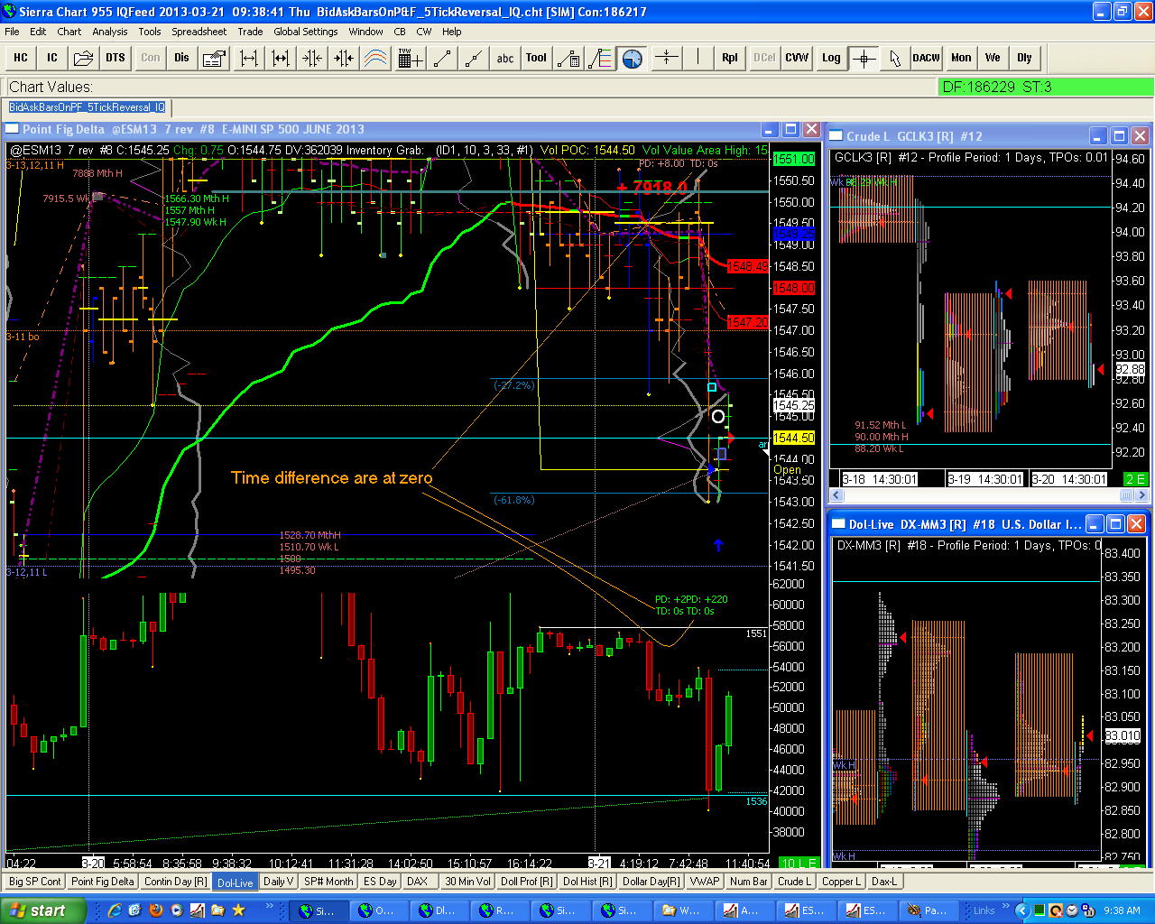

I am using ACSIL to draw the Chart Caculator tool. The "Time Difference" is no longer working. It is displaying zeroes.

[2013-03-25 20:27:48]
WarriorTrader - Posts: 247
Here is a picture
https://www.sierrachart.com/Download.php?Folder=SupportBoard&download=87
WT
image3-21 DeltaLine error.png / V - Attached On 2013-03-25 20:23:20 UTC - Size: 111.99 KB - 1242 views
[2013-03-25 20:42:41]
This really is not clear for us. How many bars does the chart calculator line span?
You need to provide an image with just one very clear line.
[2013-03-26 03:50:36]
The length of the Chart Calculator can vary: Anywhere from a length of 1 to a length of over 100.
You can pick any length you like. It does not matter if it is drawn in the price chart or the delta study, the time difference comes up with zeros.
A manually drawn Chart Calculator works well. It is only a problem within ACSIL. There were no problems in 949. It broke somewhere after 949 or so.
Do you really need another image? Not sure how that will help you.
--WT
