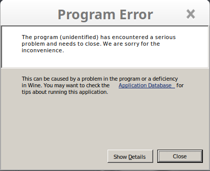

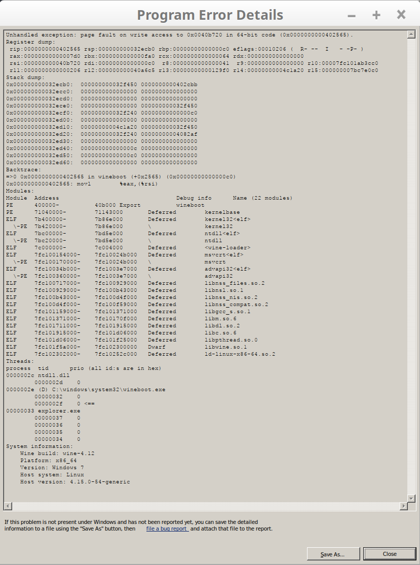

| ticinotrader - Posts: 419 |
                After upgrading to Wine 4.12 when launching Sierra, there is a Wine error window popping up. Then when closing it down, SC opens properly. Anybody experience this problem? Previously it was the Mono Installer/Updater that run automatically first, when starting SC after upgrading wine, so I guess it is related to that and not SC but do not know how to fix it. Date Time Of Last Edit: 2019-07-07 08:50:53

| samual sprat - Posts: 343 |
                I’ve not updated to wine 4.12, still running 4.11. I’ve not seen that before though. I’ll let you know if I have any uses issues after I update Not sure how to do it but have you tried rolling back to 4.11? Btw what version of Sierra are you running? I think they may have introduced OpenGL in 1945 but it was pulled as some folks had issues Date Time Of Last Edit: 2019-07-07 10:15:48

| ganz - Posts: 1048 |
                ticinotrader there is a Wine error window popping up.
https://www.phoronix.com/scan.php?page=news_item&px=Wine-4.12.1-ReleasedAfter upgrading to Wine 4.12
Stable: Wine 4.0.1 https://www.winehq.org/  |
|   [2019-07-07 17:09:13]     |
                Thank you ganz - a quick Wine 4.12.1 update solved the problem. sunnyod: this works fine now with both SC 1941 and 1946.  |
