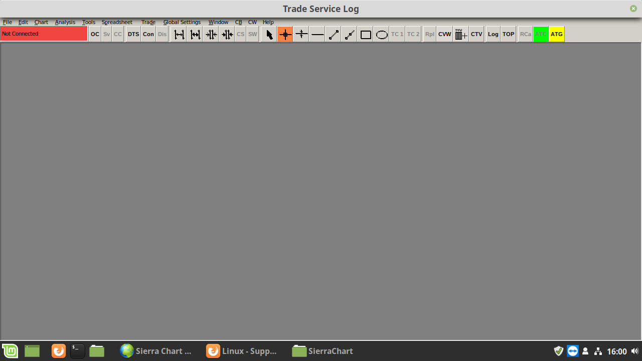

| [2019-07-06 20:04:01] |
| ertrader - Posts: 685 |
In the latest version 1941, when attempting to open the trade service log, SC creates a rectangle bar across the screen at the top rather than opens the log. I've tried Wine 4.0.1 and 4.12 and both have the same issue. There is an X on the right that allows me to close it and it happens without any charts. Not sure which version this started happening. Does anyone know if there is a way to see the trade services log outside of SC? I've looked in the various directories in SC. Ideally, it would be fixed at some point. Date Time Of Last Edit: 2019-07-06 20:05:49
