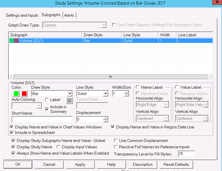

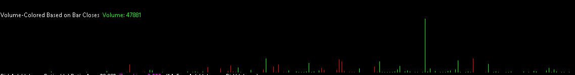

                I would like to make a trading strategy on this indicator. Problem: there is only one SG in the spreadsheet. You can set the time for opening an order - by the magnitude of the indicator, but how to determine the direction of the order in the spreadsheet (the indicator gives a red or green color)?  |

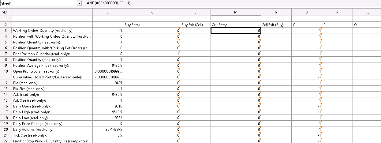

                Is it necessary to register in K3 and M3?
|   [2020-06-24 13:04:14]     |
| ULADZIMIR VALASACH - Posts: 38 |

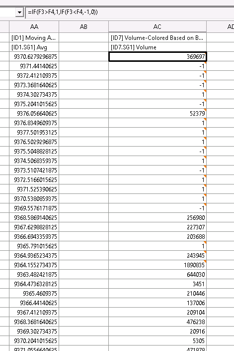

                placed in FS3 - it turns out wrong ...
|   [2020-06-24 13:32:44]     |
| Sawtooth - Posts: 4285 |
                You must use a Formula Column.  If 'Number of Formula Columns' is set to 16 then you can only use columns K-Z. Spreadsheet Study Inputs: Number of Formula Columns If you are using the Spreadsheet System for Trading study, only use columns O-Z because columns K-N are for entry and exit signals. So, for example, put =IF(F3>F4,1,IF(F3<F4,-1,0)) in cell O3, and reference it in your entry formulas in K3/M3.  |
|   [2020-06-24 15:20:54]     |
                Thanks - now the color determines (translates to 1 or -1) !! How to specify the condition for the purchase? = AND ($ AC3> 3,000,000, $ O3> 0)  |
|   [2020-06-24 15:32:15]     |
                Only use commas to separate the AND conditions.  No commas in the 3,000,000 number. =AND(AC3>3000000,O3=1)  |
|   [2020-06-25 06:51:35]     |
                Thank! Set: K3=AND(AC3>3000000,O3=1) M3=AND(AC3>3000000,O3=-1) Opens only buy orders!  |

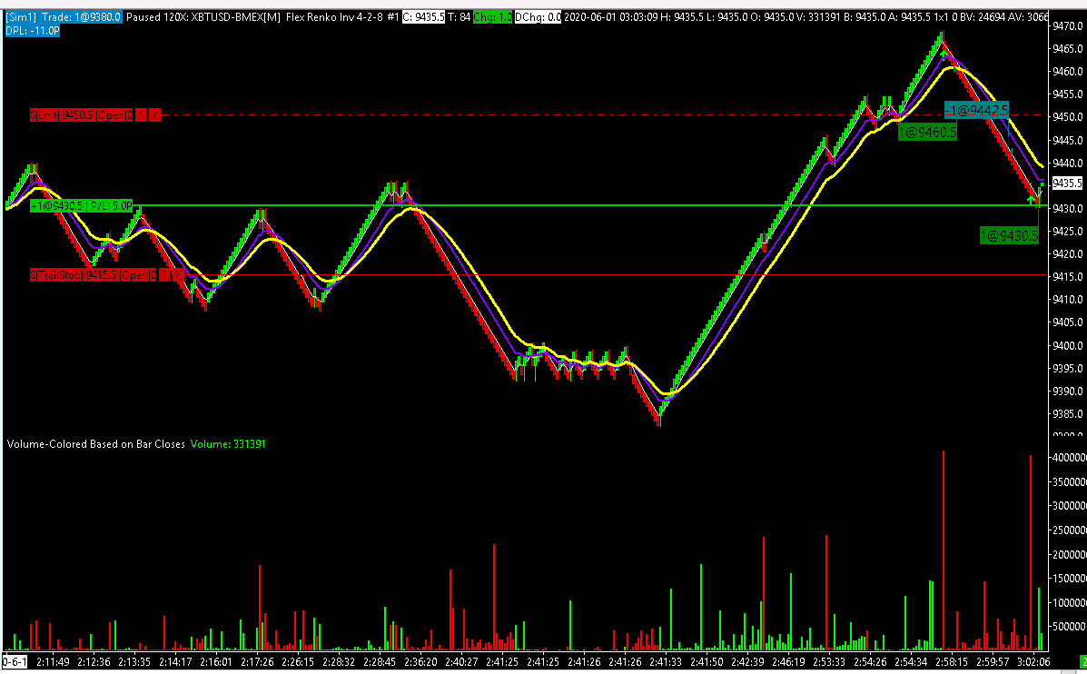

                The formula I offered will only work when using Volume - Colored Based on Volume study, as you put in the title of this thread. Sorry, I didn't notice in the pics that you were instead using the Volume - Colored Based on Bar Closes study. I see that you are also using Renko bars. Apparently the Volume - Colored Based on Bar Closes study is not using Renko open and close values. Try this: 1. Add the Renko Visual Open/Close Values study, and hide the study. 2. Use a formula like this in O3: =IF(AF3>AE3,1,IF(AF3<AE3,-1,O4)) -where the Renko open is in AE3 and the Renko close is in AF3. Edit as needed. 3. Use these formulas in K3/M3: K3: =AND(AC3>3000000,O4=-1,O3=1) M3: =AND(AC3>3000000,O4=1,O3=-1)  |
|   [2020-06-26 06:53:20]     |
                Oh - it's my fault - I mixed up and did not notice! Thank you very much for your help! I will try.  |
