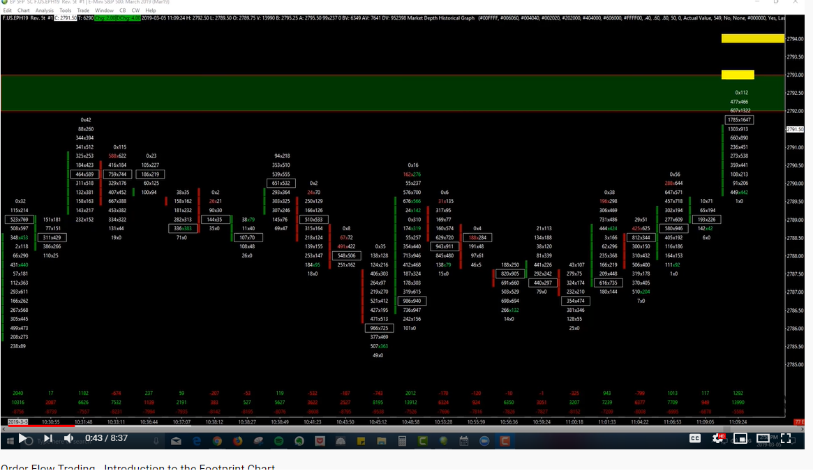

Hi I was wondering how can i set up this type of number chart with the candle outline and the colored numbers.

This is a Numbers Bars study. There are a lot of ways to configure the Numbers Bars study to show various things. We recommend starting with this example Chartbook that has a Numbers Bar study that will give you some ideas to start with. Then just work through the various options to see how they affect things until you find the combination you are looking for.
Here is the link to the chartbook:
https://www.sierrachart.com/AdditionalFiles/NumbersBarsExampleChartbook.cht
Here is the information on how to use the chartbook, in this case start at Step 3:
Chartbooks (Workspaces): Using a Chartbook Provided by Sierra Chart Support
And here is the link to the documentation for the Numbers Bars study:
Numbers Bars
