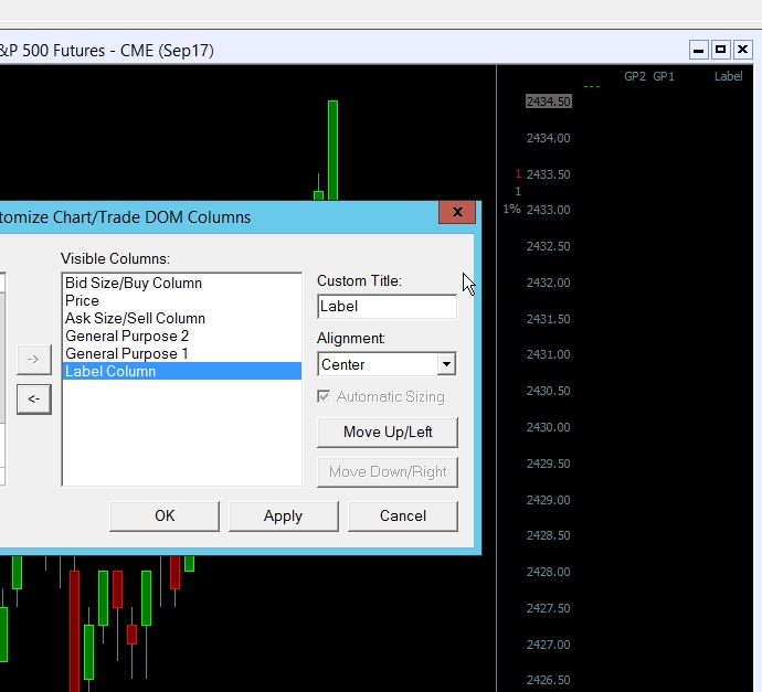

ejtrader - Posts: 688
SC Team - Noticed you have introduced General Purpose Chart DOM columns(Thank you) but are set to "Auto Resize" by default and no option to change them.
Wondering if it is possible to change the width of the column by other means(ACSIL/Chart settings etc).
Edit - Never mind - Found a work around - I could control it by Padding the label as needed.
thanks

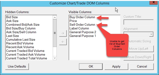

When the Chart market data columns are configured in certain way - the width can not be adjusted using "drag" mode as described in the documentation.
Attached is the sample chartbook (no studies) which demonstrate the issue.
Tried to get rid all possible columns except the general purpose columns. That's when you would notice this issue. Would it be possible to remove buy order / sell order columns and just have the general purpose columns with adjustable width by any means?
thanks
Date Time Of Last Edit: 2017-06-27 13:00:14
attachmentV1_GeneralPurposeColumn.cht - Attached On 2017-06-27 12:49:40 UTC - Size: 21.17 KB - 554 views
imageUnable_to_remove_Buy_Sell_order_columns.jpg / V - Attached On 2017-06-27 13:00:04 UTC - Size: 107.73 KB - 439 views
[2017-06-27 17:28:30]
Regarding feature requests, we cannot accept those now and it would be years before we could look at them.
We will look into the described issue in post #4.
Date Time Of Last Edit: 2017-06-27 17:28:41
[2017-06-27 18:02:21]
Actually Yes. You just need to use Trade >>Show Market Data Columns and do not enable the Chart DOM.
But we need to add support to adjust the columns in this case.
Date Time Of Last Edit: 2017-06-27 18:03:11

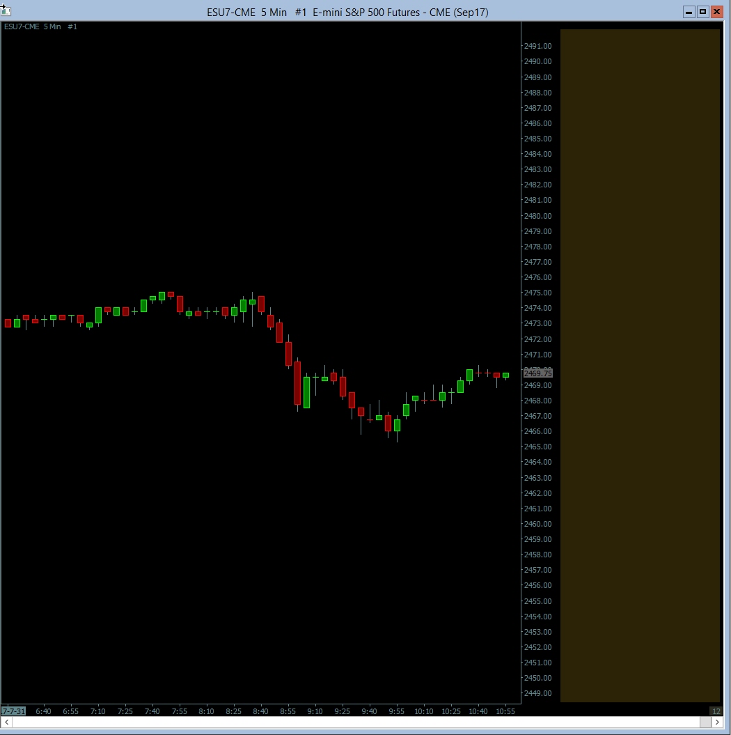

Thank you. No rush on this and you can address this - when you get to work in this functional area. I am using workaround for now.
We can provide the coordinates of the Values Scale and market data columns area as one complete region.
Thank you. In this case - Would you Please provide the co-ordinates for the shaded region as one Complete region(right side of the valuescale as left co-ordinates for the complete region).
thanks
Date Time Of Last Edit: 2017-07-31 16:10:07
imageSC_ValueScale_GeneralPurpose.jpg / V - Attached On 2017-07-31 16:04:18 UTC - Size: 138.96 KB - 406 views
[2017-08-15 03:50:24]
SC Team - Noticed you have introduced 2 new functions related to the co-ordinates for the price scale.
sc.RightValuesScaleLeftCoordinate -- I think this value is always likely to be sc.StudyRegionRightCoordinate. It would have been nice to provide the left/right co-ordinates for the shaded rectangle area as marked in the above picture instead.
sc.RightValuesScaleRightCoordinate -- this is indirectly the right co-ordinates of the full window as well. There is no need for this as well in current state.
So - if you could just provide the value of the right co-ordinates of the Valuescale - That should be good enough. If it is not much of a development effort - please see if you could provide this. if not - no worries as I would continue to use the work around ( though it's tedious).
