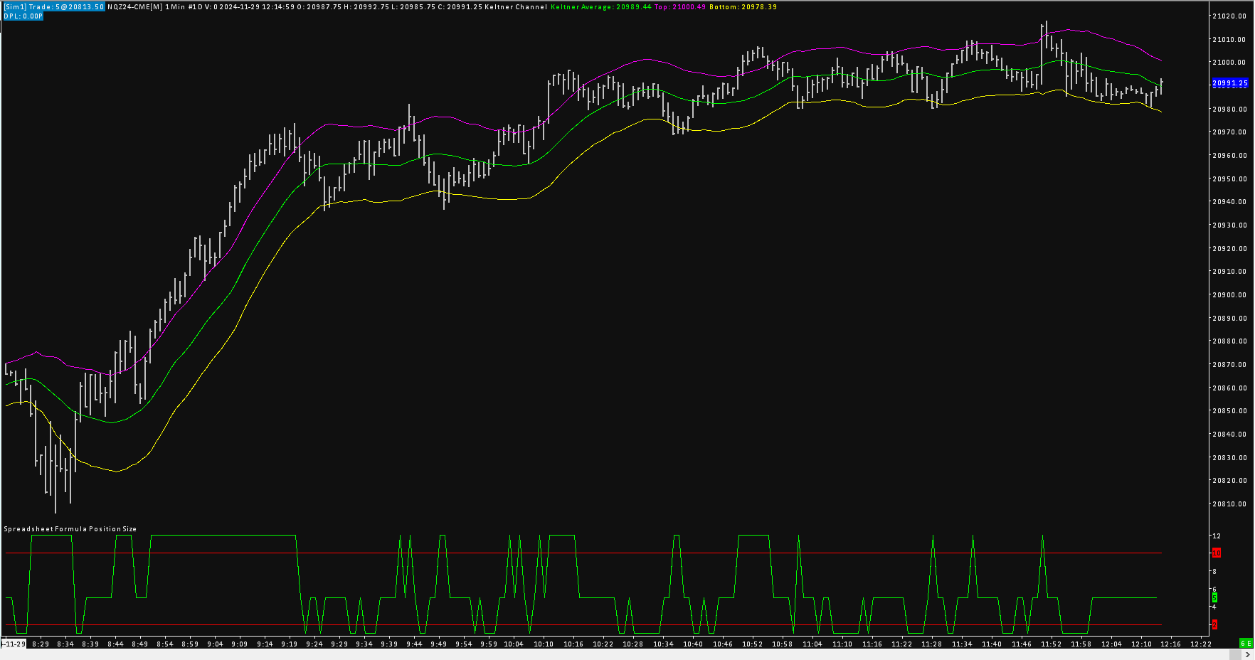

Zip file has source and compiled study.
Study sets sc.TradeWindowOrderQuantity based on formula result.
Calculated position size is output to subgraph.
Min/Max position size constraints (set in the study) are output to subgraph.
Example chart used for testing attached, see also image.
attachmentSpreadsheetFormulaPositionSize.Cht - Attached On 2024-12-01 11:10:13 UTC - Size: 4.09 KB - 338 views
imageSpreadsheetFormulaPositionSize.png / V - Attached On 2024-12-01 11:10:19 UTC - Size: 59.81 KB - 218 views

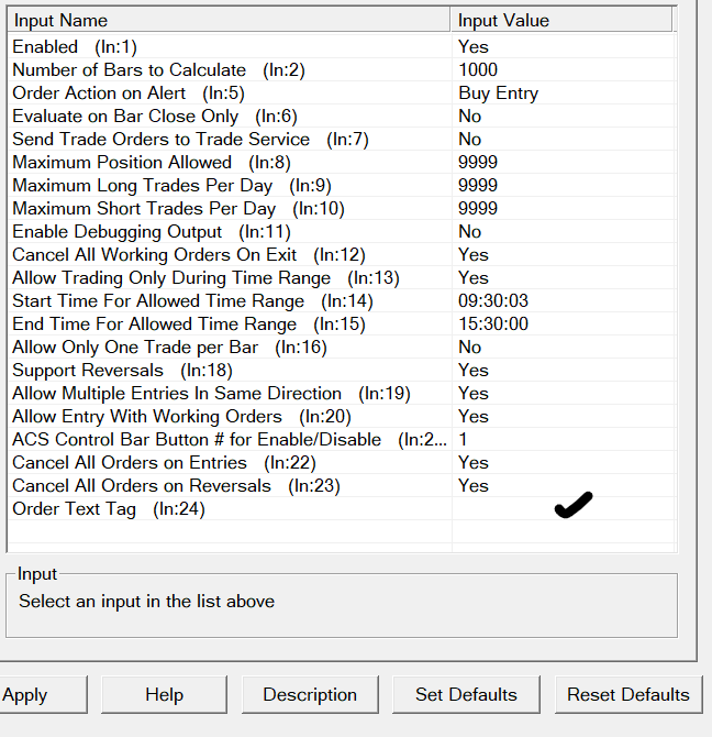

Thinking further, what I really need is a automatic setting of "Order Text Tag Ln:24" field in the SC delivered "trading system based on alert condition" study. Please see screenshot attached. Is this possible? I can manually enter the study collection name in the "tag text" field available in trade ticket>Set" tab. I want this to be automatically set to study collection name (whichever collection I am using on the chart). p.s. this is mostly to tie my 100+ SIM accounts to easily reference the version of collection I used (instead of manually maintaining this collection/sim account mapping in excel)
