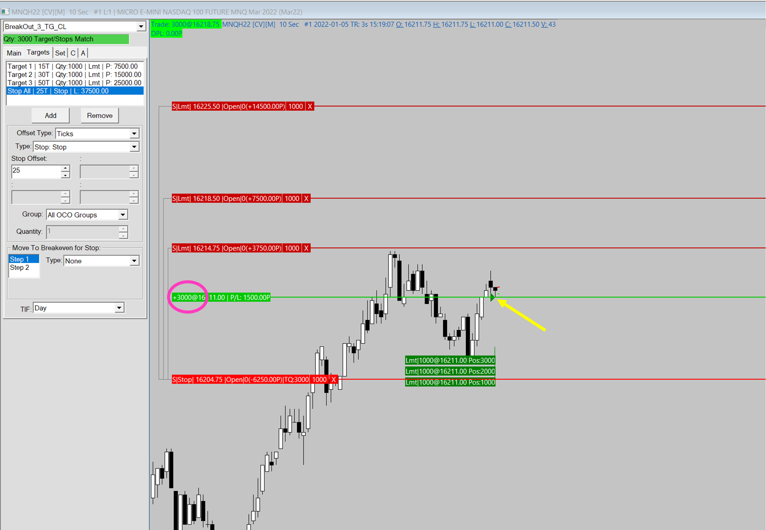

Example No1:
Service: TradingEvaluator (RealTime)
OrderManagement: SC Built-In Tools (No custom code, out-of-the-box OCO orders)
Symbol: MNQH22
Entry: LMT
Quantity: 3000
Question: If partial fills and related OCO-s are implemented and this environment simulates trading as if you were connected to a live trading account how can a spike of a 10second bar fill 3000 MNQ contracts?
It is definitely not the same as being connected to a live account.
Notes:
Using Replay Mode the problem is the very same (using “Calculate At Every Tick/Trade”)
Using Custom code is the very same, too. The example above (see attached pictures) deliberately uses SC built-in tools to avoid and exclude coding errors.

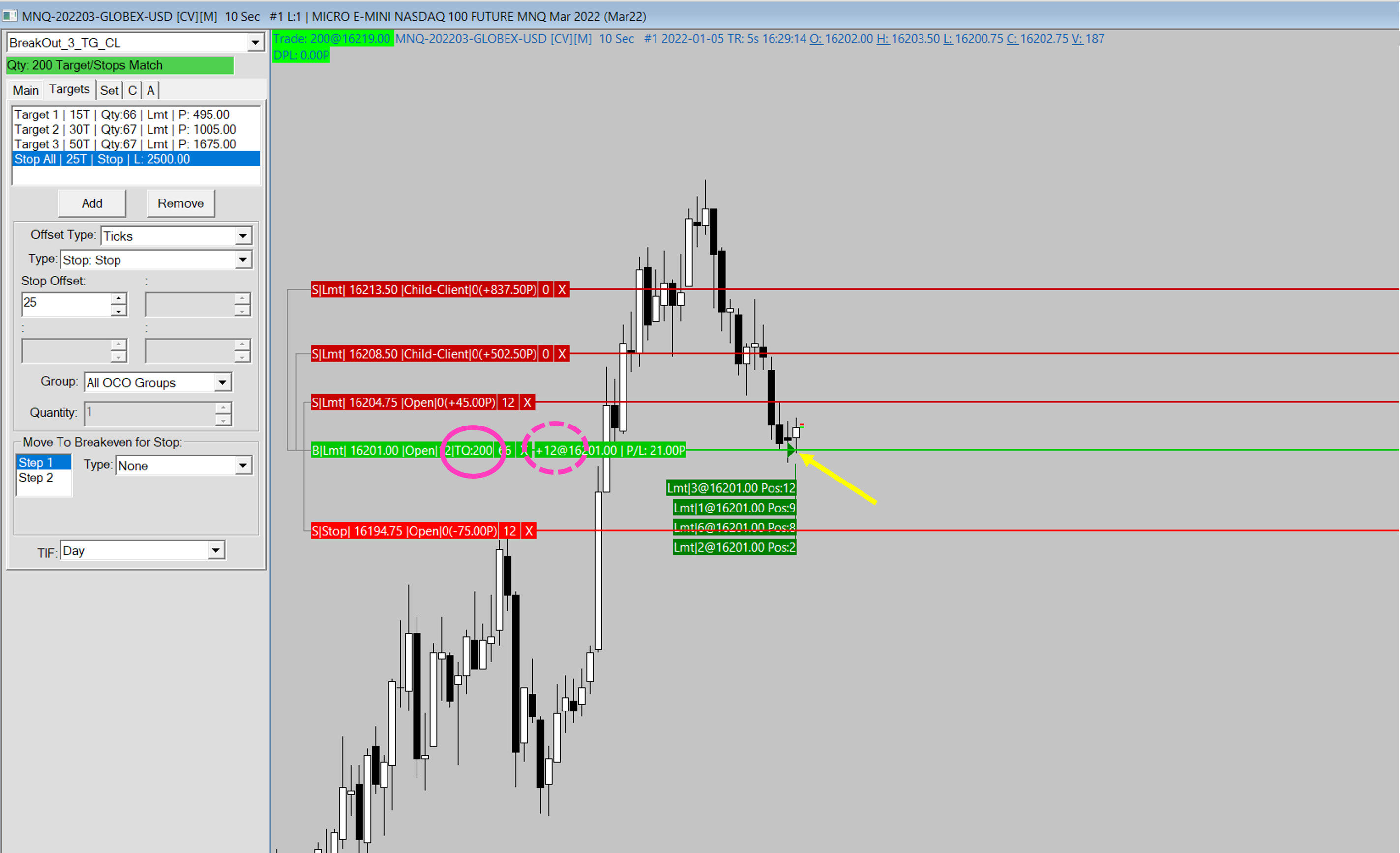

Example No2:
Service: InteractiveBrokers (RealTime)
Symbol: MNQ-202203-GLOBEX-USD
Entry: LMT
Quantity: 200, Partially filled 12
Being connected a live account it is the situation.
LMT orders often fill partially
Question: Where and exactly what shall I set (Replay, Evaluator, Service, any other) to get exactly the same behavior as if I were in live trading?
Any help highly appreciated.
imageEvaluation_3000contr.PNG / V - Attached On 2022-01-05 16:55:10 UTC - Size: 470.42 KB - 280 views
imageRealTime_PartialFill.PNG / V - Attached On 2022-01-05 16:55:20 UTC - Size: 617.7 KB - 324 views
