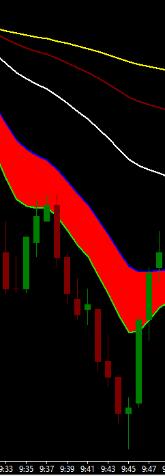

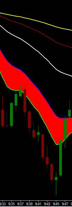

[2021-07-13 16:55:07]
User628616 - Posts: 132
May you help me word this Alert I can't figure it out.
I'm trying to have create a Alert when my Moving Averages(200/100/50/20/8) are stacked in numerical order either High to Low or vice versa.
So when the 200(Yellow) is above the 100(Red) which is above the 50(White) which is above the 20(Blue) that is above the 8(Green) I want an Alert to go off and the same when
8 is above the 20 that is above the 50 that is above the 100 which is above the 200.
Thank you
imageCapturePB.PNG / V - Attached On 2021-07-13 16:50:28 UTC - Size: 11.91 KB - 327 views
imageCapturePB2.PNG / V - Attached On 2021-07-13 16:50:34 UTC - Size: 11.94 KB - 310 views
[2021-07-13 17:07:30]
You would need an alert that looks like the following:
=OR(AND(ID1.SG1 > ID2.SG1, ID2.SG1 > ID3.SG1, ID3.SG1 > ID4.SG1, ID4.SG1 > ID5.SG1), AND(ID5.SG1 > ID4.SG1, ID4.SG1 > ID3.SG1, ...))
Where ID1 is your 200 MA, ID2 is your 100 MA, etc.

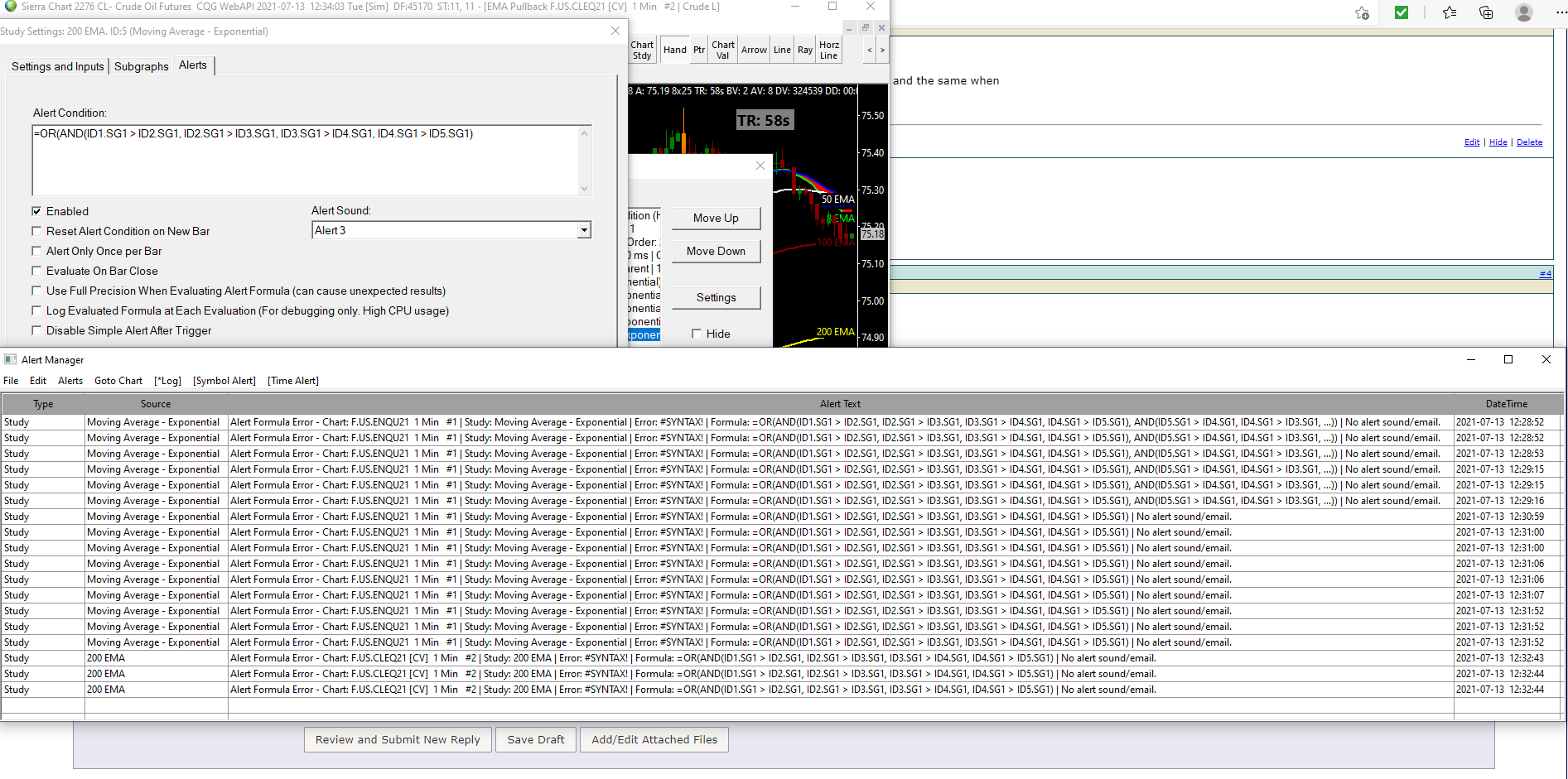

I placed in the 200 EMA Settings:Alerts section, and this pops up when I press apply/ok
imageErrorfix.PNG / V - Attached On 2021-07-13 17:34:32 UTC - Size: 156.03 KB - 368 views
[2021-07-13 18:13:27]
You need to change the IDs to match the IDs of your specific moving average studies. Refer to the information here:
Study/Chart Alerts And Scanning: Referencing Other Studies on the Chart
