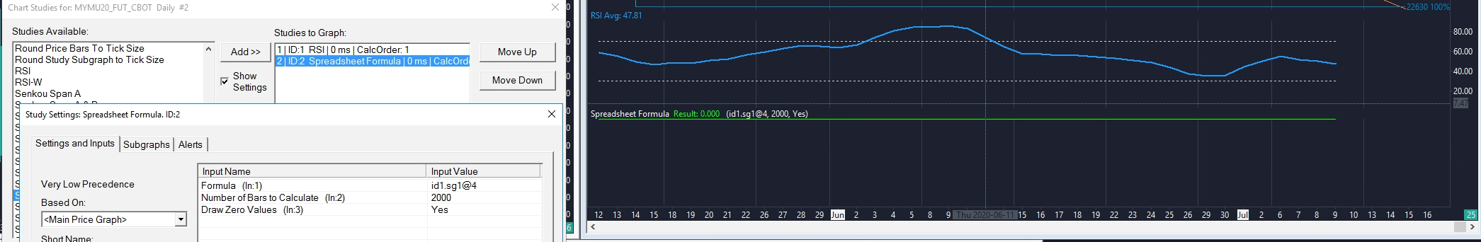

This seems like it should be simple. I'm trying to get yesterday's value on study ID1 to be printed in a spreadsheet formula. What is the index syntax?
I'm trying ID1.SG1@1 but this is probably not correct.

Sawtooth - Posts: 4355
The current bar is in row 3, and previous bars are in rows below.
So on a Daily chart, yesterday's value would be in row 4:
=ID1.SG1@4

Thanks, Tom. I tried this but it keeps giving me a 0 value. I can put in ID1.SG1 and it provides todays value fine.
Maybe I'm approaching this the wrong way (I attached a picture), I'm looking to make the ID2 study lag the ID1 study by 1 day.
imageScreen Shot 2020-07-09 at 7.52.39 PM.png / V - Attached On 2020-07-10 02:53:24 UTC - Size: 313.33 KB - 351 views
You are using the Spreadsheet Formula study, which has nothing to do with spreadsheets, despite its name.
The syntax is different.
You this formula:
=ID1.SG1[-1]

User790545 - Posts: 41
Thanks, that worked! Is there a reference available for what you suggested?
[2020-07-10 05:01:40]
Study/Chart Alerts And Scanning: Alert Condition Formula Format
