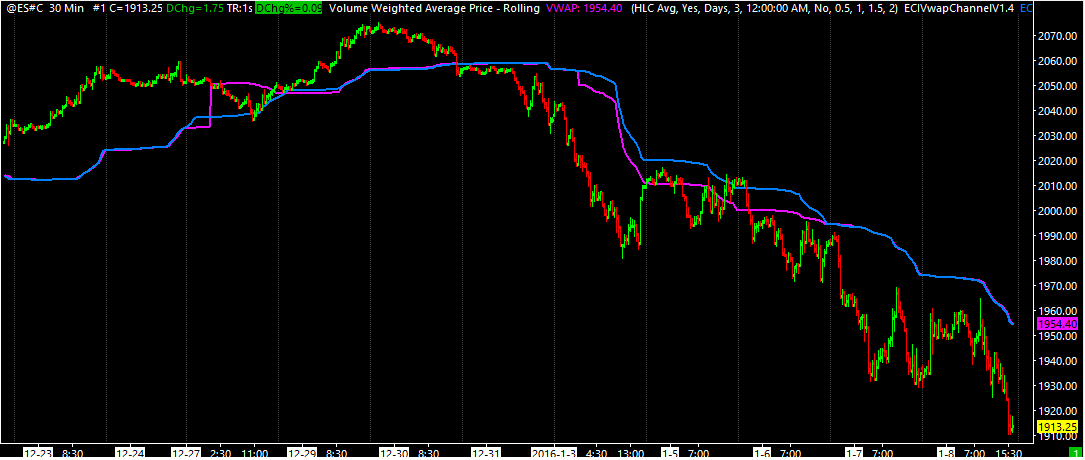

does the rolling vwap study exclude periods of no trading? i.e. holidays
the output of the study around the xmas and new years holidays seems to be calculating incorrectly and including the dec25 and jan1 calendar days into the calculations.

note the jump in the pink line on the 27th of december
pink line is built in vwap-rolling study
blue line is ECIVwapChannel in user contributed studies
Yes those days would be included in the calculation even if there was no trading/data. The code does skip Saturday and Sunday. But overall the logic of how this is implemented is not really the best. We will have a look at this.
