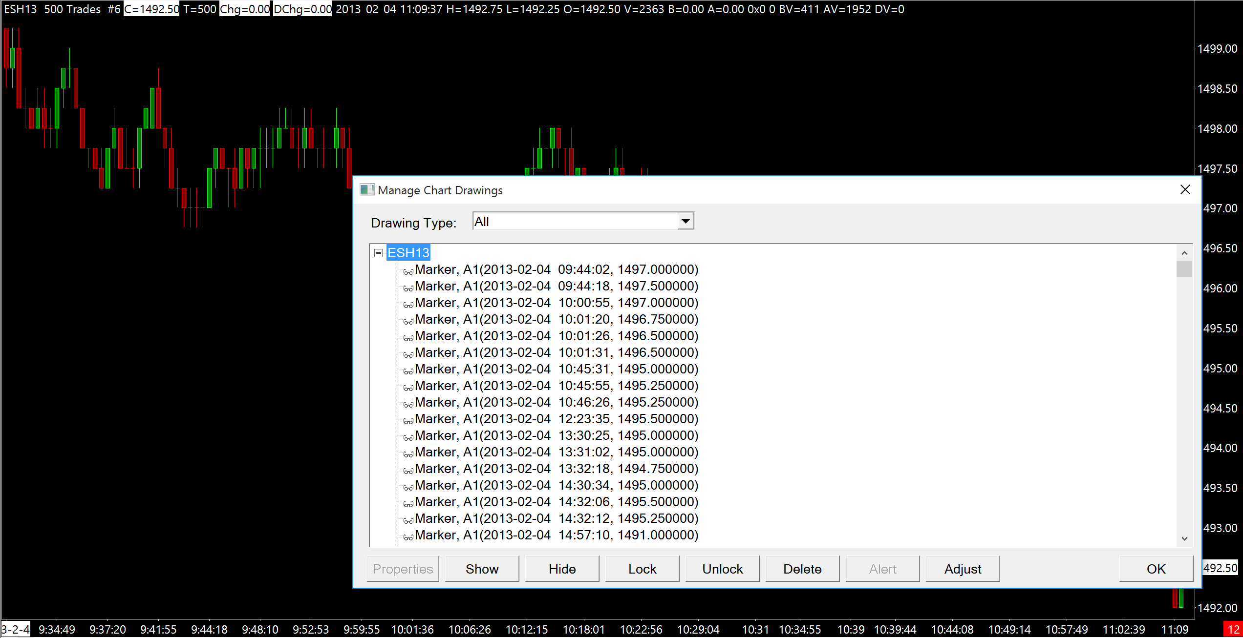

I am attempting to plot a marker on a reference chart and the drawings are being registered in the "Manage Chart Drawings Window" but don't appear visible in my chart. Below is the code I am using and an attachment showing the chart drawings that are registered:

Can someone please let me know where I am going wrong? I suspect a default setting is missing or something but haven't been able to figure out what.
imageRefernceMarkers.PNG / V - Attached On 2015-08-16 07:39:51 UTC - Size: 145.8 KB - 485 views
