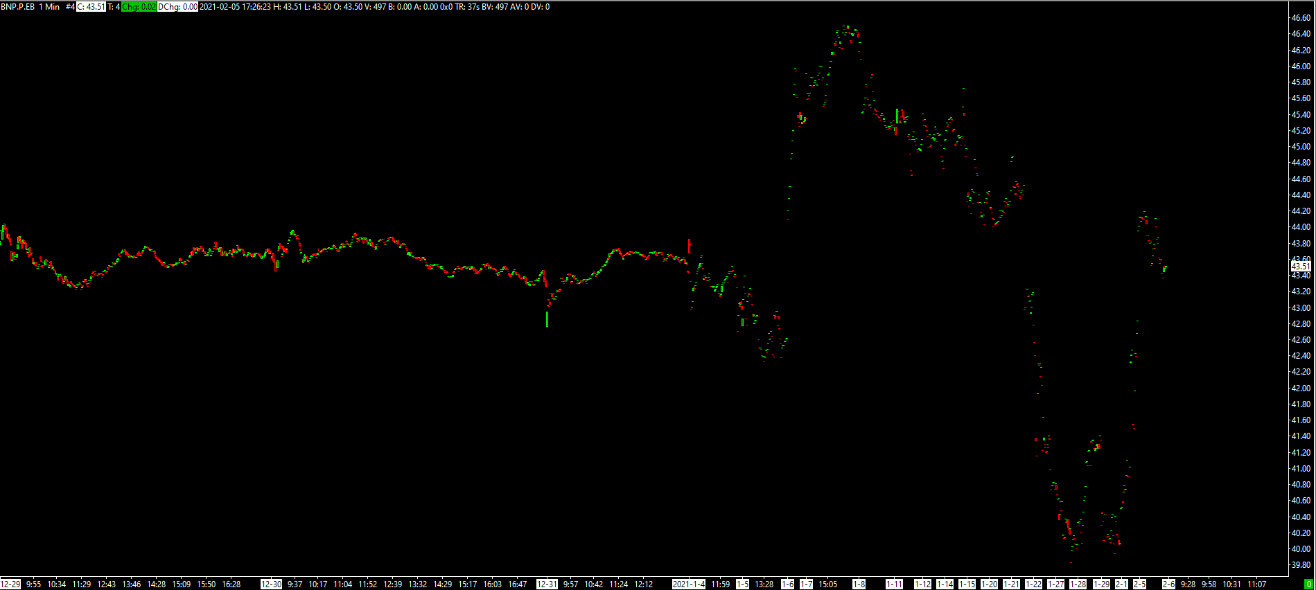

Since the end of teletrader we've planned to migrate to CBOE Europe before the end of the month.
But I just looked again and the data I had in december are clearly different.
Is this because i need to upgrade some of my options or is this a change on the sierra chart side ?
Please see the screenshot attached. You can clearly see the difference since january.
If this is your new CBOE data do you have any other options. I read somewhere that you are going to release EURONEXT any time soon, do you have more information on this ?

[2021-02-08 12:48:29]
We have to ask our data provider, Barchart, about this. We did not change anything on our side.
We do have a Euronext delayed feed which is available now. You should have access to it. You can search for the symbols through File >> Find Symbol >> Stocks>> Euronext Equities.
Date Time Of Last Edit: 2021-02-08 12:48:46

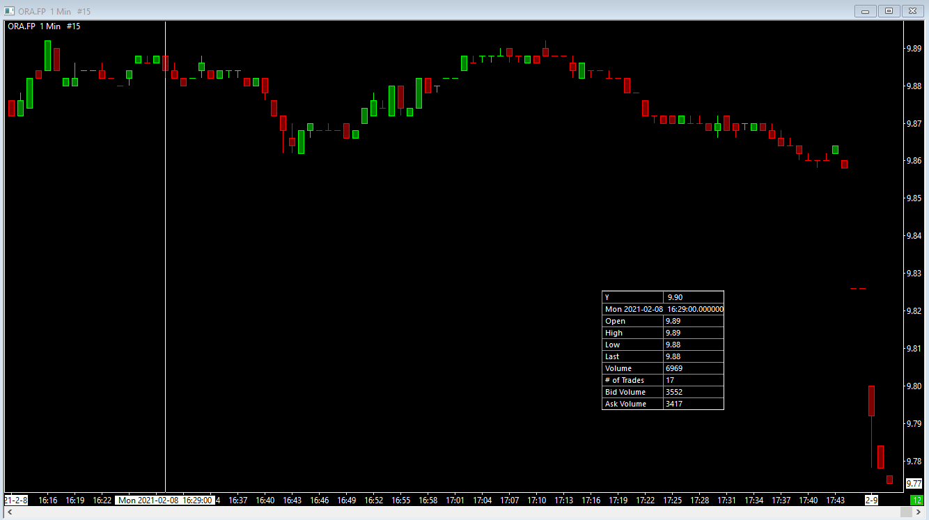

[2021-02-19 09:46:51]
User612903 - Posts: 51
Hello again,
I come back with my problem of timestamp, since it's a bigger problem than expected.
I confirm that in Sierra Chart, the market is open from 9.15 to 5.45 (instead of 9.00 to 5.30).
For little timeframes like 1 minute, I can adjust on my end, but for bigger timeframe (1 hour, 4 hours), the shape of the candlestick is wrong and I cannot fix it on my side. (since 15 minutes goes into the wrong candlestick).
Do you think Barchart will be willing to correct this ?
Regards,
