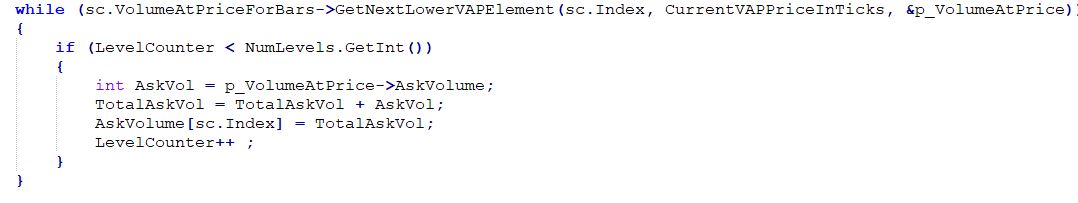

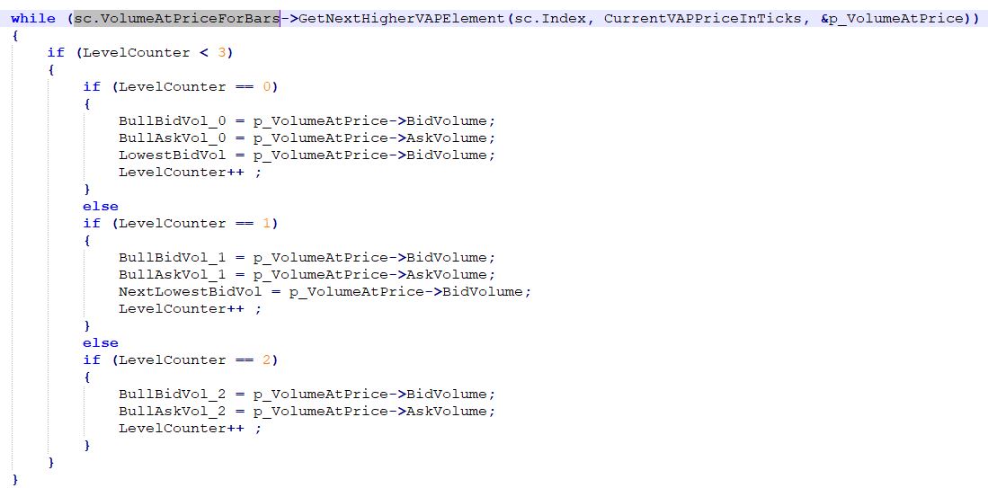

Quick question.... For most of my VAP calculations iterating from the high/low price works fine and because I mostly use fixed range bar types it is easy to specify levels I want to analyze/compare...
But what if I want to quickly specify that I want the bid/ask data from the level or 2 just above the current price... without knowing how many levels are in the bar AND without having to iterate with code to check if sc.Last == VAPlevel1, VAPlevel2, etc.... Basically is there any examples of code for getting VAPElement sc.Last+1
until now all of my code has iterated through the VAP like in the picture attached... but I've always needed to specify the exact level by H/L +/- ticks
Or is it possible to... iterate through the VAP levels using sc.Close as the starting point and iterate up and down from there... instead of starting at the H/L of the bar?

[2019-09-17 13:37:21]
These functions are probably not documented but they are available:
    bool GetVAPElementAtIndex
      ( const unsigned int BarIndex
      , int VAPDataIndex
      , t_VolumeAtPrice** p_VAP
      , bool ReturnErrorOutOnOfBounds = false
      ) const;
    (const unsigned int BarIndex
      , int VAPDataIndex
      , const t_VolumeAtPrice** p_VAP
    ) const;
    const t_VolumeAtPrice& GetVAPElementAtPrice
      , const int PriceInTicks
      ) const;
[2019-09-19 03:41:15]
Actually these functions are documented here:
ACSIL Interface Members - Variables and Arrays: sc.VolumeAtPriceForBars
