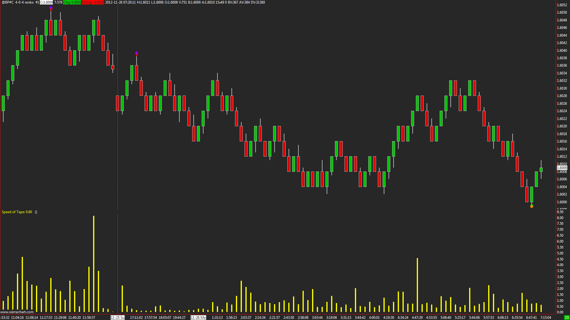

Basically this is an indicator that measures the speed at which orders are filled. Here's a description from the original thread about this indicator (link at bottom).
In most markets and certainly in the equity index futures markets there is a small set of very big traders whose entries into the market often have an immediate and very tradeable impact on price.
These traders go to great lengths to disquise their trade - they have automated routines to send a series of small transactions to the market at intervals close to 1000th of a second.
Because many of these traders operate from price based models they must get their execution within a very narrow price/time range which means they must execute as much of the volume they want as fast as they can while price is in that range. This results in a huge spike in what we call the intensity of trade.
See the bottom study on this image:
[img]http://www.tradepointtechnologies.com/postpics/tradeintensity2.jpg[/img]
Note the time at the bottom. That entire chart is for about one minute of data.
These spikes often signal reversals:
[img]http://www.tradepointtechnologies.com/postpics/tradeintensity1.jpg[/img]
Something similar called "Pace of Tape" is available for NinjaTrader. The code can be found on this page and is pretty short:

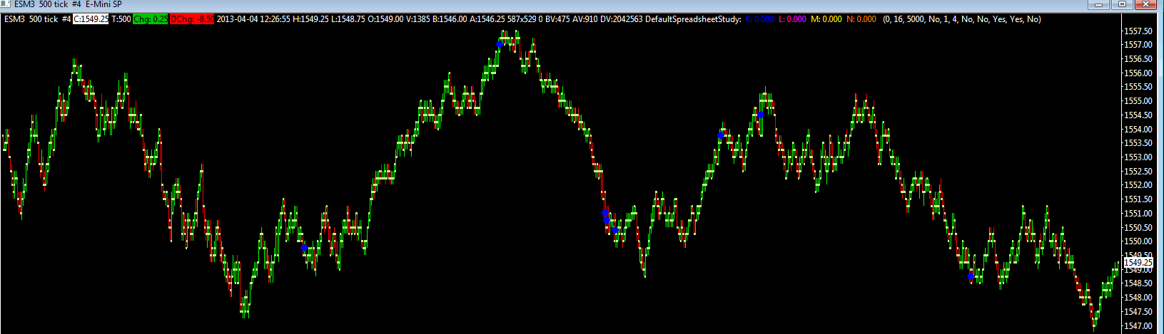

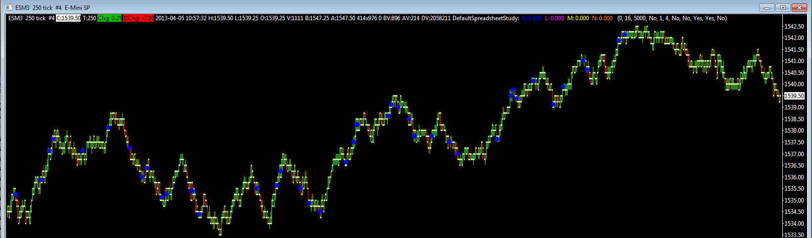

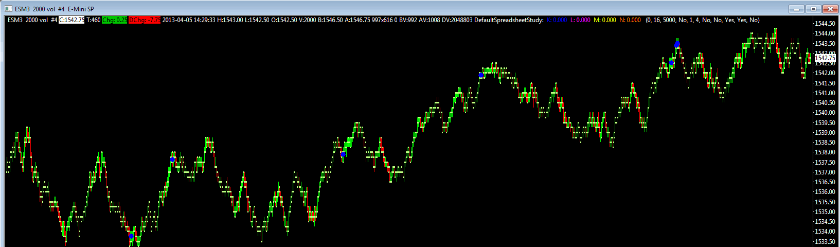

[2013-04-05 19:50:51]
pe1111112 - Posts: 35
Here's the best I could come up with. The speed seems to be limited to the value I mentioned above which means below a certain bar threshold you'll get more signals than you want since SierraChart isn't able to calculate units of time less than what I believe is one second (represented by 0.0000115740695036948 in the spreadsheets).
You can see the attached 250 tick chart starts to show too many signals, and any faster chart (meaning less than 250 ticks) is going to show even more unless we can use a lower value than 1 second.
imagepace of tape 500 tick es.gif / V - Attached On 2013-04-05 19:49:51 UTC - Size: 31.21 KB - 4403 views
imagepace of tape 2000 volume es.gif / V - Attached On 2013-04-05 19:49:56 UTC - Size: 30.68 KB - 3529 views
imagepace of tape 250 tick es.gif / V - Attached On 2013-04-05 19:50:00 UTC - Size: 29.55 KB - 3014 views

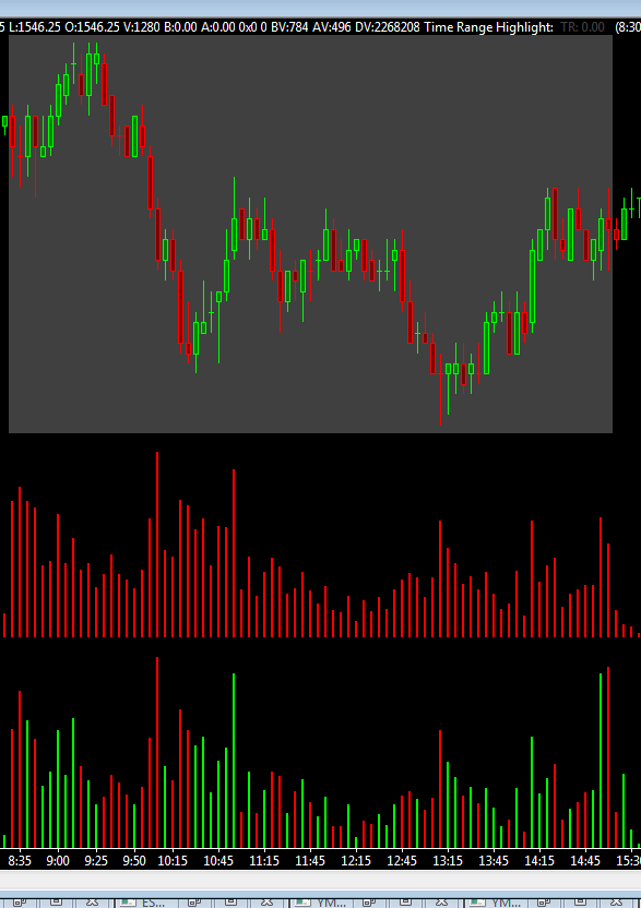

[2013-04-07 19:26:59]
Cool, thanks. What exactly is that "speed of tape" study measuring? I noticed the histogram is almost exactly the same as the volume histogram on a 5 min chart.
edit - it seems if the time on a bar is 0 seconds, the speed of tape indicator returns a value of zero, too. This value should be a spike instead since it means the orders were coming so fast that the bar took less than 1 second to form.
Date Time Of Last Edit: 2013-04-07 19:46:59

[2013-04-07 19:59:27]
Sawtooth - Posts: 4355
My suggestion at the link in post#2 was only an attempt to emulate the pic of the original poster. It only measures the # of trades per bar, then applies an MA to it to create a threshold for an alert/color. Admittedly, it's not very sophisticated.
There is a close (but not exact) correlation between volume and # of trades, so histograms of each will look similar.

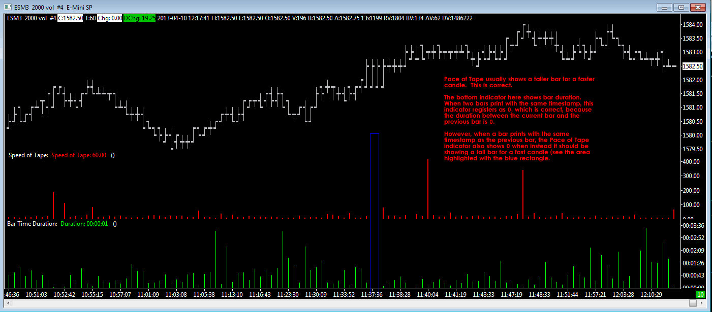

[2013-04-10 17:22:53]
I've attached an image showing the problem with the Pace of Tape indicator.
Pace of Tape shows taller bars for faster candles.
This works correctly unless the time of a candle is 0 in which case Pace of Tape shows no bar when it should actually be showing the tallest bar possible.
imagepace of tape vs bar time duration.gif / V - Attached On 2013-04-10 17:22:26 UTC - Size: 40.36 KB - 4074 views
[2013-04-11 05:01:30]
ganz - Posts: 1048
hi
Bar Time Duration = Last Time of a Current Bar - Last Time of a Previous Bar
I've got no an idea to segregate bars/ticks w the same /1sec/ time stamp as was mentioned above
The time differential of these bars will be always zero and SoT will paint it as zero.
So the study has just a kind of indication of the situation.
gd lck
